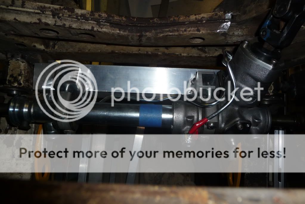

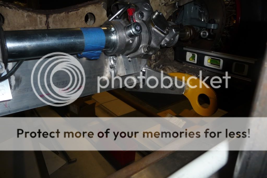

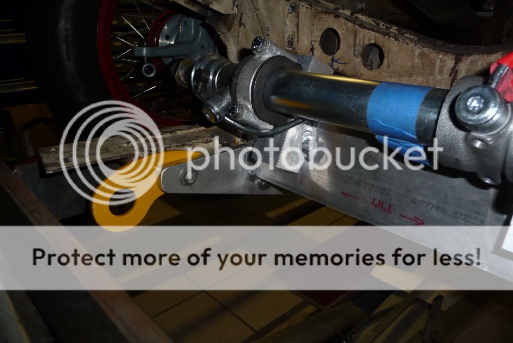

Slow getting thing sorted out, got a surprise with the mustang tie rod ends, there tale than expected so than the steering rack need to be height adjustable.

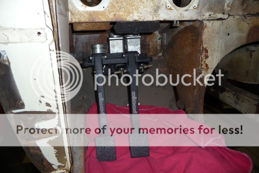

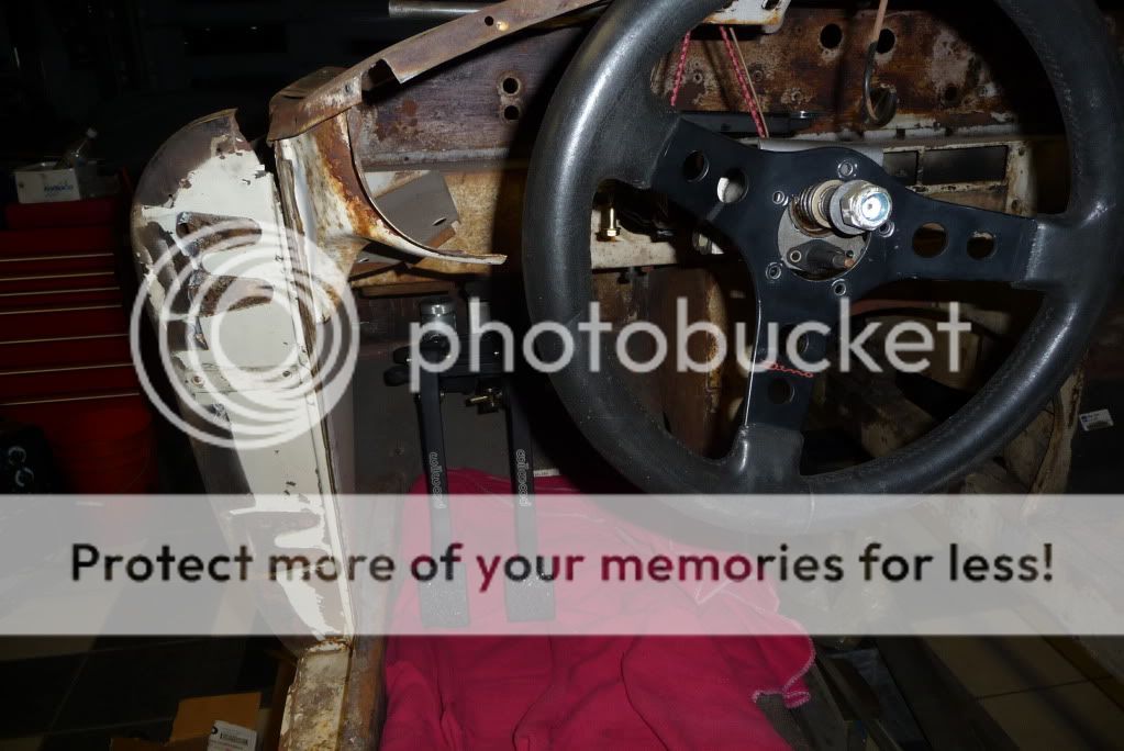

Looks great Udo! Are the Wilwood pedals mounted yet? They look really low in the picture, but maybe they aren't bolted up in the pictures.

But the cutting and fiddling is the most fun on the whole swap. The pedals are just lying in the foot well, steering column is just strapped in to see where it should go.
This is entertainment for me, and a strait swap tacks only a little work. I like the challenge.
The Motor is a 3.6 M5 with supercharger and all the other stuff.
400 + HP is a must for this build.
Mr.JAJA
