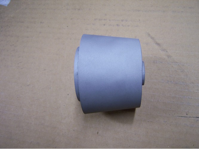

I have recently bought an older Nardi steering wheel on Ebay. Mine was missing the plunger that makes contact between the horn button and the brass ring. Does anyone know of a source for one? I have beadblasted the hub to have it powdercoated, here's a picture:

On my car, the brass ring was already in the steering column for the existing steering wheel. I needed the plunger that makes contact between the horn button and the brass ring. I bought a Grant steering adapter kit for a Chevy truck from Summit for about $20. I used the plunger, and modified the metal hold down to fit inside my adapter. I had to drill out the hole slightly for the plunger to fit. Works great.
