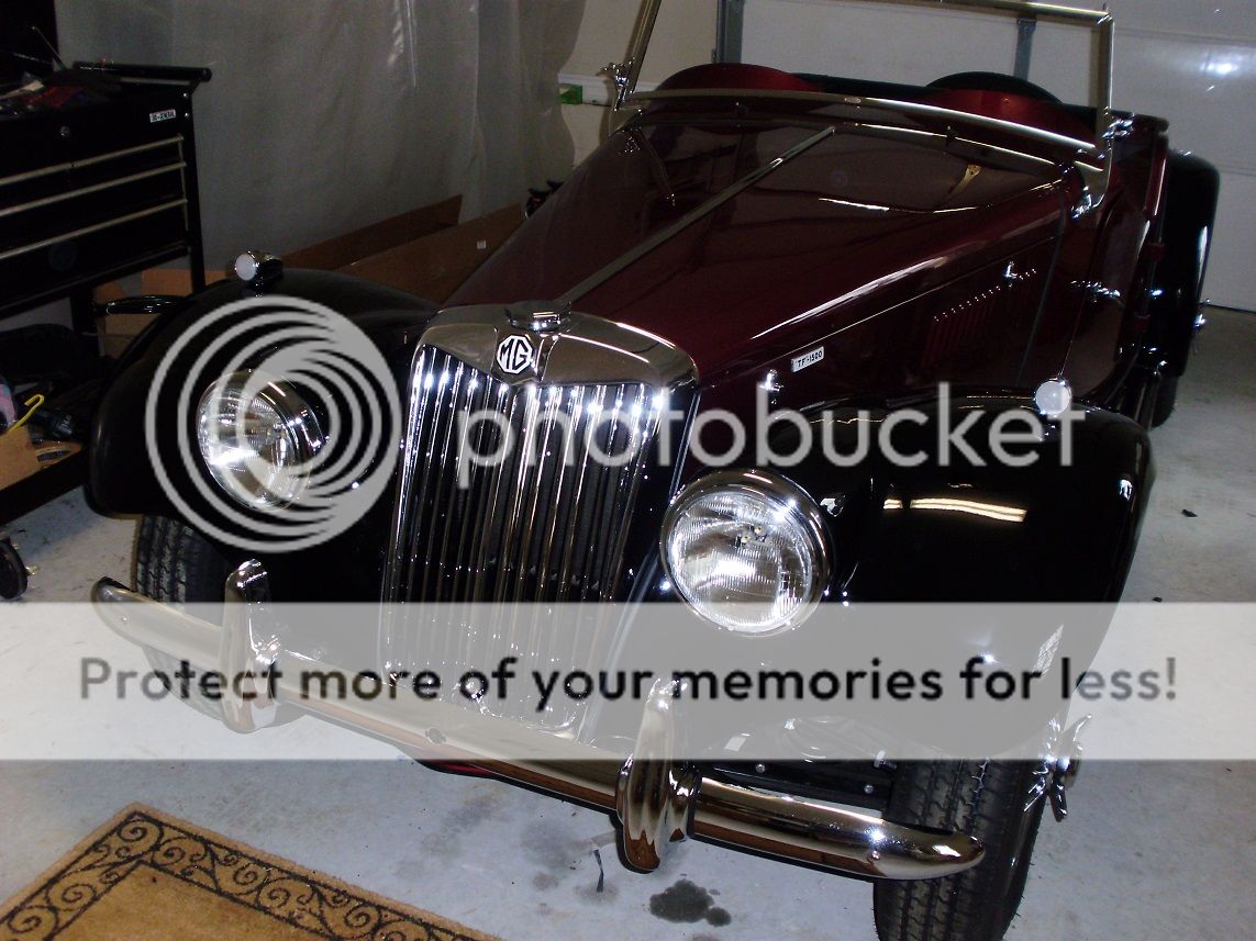

Well, here's where Im at now. Adjusting windshield frame for proper fit. All rechromed. No glass in it until it's right. Right door latch is giving me fits trying to get it to latch properly, very frustrating, but I'll win in the end! :encouragement: PJ

Jet Black. It can a little confusing at times due to the reflections it picks up, but it's the darkest Black the shop could get. Same as the Jag Regency Red, it has some pearl in it and light affects the color quite a bit. PJ
In some of your pictures it looks like black cherry. Of course to some, it may look black and blue or gold and white! :D LOL

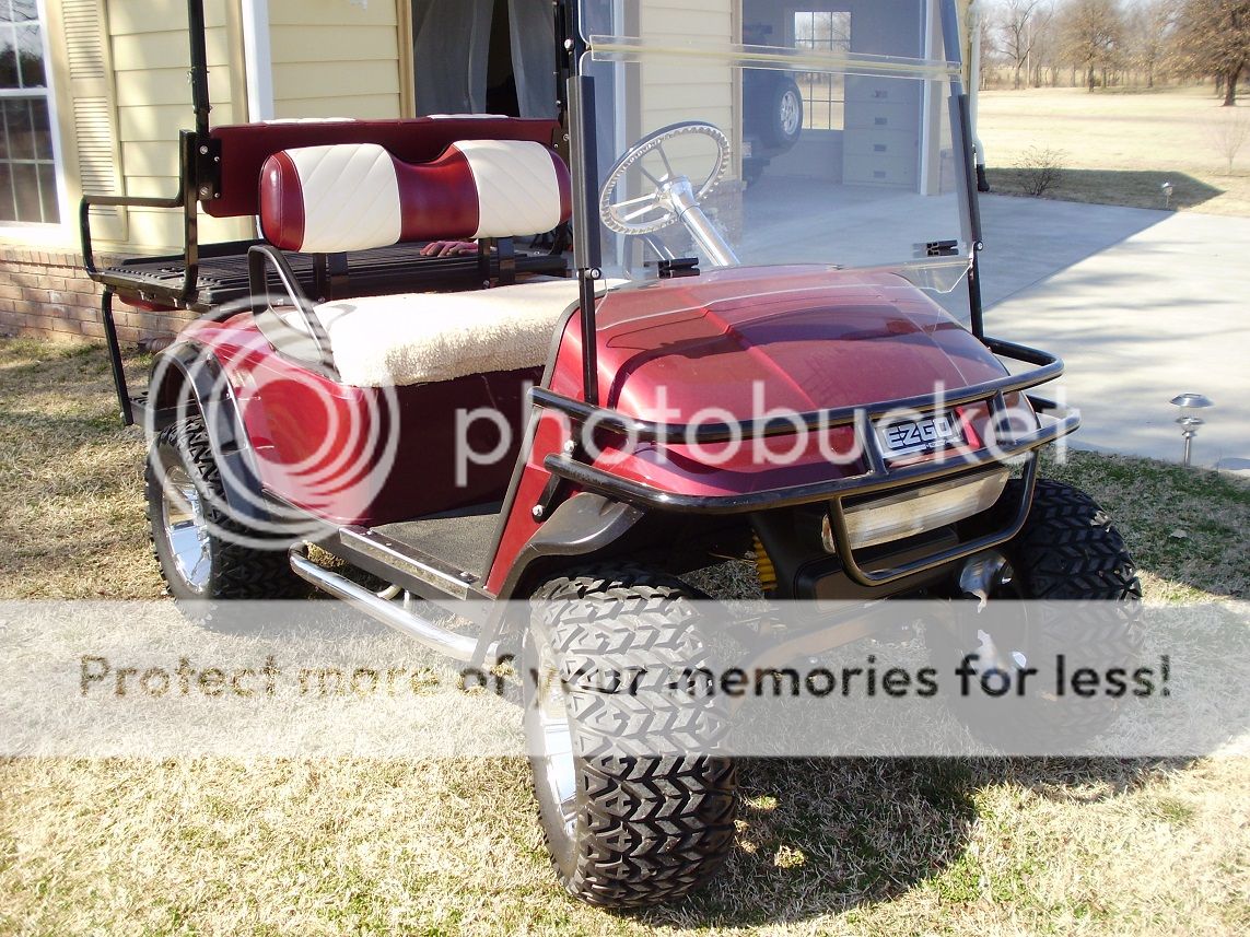

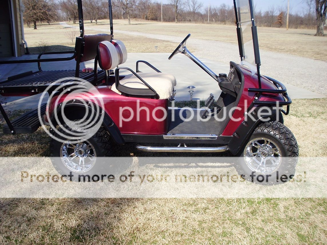

Yesterday the temp was 74 and the honey dew list came out of the darkness again! But while working out side I was asked if our golf cart had any influence in the color I painted the car? Crazy as it sounds, I never gave it a thought until yesterday. Here' our golf cart and hard to believe, but it had no influence!
We believe you now :rolleyes: but if those rims and tires show up on the TF, well then..... :p
