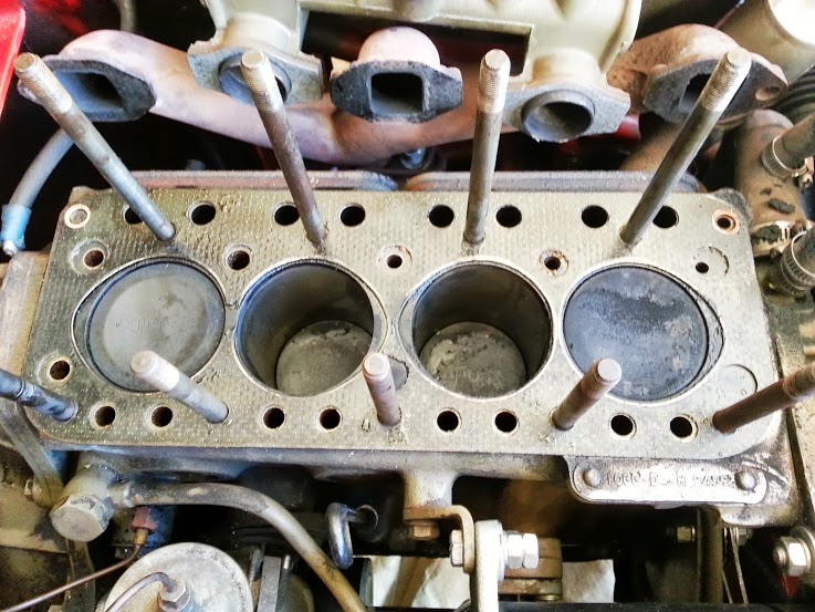

Pulled the head off today. You can clearly see the blown gasket between the back two cylinders. I purchased a new Payen 1275 gasket from Worldwide to replace it with. Looks like it will work, but it doesn't quite match the old one with the elongated cylinder holes.
A few noob questions... I assume the surfaces need to be immaculately clean. Anyone have a preferred cleaning method?
I tried to be careful pulling the pushrods out, but on two of them I heard a sound like a falling bolt. Was that the tappet? Will that be a problem when I re-install?
I searched the forum and saw that some people recommend re-torquing the head after a certain number of miles, and one person that uses threadlocker. I didn't see mention of these in the manual. Thoughts?
Thanks!
Is it an optical illusion? The #4 piston looks different shaped than the rest.
AN5Sprite
I've had this happen to me. It is possible to pull the tappet out of it's home and drop it. You should be able to see if this happened by shining a light down the pushrod hole. If it did you'll have to pull the side cover off and put the little guy back in his hole. Not really a big deal. (unless you fail to realize/correct the situation)
I've always used paraffin oil and/or acetone to clean the surface. Razor blade if I need to scrape off a little gasket hanger-on.
Hope that helps.
