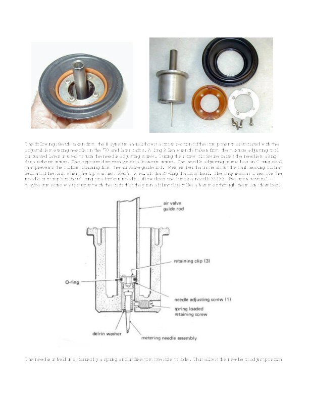

The carbs do not need to be rebuilt and this is not normal. Below is a picture of the piston. Did you have it out when you took the tops off of the carbs?
Yes, Paul- I had both out to
check the diaphrams for leaks.
But not in pieces. As the single unit you show
in your left photo. My needles are adjusted
from the dashpot top. Ben made the mixture settings
and Ben set up my carbs for me.

OK, the reason that I asked is that the piston will stick if the needle isn't inserted into the jet properly. Take it back out and let's see what you've got. You can then check the movement while the top is off and make sure it goes up and down freely at that time.
I'm betting on a bent needle.

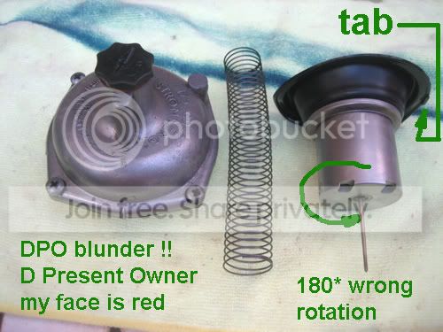

It appears my non-functional front carb is another DPO blunder.
Dale Present Owner (DPO) failed to notice the centering tab on the
carb diaphram. He also totally missed the carb cyclinder was
re-installed 180* out of proper location.
I ain't a mechanic here, but I guessing the piston was never "stuck"
while the engine was running. My guess is the intake manifold was
sucking (vacuum)against the side of the piston with no holes.
I noticed this morning the piston slid upward easily with the engine off.
I hope I did no damage. A quick warm up, drove 40 feet and tried to
balance carbs. One other balance attempt after I had removed the carb pistons and put one back wrong..
I'll put it back together properly and see if there is a difference.
dale
It should be fine now. This is a learning experience for all, so don't feel too bad. I've done worse over the years.
Wow!!
What a difference having the carb piston installed
correctly makes. The front carb now Vrooms just
like the rear carb.

Dale,
Buckeye Triumph out of Ohio has a very easy to follow, detailed explanation from beginning to end of disassembly, overhaul, rebuild and adjusting. That's where I got the picture for you above. I thought that I had emailed them to you in the past, but I will do so now in pdf format. That will explain any and all required adjustments in a methodical and easy to follow manner.
