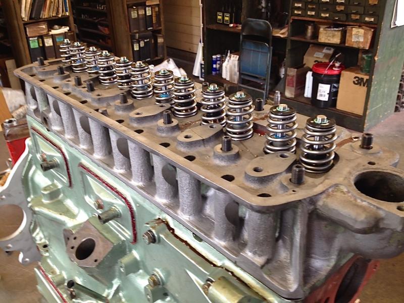

We use a Comp Chevy Hi-Pro complete valve system, springs, retainers, etc. The valve's are a little longer, so a 1/4" spacer is used to elevate the valve cover. Good to 7500-8000 rpm.
