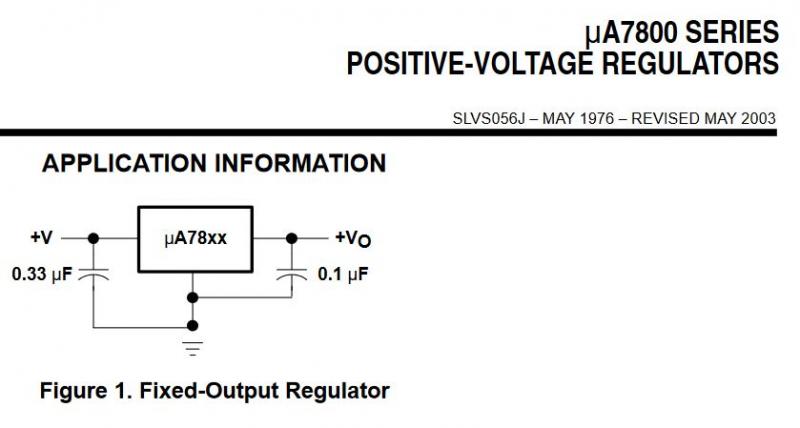

Yeah, definitely need some capacitance on the input and output; below is a clip from the 7800-series IC data sheet. The one you want is the 7810, which has 10 volt output. You can get them lots of places; look on-line or even eBay.
Automobile electrical systems, especially on 60s-era British cars, are notoriously dirty. It's not at all unusual for them to generate big spikes, which can damage an IC. I'd add some circuitry to limit the input voltage--like a 20-volt zener diode.

I have used 7810 chips for years in LBCs and have not bothered with the input cap. That said, it certainly won't hurt to add one for protection.
I am not convinced that the output side of the chip benefits from a cap on that side. Consider for a moment that the electromechanical Smiths stabilizer switches off and on multiple times per second swinging the output voltage from 0 to about 14V to produce an 'average' 10V. The output of the 7810 chip is much more stable to begin with.
Which is very much the way it goes with parasitic oscillation. Happens only sometimes, not all the time.
I agree about the output cap not required, it's just to improve regulation for sudden changes in load (which aren't going to happen in this application, the load only varies slowly.
But the input cap helps keep the chip from oscillating, and is probably a good idea even if you do have a cap somewhere else in the system. (For example, I put a cap on the generator output on one of my previous TR3s, to keep the generator whine from jamming the CB radio. Most stereos have filter caps inside too.)
