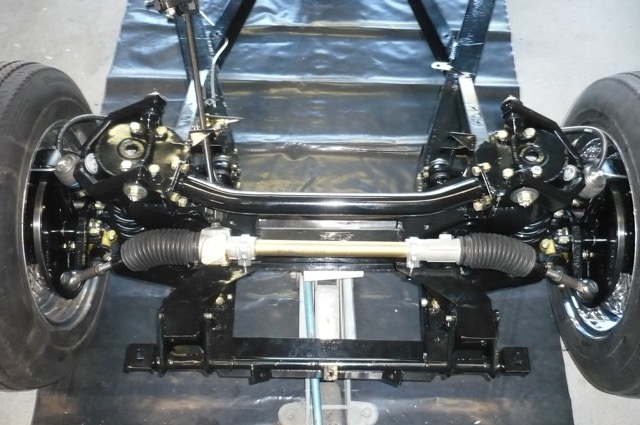

Hi all, I have recently bought a Moss R&P conversion and have been trying to install it. I have reversed the steering arms as instructed and fitted the spacer when reinstalling the steering arms but the only way I can get the steering arm to sit back in position would be to bore out the mounting holes which I am not willing to do. In the current position the wheels are pointing outward in opposite directions as the steering rack thread is too long and I can't wind the tie rod on anywhere near far enough to get any sort of wheel alignment.

I cant help with the Moss conversion as i went with the TR Bitz or Bastuck rack and it went on without a hitch no bump steer and i modified a mini indicator switch fitted under the wheel. The rack is a Mini rack in my case out of a left hand drive mounted upside down for right hand drive.
Sounds like you may have got it wrong somwhere so i would get onto Moss for advise.

thanks for the photo, sorry for the long time for the reply but have been overseas. I managed to work out that I must have inadvertently swapped the steering arms over when I had stripped the suspension down previously so the extended boss was on the wrong side when I swapped it over again. I haven't yet got it all together but it certainly looks a bit better than it did previously.
