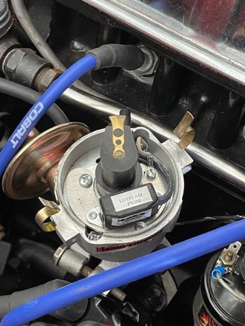

Ken are you sure you are not a tooth off on installing the distributor and that you have compensated for the tooth off by advancing the timing so the car will start, but the timing falls off the scale when you give it gas to advance .
If you pull the plugs out, and spin the engine over with your thumb over the spark plug hole to feel the air push out on number one piston (this insure both valves are closed.) Then look at the timing marks on the cover and pulley, and bring them both in line because they probably past each other by an inch or so before the engine stopped.
Now pull the distributor cap and see where the rotor is pointing. It should be pointing straight at the number one push rod tube. If not, you are a tooth off at the distributor.
Can you take a picture of the distributor with the cap on to see the orientation of the distributor relative to the block? Sometimes you can see the distributor is too far advanced by looking at the cap placement.
steve

I'm pretty sure the shaft is in the right tooth although it's easy to get it off a tooth. Here's a pic of the current distributor at TDC on compression stroke.
Although I realize that there is a procedure for setting up the timing gears if they are not marked. But I have successfully with 3 rebuilds now been able to use the old marked gears to determine where the marks should have been. To me it says a lot for don't throw old parts away. I have seen that there is very slight change in the alternate positions for the timing gears.

Looks like a tooth off to me. The distributor vacuum advancement line should sit about parallel to the engine and I believe the rotor should come back counterclockwise the thickness of a tooth on the distributor drive shaft for the rotor to point better at the push rod tube, but heck I could be wrong. I will set mine up at TDC tomorrow and take picture.
steve
steve
Thanks Steve. If I remember right, I could never get perfect alignment with the push rod tube. One tooth over put me on the other side of the tube. The vacuum advance is out of position because I was timed at 30 deg. btdc when the photo was taken. I'm now at ten degrees and the vacuum advance is more parallel with the engine.
