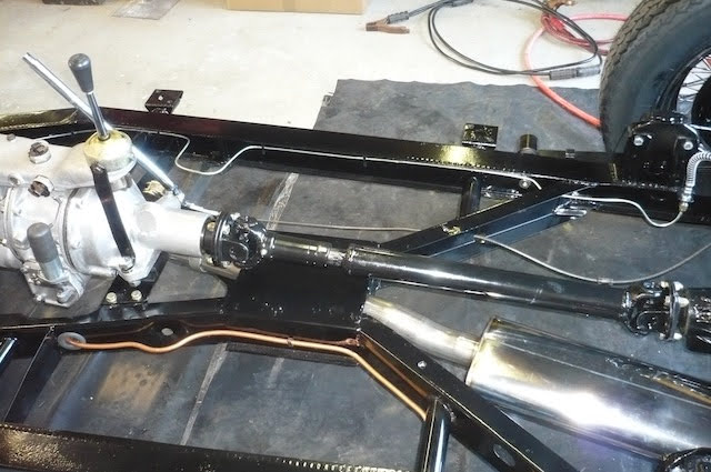

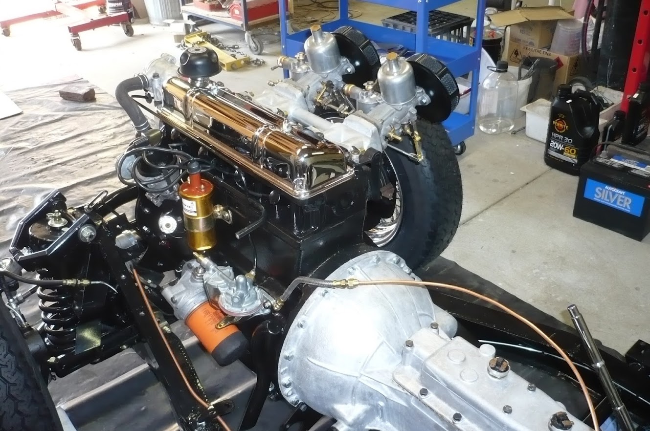

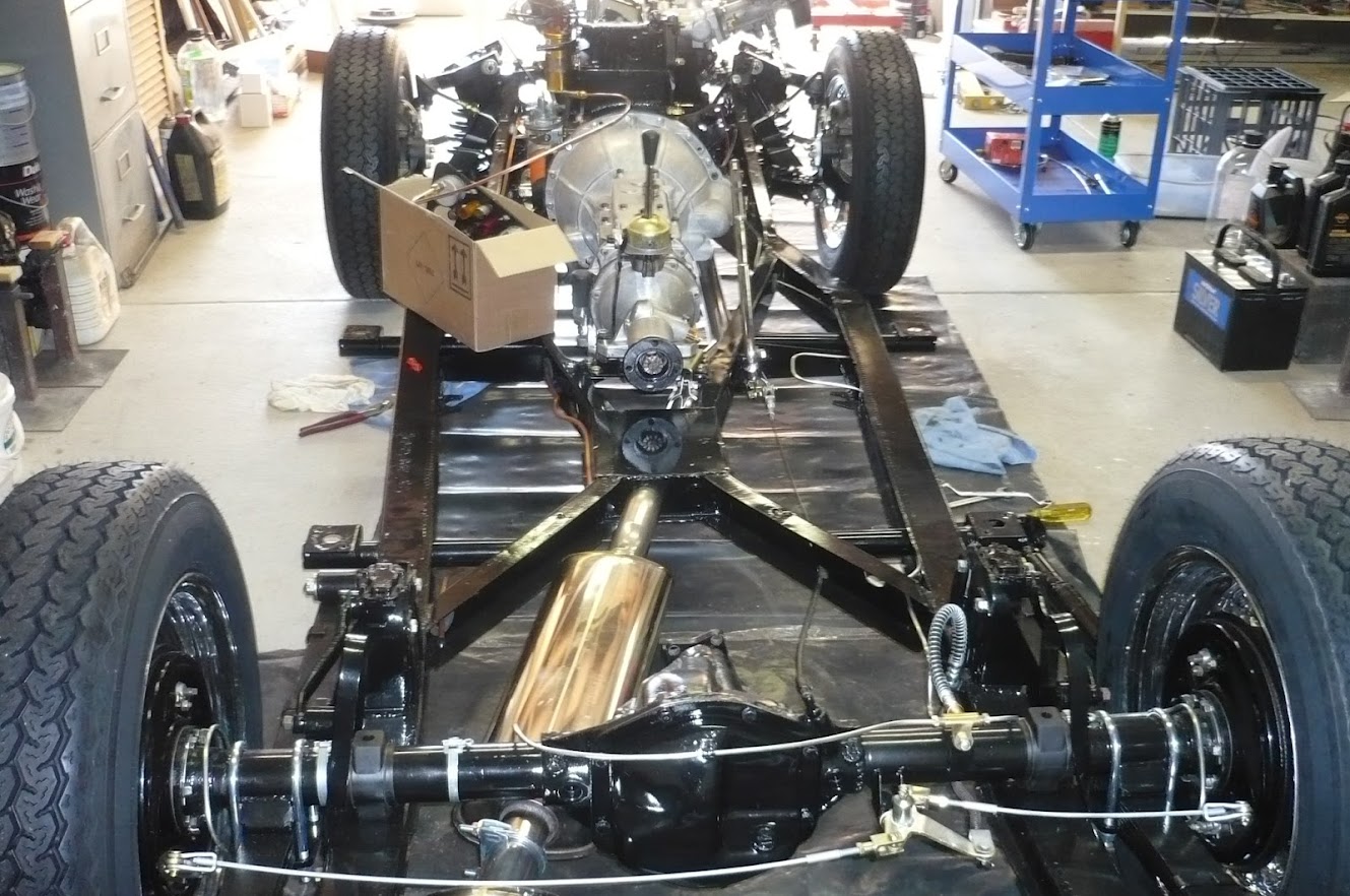

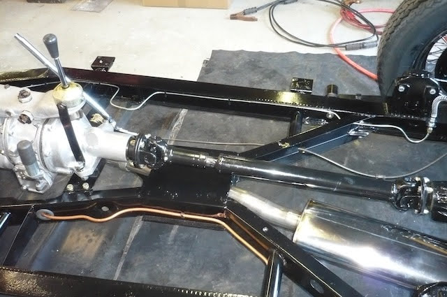

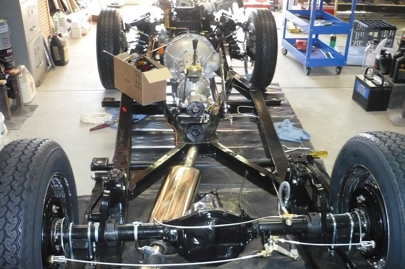

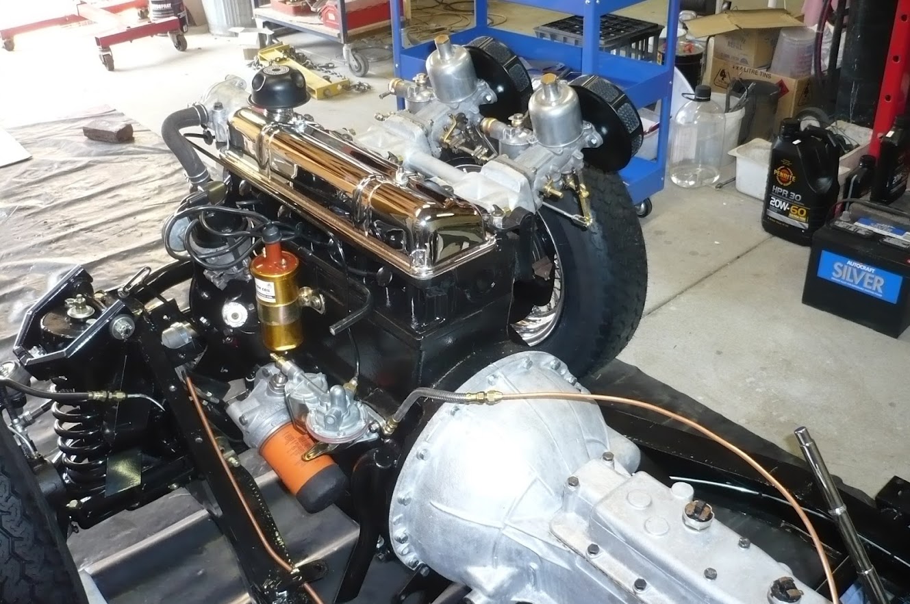

You can see part of the fuel lines I made out of copper tubing in these photos
Graham
