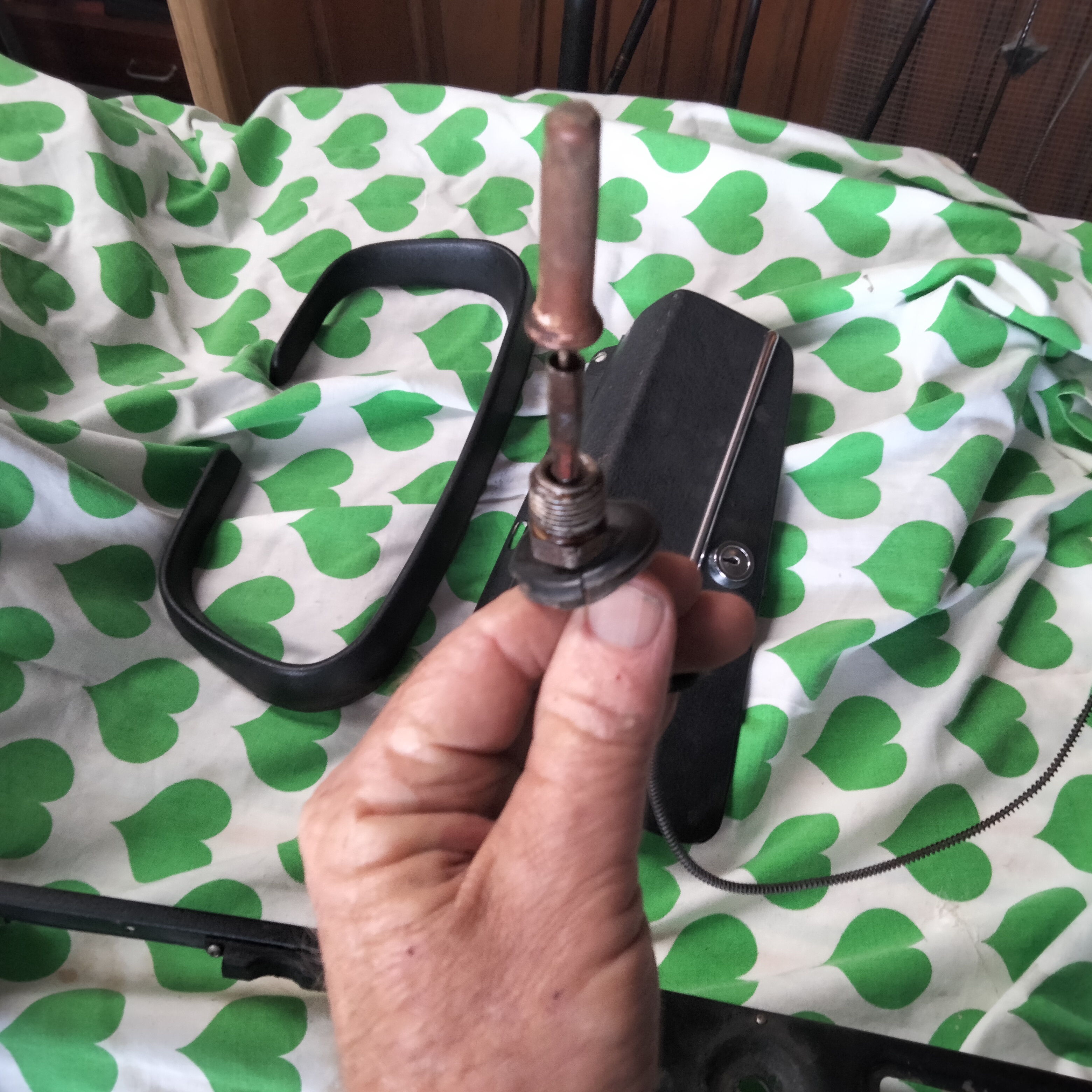

Back home and followed your instructions and success after removing gauge and sensor from car tested it in the old kettle and thermometer and it still works fine. Below are the sensor out and the dash out ready for stripping and painting but it is a cold and miserable day as per the photo about 14 deg C so will tackle next week as my grandkids have come to stay and I have to play monopoly bid card game .
Thanks for your help

Good to see you got the temp gauge out undamaged. I've seen some where the tube had been cut, with the mistaken impression that tube was a wire. A repair is possible BUT(!) too fiddly and dangerous for most folks.

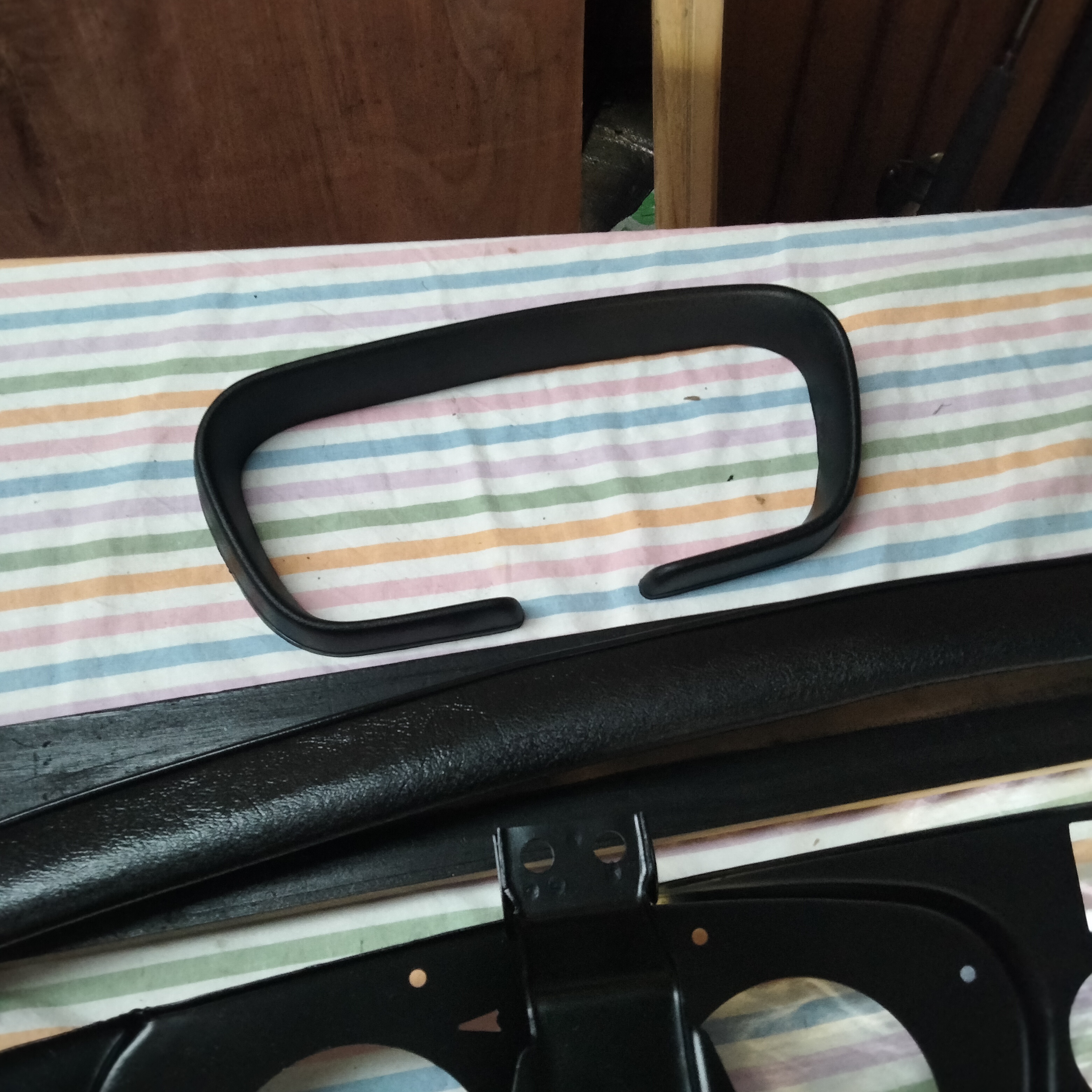

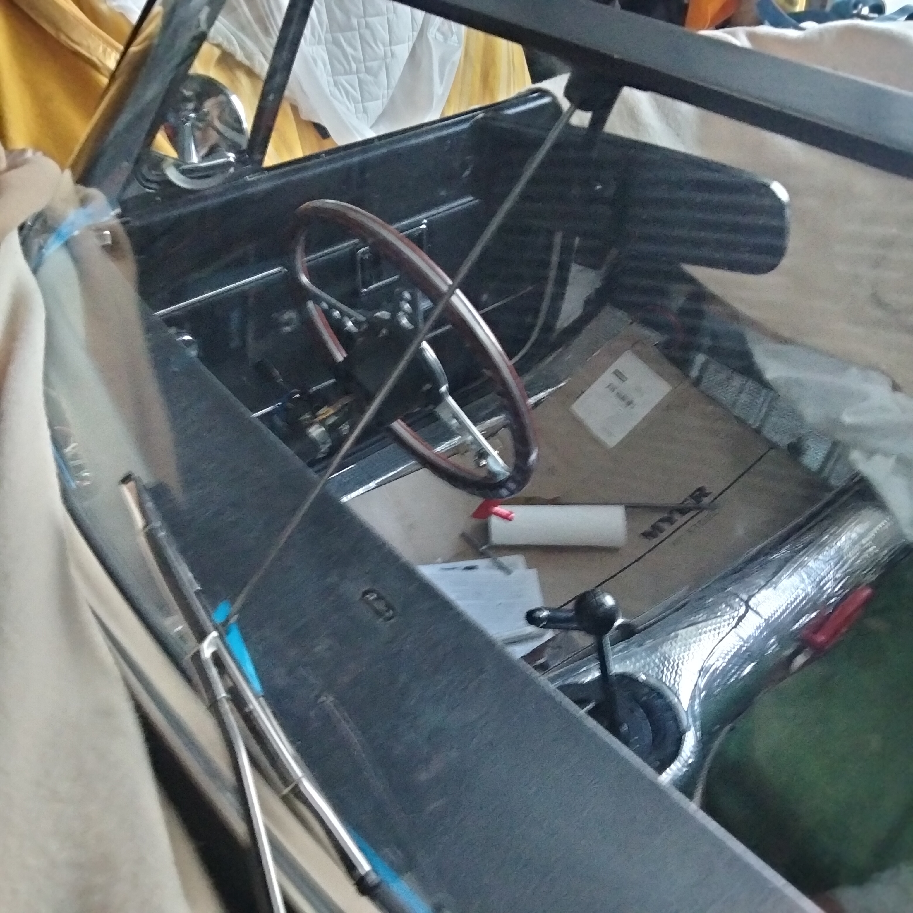

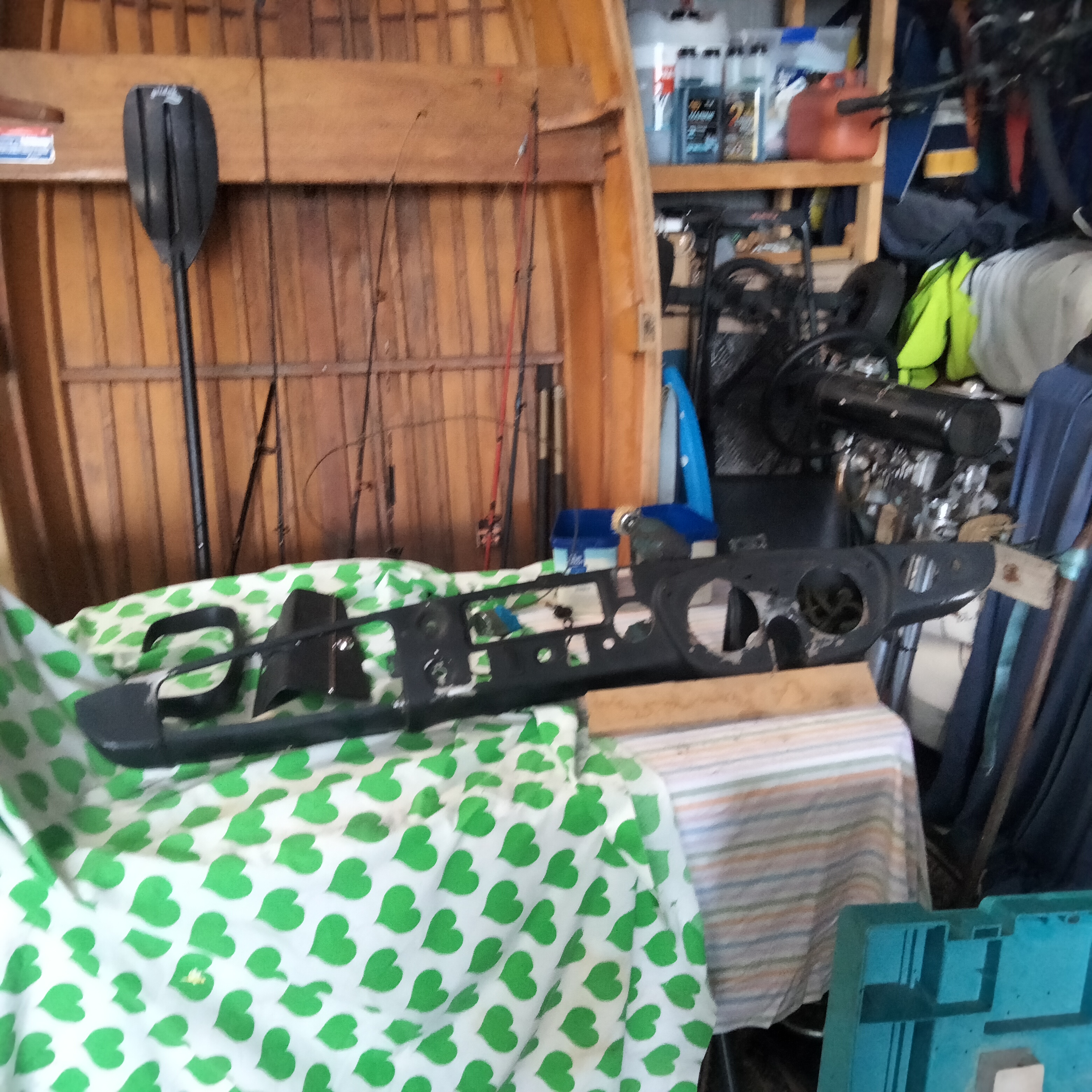

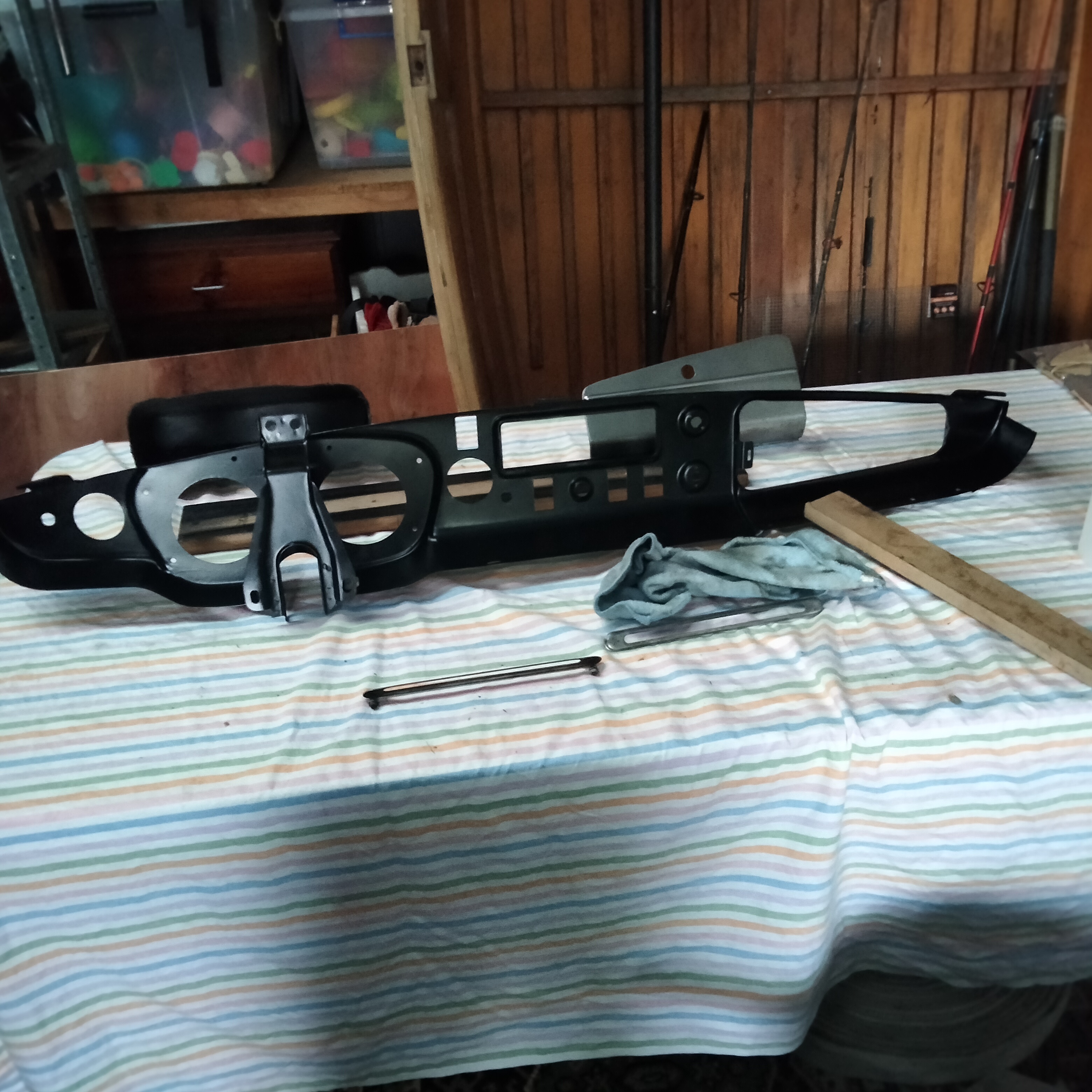

I started on the dash to day we had good weather 20 deg C so I stripped the dash front and back treated the surface rust
then etched prime then a finish coat of black on the back of dash also did the dash pad and dash with duplicolour vinyl paint

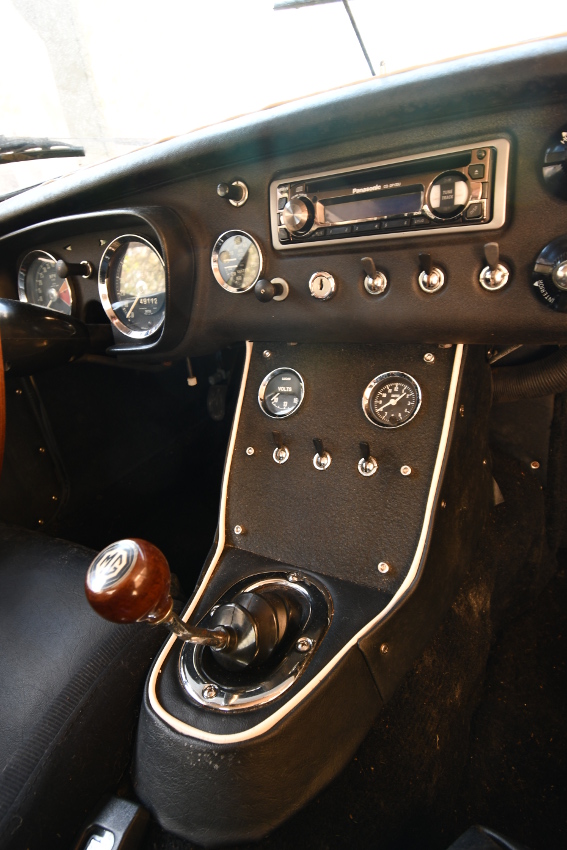

have used this on centre consul and side wall panels it comes up really well see photo attached as well I replaced the centre rod of the windscreen as it was rusted see photo as well worked on my 1960 Seagull outboard so busy day.

You have a Seagull!?!!! Outstanding! Only ever seen one "in the flesh" in years.
Your work on the dash is looking good. I made a new crash pad for ours, used a swimming pool "noodle" for the foam, contoured with an electric carving knife and covered with the vinyl supplied from Moss.
