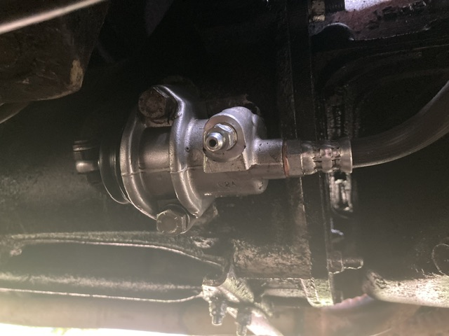

View attachment 92282Here’s a photo of my setup thus far. If I move the hose to the hole where the bleeder is, it kinks at both ends and also pulls on it, which can’t be good.
The hose and bleeder are correct in this photo. I've run into the problem on a few B clutch systems, the hydraulics were usually bled with an E-Z--Bleed with no issue. Another "best practices" way is to remove the slave from the trans and clamp the slave cylinder puck all the way in using a socket just small enuff to fit the bore. With bleed screw open slightly and hose fitted, immersing the other end of the hose into a jar with some small amount of fluid, pump the pedal a few times. Close the bleeder and refit the slave to the tranny and stroke the pedal to refill the slave. If that doesn't give enough to fully disengage the clutch there's a mechanical problem someplace. If the clevis pins at either end of the system are worn, replace 'em. If either of the rods have "ovality" to their respective holes, they need replacing. Check the pedal hole where the other pin goes into the rod as well. Those are the "easiest" things to fix in the mechanical linkage. If all that still doesn't give enough fork travel to work the clutch properly, it's in the fork pivot or clutch assembly and the engine/gearbox need to come out.

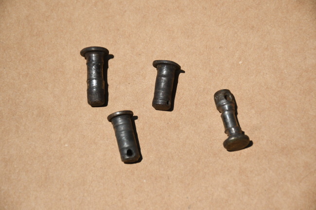

Some of the more extreme examples of pin wear found over years of servicing these cars:
The one far right would "cam" and sometimes work, sometimes not!
looking at the clevis pin, remember all things wear in both directions so the hole will be just as worn giving twice the amount of free play
Given different hardnesses, and the fact that the clevis does not spin as much in every hole it bears on, wear of clevis and hole may well not be equal in each part. Note, for example, that the shoulders in Doc's picture are mostly in better shape.

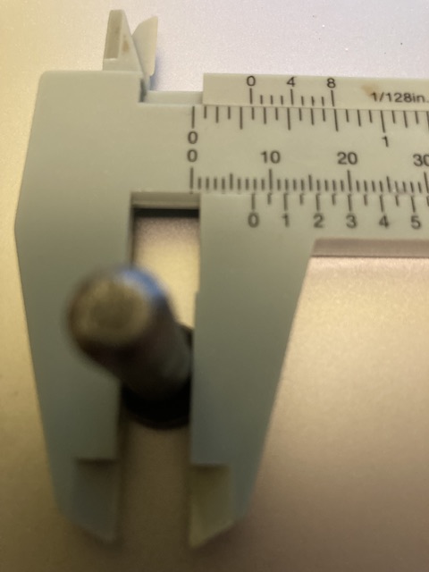

I don't know. They are sold by length and diameter. Measure yours. They are likely to be 1/4" diameter.
I haven’t checked the one at the pedal yet, but this is looking pretty close to 5/16”? The length is an odd thing because it’s hitting 28mm. Neither measurement should be metric, should it?
No metric stuff on an MGB. And measure the pin diameter on the cotter pin end. It doesn't get any wear.
and please don't assume it is original (though in fairness it looks like it is)

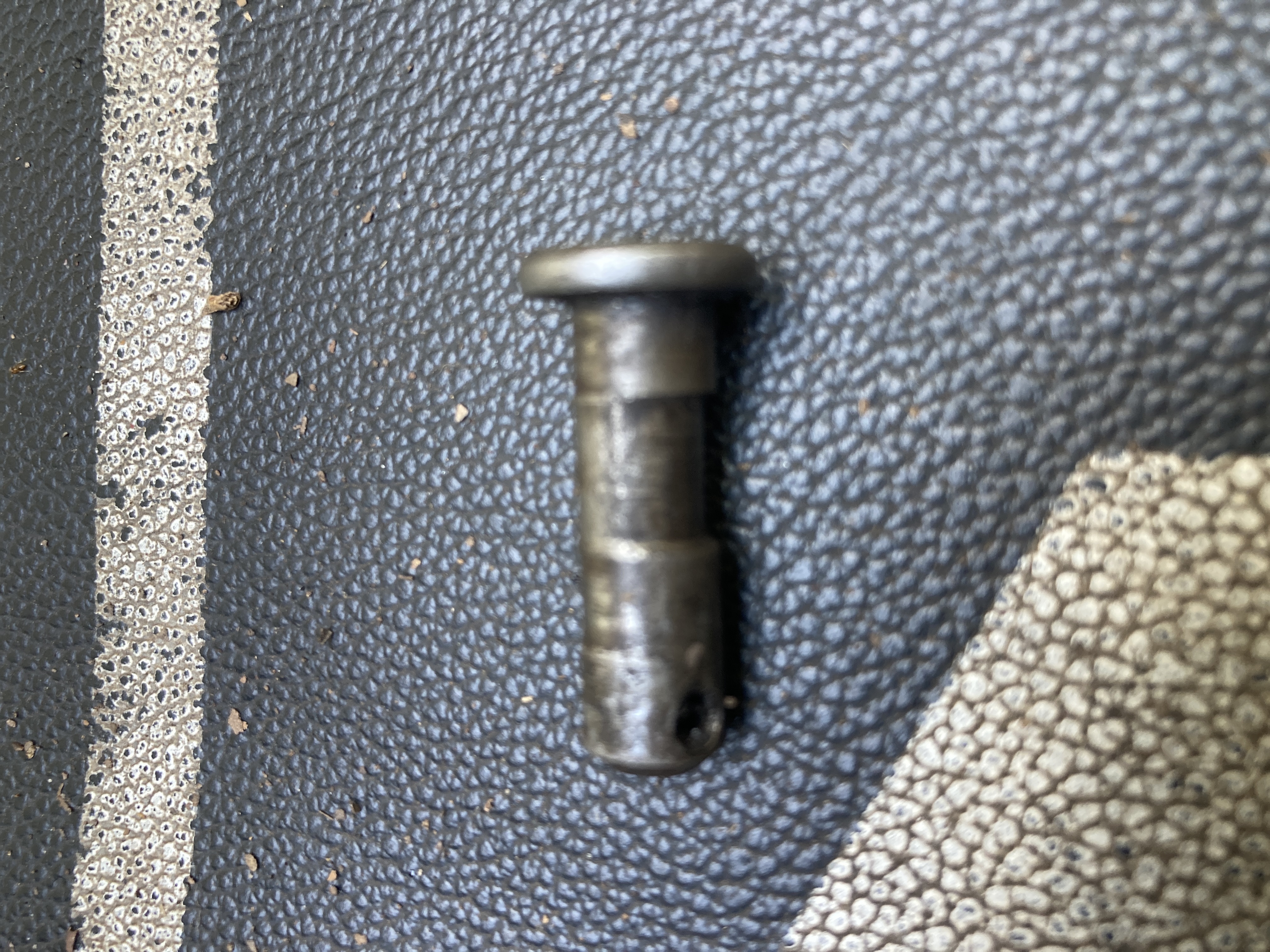

Update: I got the clutch to work yesterday late afternoon. I used my HF version of the MityVac. You may remember that my OP said I didn't want to use gadgets. Part of the problem is that I bought the HF thing to use with helping to bleed the brakes, and it was very little help, though the ridiculous bleed screws on the new wheel cylinders didn't help. The vacuum pump thing in the HF kit is decent, but most of the rest of it, such as tubes and rubber/plastic fittings, leave some to be desired. I might consider a real MityVac, but only if it's that much better than the HF thing. The problem with some of these gadgets is that they can end up being alot like a get rich quick scheme.
But anyway, clutch works, but the catch point seems pretty low on the pedal's travel. I'm gonna guess that the worn clevis pin could be a factor in that?
