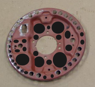

I'm gonna build a set of brakes with the modified shoes & without the park brake stuff to ss where I can whack more metal.
I picturing something like this... Or even a bit more cut out...

That's kinda what I have in mind also but I want to put it together & draw where to put holes so they don't affect the shoes

Makes sense to me (to check it installed). And by using circles like that it won't weaken the whole thing if there are any loads on it.
That's gettin' perilously close to Swiss cheese... but looks structurally sound enough... I'd check it for deformation with regularity, and have spares handy too.

I left the pressed flanges in, that should leave enough to keep it straight.
Well, heck, Doc - what about this:

Too many holes between the brake shoe mounts and the axle mounts will cause this to fold up under braking torque-be careful.

Add a few more lightening holes and a bit aluminium and you won't be far of.....
