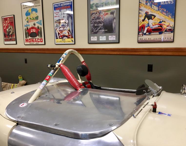

There's a chap in the USA that has figured it out. Maybe ask him, he's only a couple miles from you.
Michael Oritt
Metal tonneaus are certainly very cool looking but pose a definite safety risk of injury to the driver in case of collision, etc. They're specifically prohibited by most race organizations unless originally supplied by the manufacturers and then only for certain cars. Here's VRG's rule:
3.2.10.8. Rigid (metal, fiberglass, etc) tonneaus, covering the passenger compartment beside the driver, are not permitted, except the case of certain sports-racing cars which were originally so equipped (Jaguar D, Lotus XI LeMans). Fabric tonneau covers are allowed.

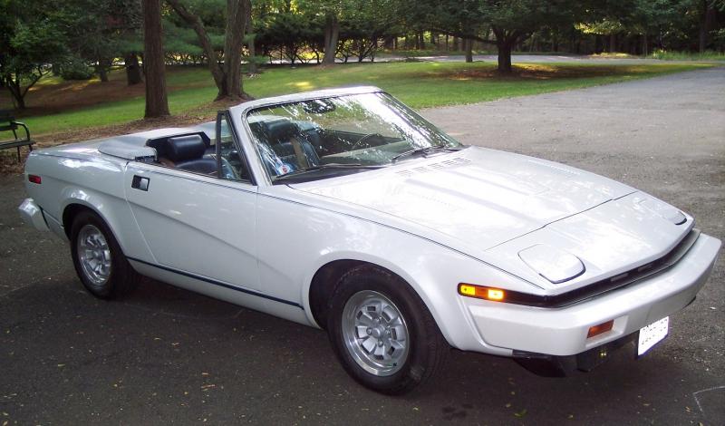

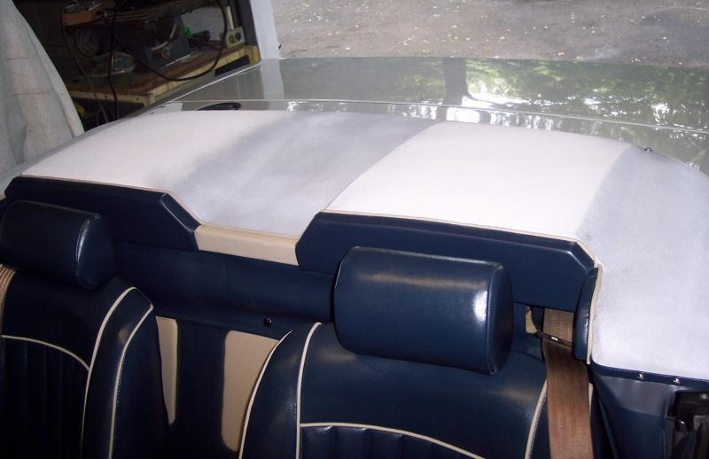

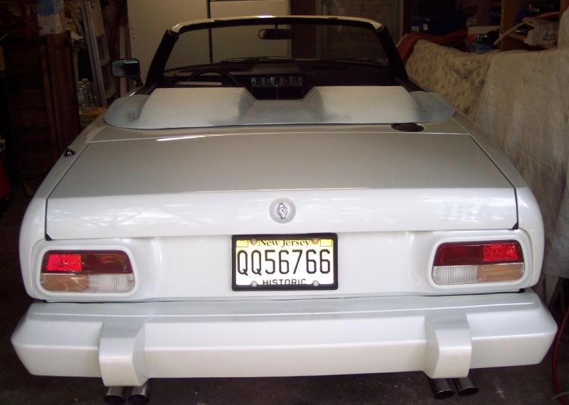

Although I don't have a source for a half-tonneau cover for your AH-100, I can't see making one out of fiberglass would not be that difficult. A while back, my Son chose a not so healthy orange '79 TR7 with a deteriorated red plaid interior. Taking one look at the car, I knew it would not be my favorite and decided to address its deteriorated issues when my Son was off at College. When away at school, I re-did both interior and exterior of the TR7 and also designed molded a tonneau cover to replace the ripped original vinyl top cover.
View attachment 47419 View attachment 47420 View attachment 47421
As you can see, the TR7's tonneau is larger and a little more complicated then the half-cover you are interested in acquiring. However, should you not find a vendor and be interested in doing one yourself, I would suggest you consider fiberglass and the creation of a relatively simple mold. I tried this only once but can say "I did" and had enjoyed the experience and still use the cover.
