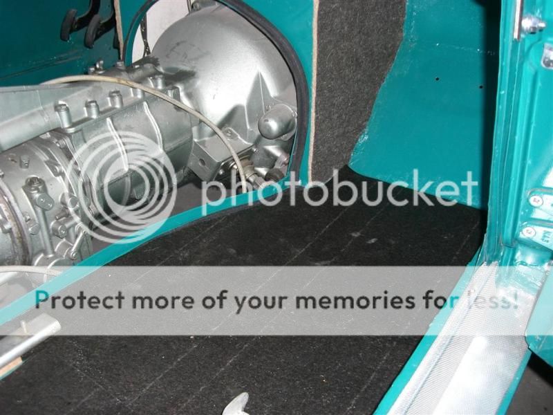

This is the right side of my transmission but I don't see any stamped numbers.
My gearbox number is supposed to be 3567 but not sure how I can verify that if the number plate is also missing on the housing as it is on the engine! Maybe when I next have it up on a lift I'll be able to see the number...
See the projection ("boss") on the passenger's side of the gearbox case, in the middle of the "waffle"? The serial number is stamped into the metal of the boss, not on a plate that is likely to be lost/destroyed.
The only pic I have is too low-res to blow up enough to read the numbers on the boss. Guess it'll wait till I have her up on a lift in a few months.
