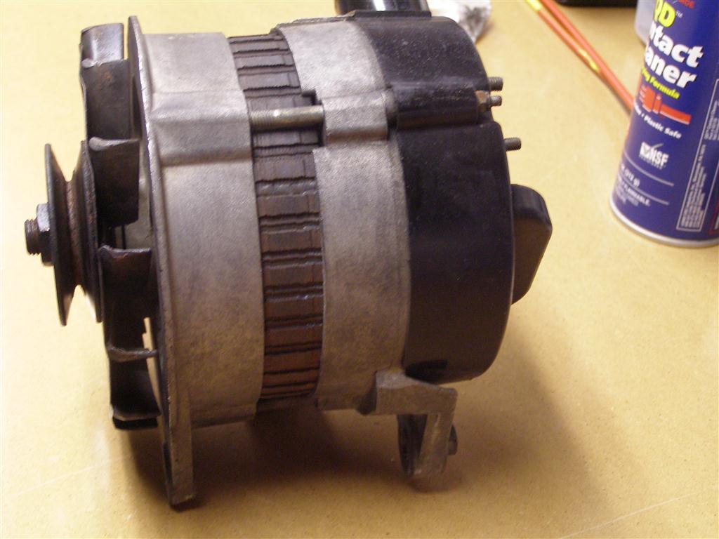

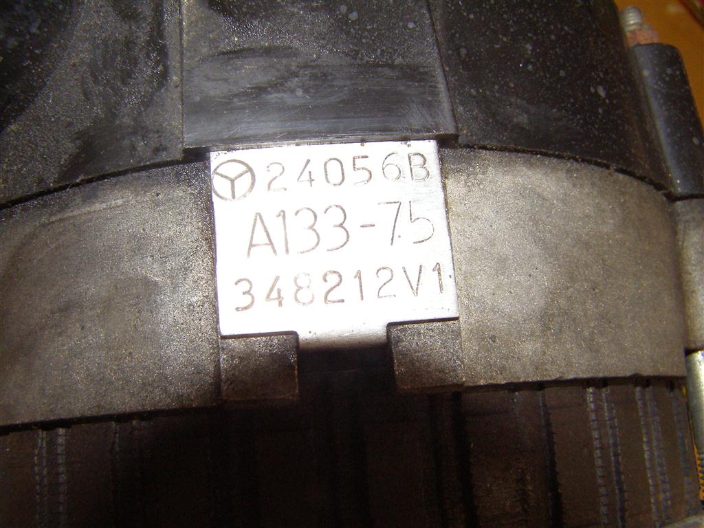

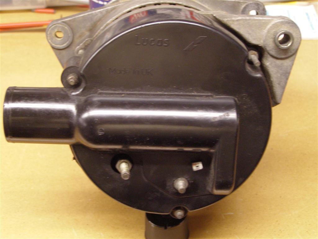

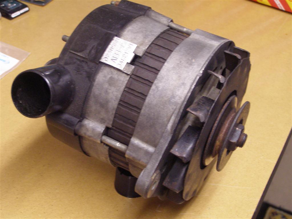

I took these of the stock alternator that I removed from my TR8. 1980 with A/C. Do you need any other numbers or pictures?

This is just one that I got in a box of parts that I picked up and trying to find the applications so I can sell it. I'll get some pictures of it on Tues when I get back to the shop. I've found that it fits 72-76 XJ6 but I'm sure it fits others as well considering where I got it the guy had all Triumphs and a couple MG's.

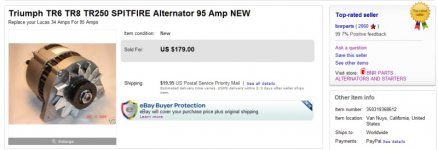

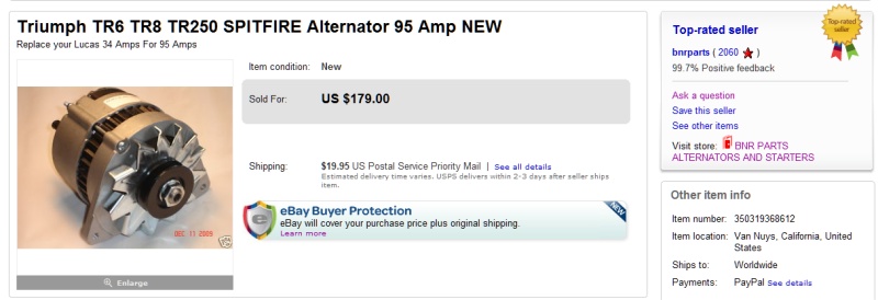

It must fit other applications, as it's replacement was the same exact 95 amp alternator that went on my TR6 this summer.
The difference may be that THIS replacement (shown below) will accept the stock three wire plug on a TR6 and others. But it also has the live posts to place the ring terminals on that the TR8 uses. I don't know what is hiding under that black plastic cover and that will help tell you what it can fit.
This is what they say it will fit and I'm sure there are other applications, as this came off a Tr6 eBay listing.
This is what the replacement looks like: Brosky TR6 95 Amp Alternator Swap
