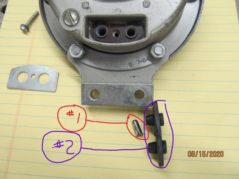

I finally found a working set of horns and have a couple of questions.
Does anyone know what a reasonably correct bronze paint to use is? Preferably rattle can.
Where can I get the electrical pieces to hook them up:
1) The push in sleeve the wire goes in to plug into the horn - I got one and need 3 more
2) The rubber seal - I got one and need one more (I can make the little metal plate but would buy one if they are available).
Thanks,

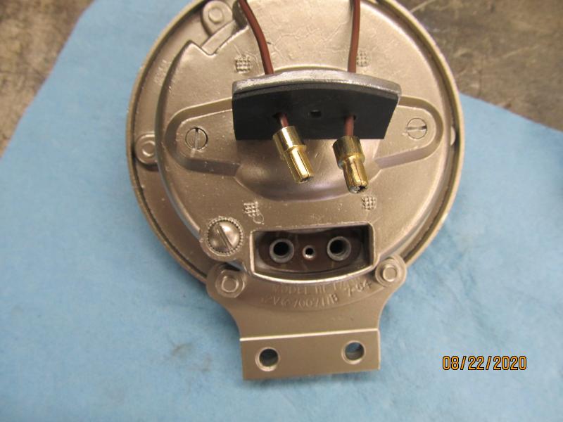

Lin, I think you have a 1960 BT7 like mine, but the horns you have are different from mine, mine having an acorn nut on the front and the wires enter on the back side with bullet terminals. Are the ones you have original?
Lin
You are correct Rob. The horns on my car are not original. I posted the photo for the sole purpose of showing the color of the paint.

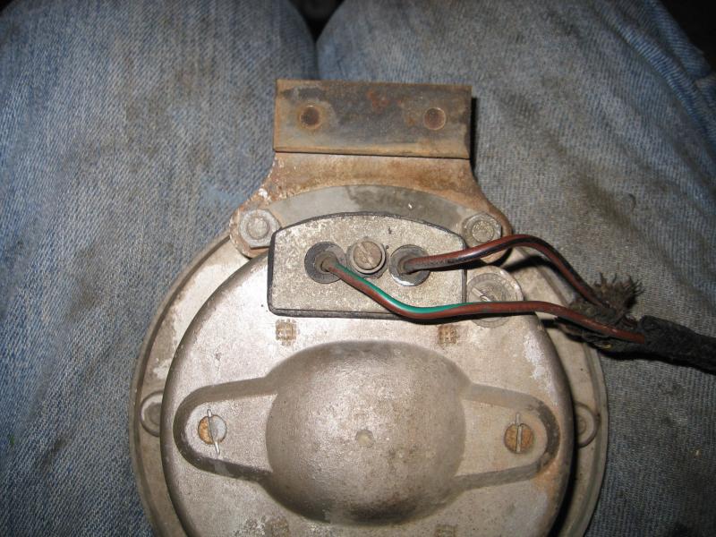

Here are photos of my unrestored horns. The back view shows the slight gold tone better than the front. The blue overspray was from a car respray from 1980. I think I repainted them with Rustoleum Silver Hammertone over a gold base. Couldn't find photos of the restored versions.

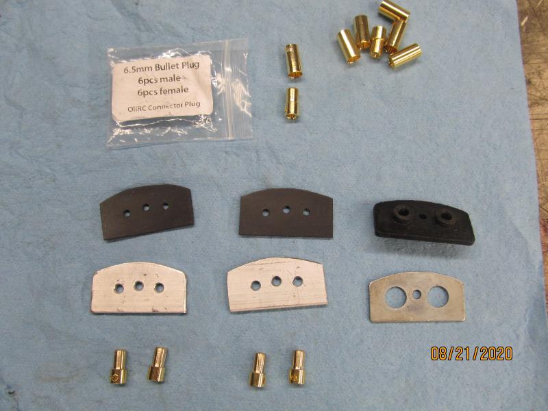

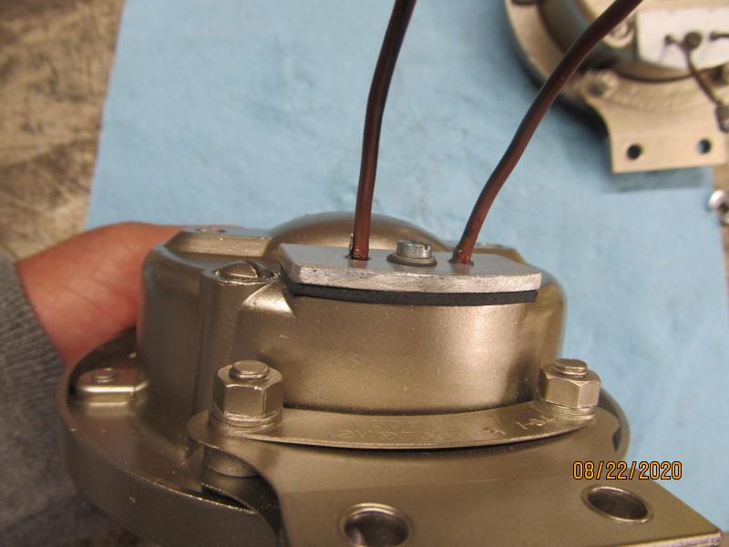

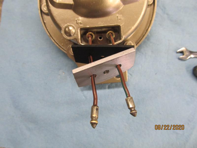

Follow-up - this post is probably useless info for most but just in case it could help anyone I though I'd show my resolution to the electrical connection issue. This is due largely to waiting for my block & head to come back from the machine shop so I can build the motor, and fear of this virus keeping me trapped and bored at home....
Earlier I posted a link to some brass bullet connectors on Amazon that are 5.5mm diameter - turns out they are just a little too small (.214) and didn't hold very tightly in the holes of the horns. I happened to have some identical connectors that are 6.5mm and I chucked them in the lathe and turned them down to .220 dia. and they were a nice tight hand press fit in the holes. I cut some cap pieces out of 1/8" aluminum & drilled some holes. I also cut some fairly hard rubber pieces about .090 thick and drilled holes. I cut out a few inches of the correct brown w/green and brown w/black color coded wire from my old harness (never throw anything away!) to make short pigtails by soldering a standard bullet on one end and these new brass bullets on the other, pressed the brass bullets in with a dab of silicone to seal the wire to the rubber and now problem is solved. WOW, are they LOUD!!!! - I always had very anemic, sick sounding non-stock horns in the past and these are formidable. Now painted, wired, and mounted on the chassis.
