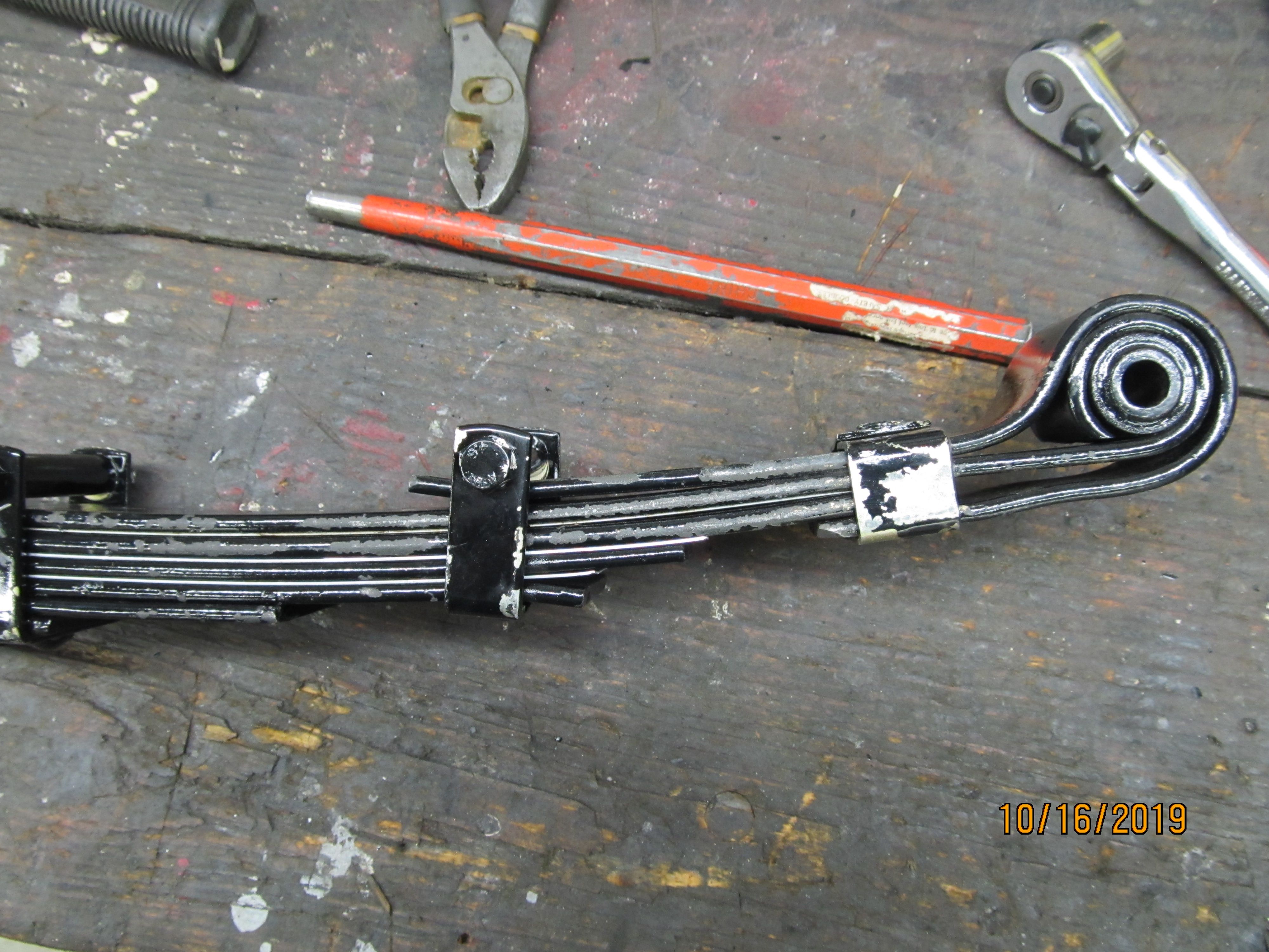

I have just taken some leaf springs apart to paint. In the past I have put Teflon tape between leaves but I don’t have any handy. Would it be appropriate to put a light bead of grease between the leaves before reassembling?

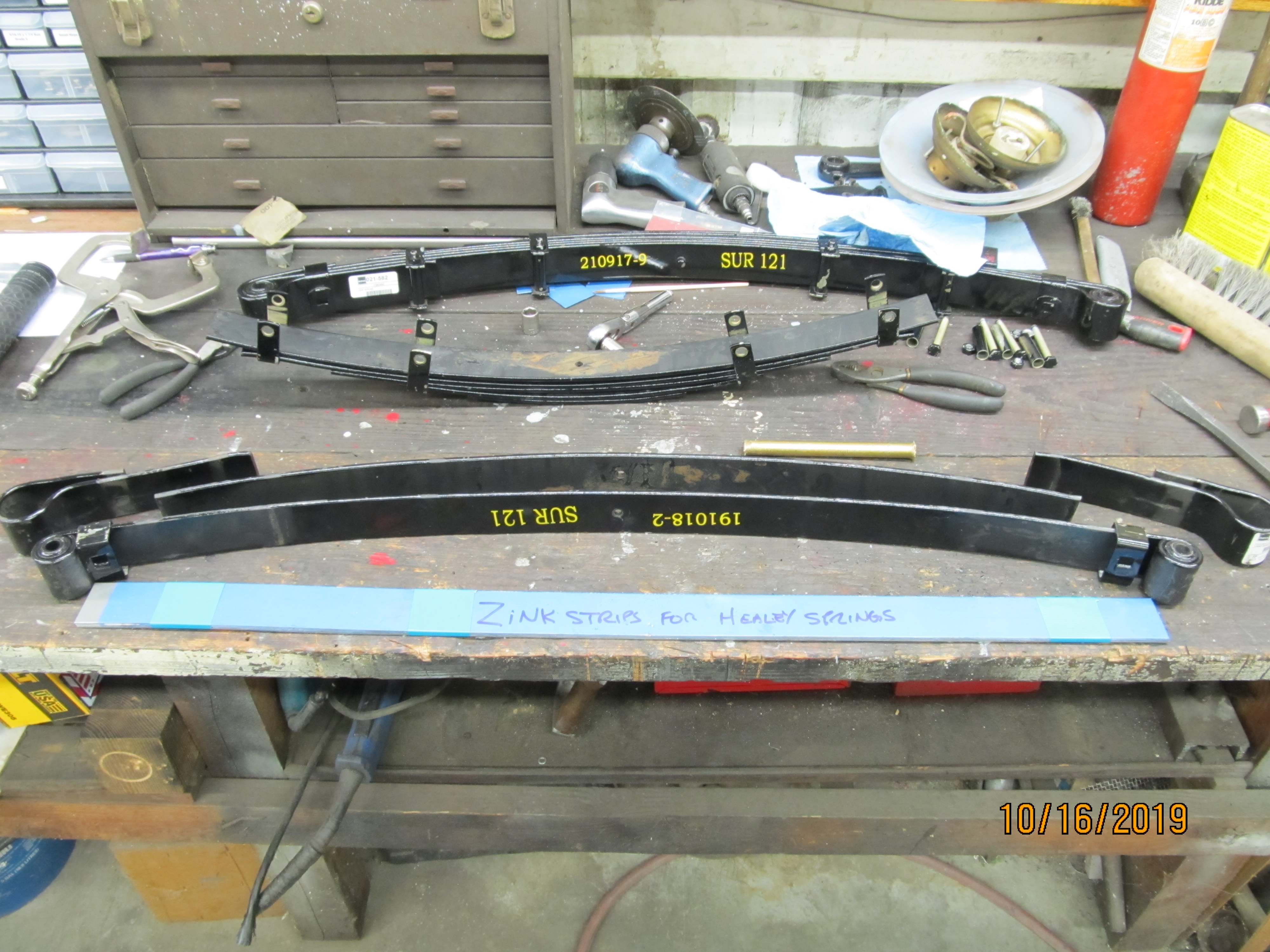

I would be afraid grease would attract grit. As far as I determined the originals had Zink strips between the top 4 leaves (3 strips), but I could not find any vendors selling correct Zink lined springs, so I bought some sheet and sheared to width and installed in the new springs I bought - I haven't driven the car yet so not sure they are as quiet as I hope.
Dave

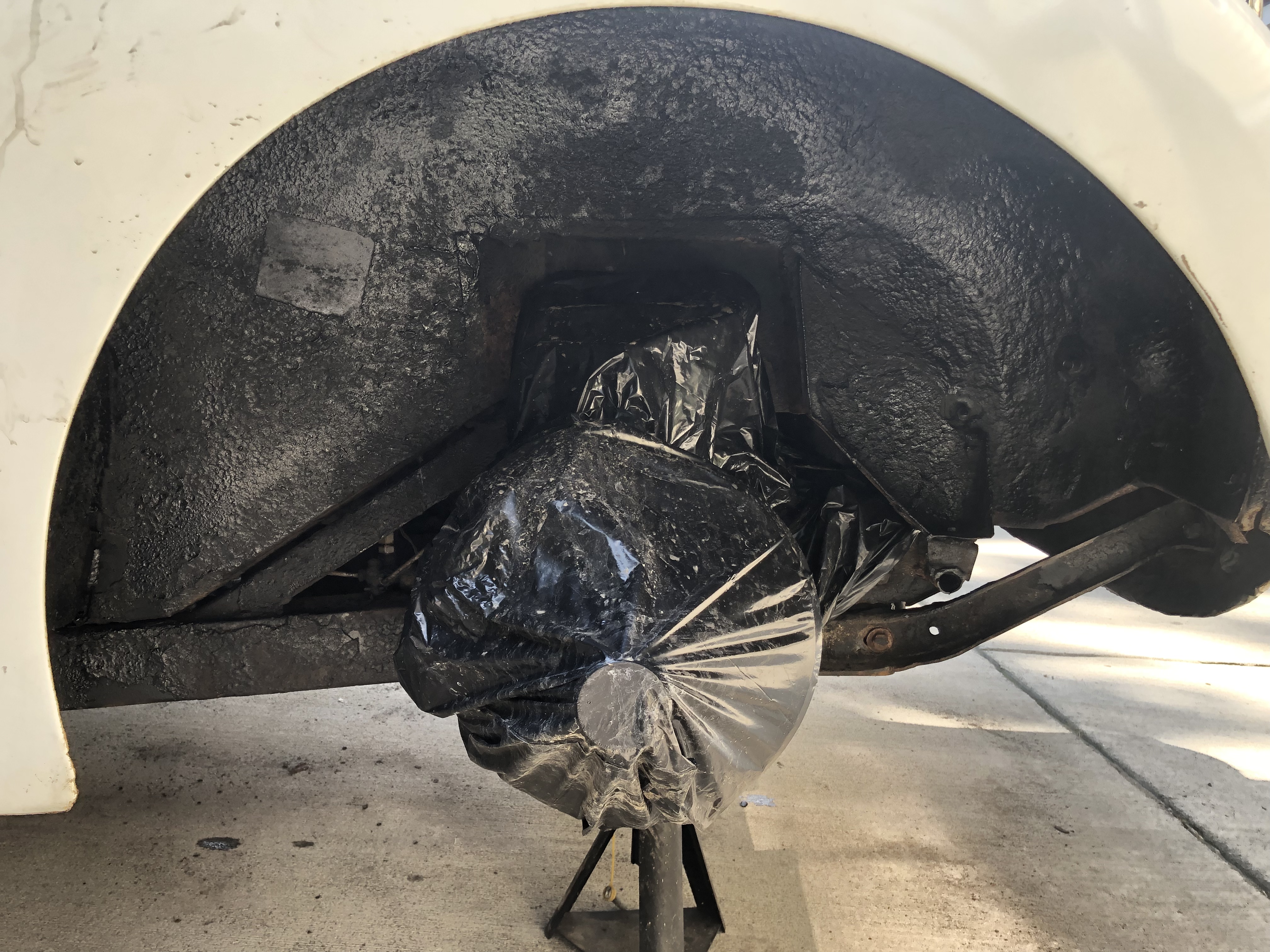

Previous photo was a front wheel. Here you can see the spring on the back wheel when I painted the wheel well.

Yes, you are probably right; the zinc strips are 3” wide. But I’m not prepared to completely disassemble the springs … yet.
The car’s odometer reads 23,700 miles. I have put about 10,000 miles on it after I got it running when I bought it in 1987. I suppose it could have turned over 100,000 before I bought it (between 1959 and 1987), but it was in pretty sorry condition when I acquired it. Believe it or not, I drive it home in 1987, and it boiled over twice. I found no (I.e. zero) compression in all four cylinders. When I dropped the pistons, they had NO rings. Some idiot must have just thrown it together for sale, and failed to put in rings. It had many other problems that I repaired to make it suitable for my commune car in Los Angeles 1989-1991. I quit driving it when I had to replace the fuel filter monthly. Moved it with me to Virginia, where it sat in my garage for 30 years. 2021 was the year I revitalized it, and use it as my golf car (not cart😄). It has won awards in two of three antique car shows last year (no competition). But it does look nice on top; very ugly underneath🙁.
