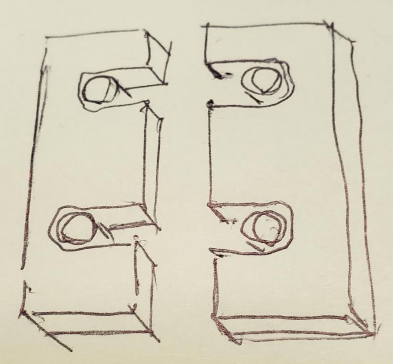

...Or a spacer under the motor mount itself:
I used similar in order to raise the engine 1/4" on the left side for the rear carb on the DMD manifold to clear the steering column. (Carbs are horizontal). Longer bolts were needed. You may need to adjust the throttle linkage slightly, though that won't be a factor if you're merely raising the engine back to its normal height.
BTW, aluminum works OK for these. I've had mine in for several years and out with no observable distortion.
This should hold you until you can remove the carbs/manifolds for a proper overhaul of the motor mount.

Steve, I made the shims you drew to raise the motor mount and compensate for what looked like a compressed top rubber buffer. I cut an access panel into the wheel well (that can be reinstalled with 5 screws after) but have not yet been able to install the shims due to very tight bolts combined with restrictive access.
