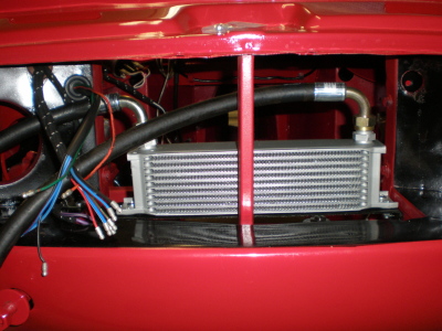

Hold On! Those are the only holes. There are no holes on the radiator side. I have no idea how the lines were routed beyond this point. I've seen spridgets with vertical oil coolers mounted in place of the fresh air vent. Maybe that is the purpose of the holes in the picture?

Would you please...I need to know how the oil cooler hoses get from out behind the grill through the front panel & then through the splash panel into the engine compartment.
I think Trevor's photo of his splash panel explains that side of the equation...now I'm just concerned about the grille side (unless your splash panel is different).

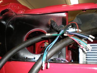

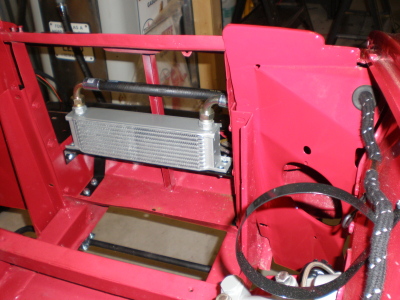

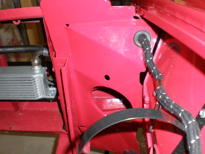

Okay, here are mine of the '63 in which I'm installing the oil cooler....1st 2 photos are from the engine side, 2nd 2 photos are from the grille side:

Tony, I don't quite understand your quandry! The picture Trevor posted (green car) shows the location of the two holes you need to punch through the panel to pass the oil hoses through! What other holes do you need besides them?
Re: Little Midget Update & Question
There still need to be holes punched in the nose cone sheet metal to get behind the grill. Unless he wants to remove one headlight and mount the oil cooler there. :wink:
:iagree: Right...there are 2 different panels involved...Trevor's photo show the location of the holes that would go through the red panel in my first 2 photos...there's still hole placement in the black panel in my 3rd photo....I think I know where to put them but just want to verify my thought.
