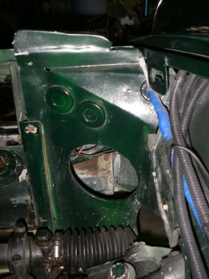

Re: Little Midget Update & Question
Excuse the poor condition of my car. It was never meant to be a show car, just a daily driver.
HA!! That's it...I don't have those 2 holes!! At least now I have a starting point.
Got a photo from behind the radiator, Trevor? Or can you get to it to make one?
Now I've gotta go remove the splash panel & duplicate the hole location in Trevor's....
Hey, trev....can you remove one of those plugs & tell me the diameter of the hole?
