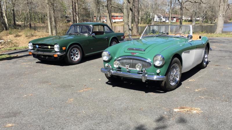

Big day for Lilly yesterday as she was officially accepted in the state of Delaware. she passed all her tests and recv'd her diploma. (well actually her registration and tags)
For a graduation present, i bought her a set of tires. So when we got home she went back on the lift until i can get these new tires on.
it is the shame. the tires on her probably don't have 500 miles on them. but the date code reads 1999. uuugh.
