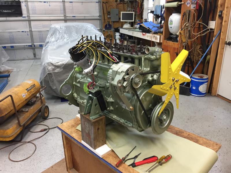

Today i wanted to test fit all the alternator parts and then get the engine off the engine stand.

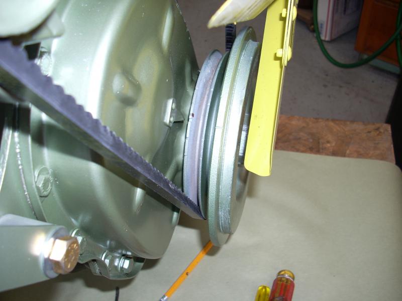

i can see where maybe the kit from Moss might be a little more stable than this kit. it seems the alternator wants to twist with any extra pulling in either direction. i think most people run their fan belt too tight so this may help insure i do not do that. it all lines up well and the belt fit just fine. NAPA XL7435. i did cut a notch in the old coil bracket so it would fit around the alternator plug. then i added 2" in length to it. Looks like it will work fine to hold the coil in the original position.
had some extra time so i thought i would get my plug wires installed in my cap. Got the wires made up from Tom's Import. Good thing i tried this now. i found that i had put the top part of the Diz in backwards and the rotor was 180* off at TDC. good i found that out now.... took it apart and flipped it and now it lines up. Should be good to go.
i was going to put the flywheel on and the clutch so i could get the tran and engine mated up and ready to go in the car. but since i ordered a rear main seal kit, i just put it up on this box so it is easy to work on.
While i am thinking about it.... what color should the fan be? is there a Rustoleum color? i tried to clean it but it just is not coming out. So i want to blast it and then repaint. IMG_2170.jpg

i thought i read somewhere that the gap between the two parts of the motor mount should be like 1/22 or something like that. As it sits right now, see pic, it is about 3/16. now i know the oil pan is closer than the rear motor mounts will be once it is in the car, but wondered if should get some shims now and build it down? or wait and let it settle some?

DD, I've used "Caterpillar Yellow" and "School Bus Yellow" to spray the fan (Original and Texas) - they're both bright colors. The color on your's is very close. The fan currently installed on mine is the same as your's but I chose to leave it "natural". I liked the polished vanes on the thing and it matches my DWR aluminum generator/alternator pulley/fan combo, also natural.
Consider checking your fan for interference; RPMs of >1500 flattens the vanes and they tend to push outwards by about 1/4 inch. GONZO

thanks for the fan tip. why do you use this fan instead of the Texas cooler fan? it seems no matter which fan i have looked at using, someone has had an issue with it breaking of blades coming off, or something.
Re: Lilly Engine up-date / couple of questions
Drone Dog--
The fan pictured in your post looks like the type sold by British Car Services (Nock) which is what I have had on my car for about 10 years.
I previously used a Texas Cooler type but found that after a few years of service the fan had taken a set so that the tips of the blades had moved forward of the plane of the hub. In other words, when the fan was placed horizontally on a flat surface with the front side of the fan facing down the blade tips would contact the surface and the center hub was about 1/2" clear of it. I am not an engineer but common sense told me that this change from the original shape was due to the fan's biting the air and that it probably diminished the fan's efficiency.
When I changed over to the Nock fan it gave better cooling and it has not distorted, though it required a bit of grinding to fit over the large hub of the 100's water pump pulley.
The new motor mounts--at least the ones I've bought recently--are pee-poor repops. Set up without shims--which I was not able to locate from the usual suspects--the gap is too large as you describe and, as the engine settles on the lower part of the mount the rubber is placed under shear forces, which can lead to the rubber separating from the backing plate. I closed the gap using a stack of large fender washers; since I didn't know how much settling would occur until the engine was in place--and I wasn't willing to pull/replace the drivetrain just to install these improvised shims--I cut slots in the washers so they would slide past the stud that holds the top part of the mount.
i have some shims i bought from HF. you can get a case of them for 10 bucks i think and they have a number of thicknesses. they are about the size of a fender washer with a slot cut in them. i do think i will wait until the motor is in. the mounts are original so i have to assume it is just that the full weight they will bear is not on them yet.
