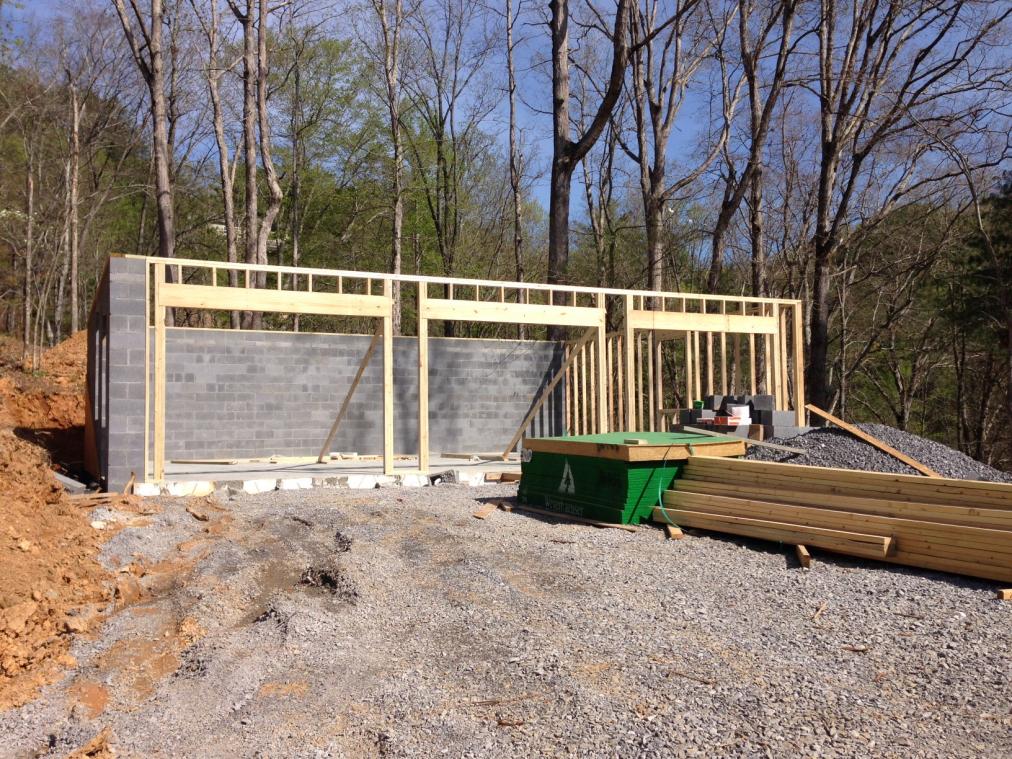

Update - walls are up! Trusses and roof supposed to go on today!
