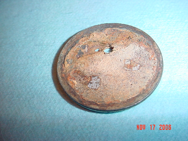

Since the thin, cheap metal plugs are subject to rust/corrosion damage they are often the first thing to fail on a higher mileage engine. Attached is a pic of a failed plug. There is rust scale on it , a hole to the right that was drilled to facilitate removal of the plug via sheetmetal screw, & a tiny but deep hole slightly to the left that corroded all the way through & caused a leak. In this case, it appears that the hole may have started from a tiny flaw in the plugs galvanized surface.
As you know, they sometimes just pop out as they weaken from corrosion damage, or other problems.

Yeah Dave, They got the name "Freeze Plugs" because they are suppose to pop out if water freezes in the block as Big 6 Says. However, I have no experience with them performing that function satisfactorily. Similarly, I fail to see how a very thin plug due to corrosion which is not leaking can be diagnosed with Preventative maintenance and it will blow on the road if pressure is built up in the block.---Keoke
