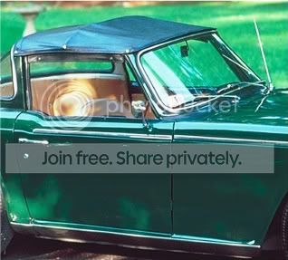

UPDATE ON THE TITANIC:
After numerous rains and lots of towel drying I finally went out got in the car and had my wife soak it with the hose. There are no leaks in the foot area underneath the dash on either side. All the water came in at the front corners of where the door glass goes up to the surrey hardtop. It was just like two funnels with the water coming in. Needless to say, the front seal on the surrey will have to be replaced with a better seal than the one it came with.
Hi Terry! As you know the Surrey top was only offered on the TR4, 4A and 250. I was wondering, does the windscreen on a TR6 have any differences in design that would prevent the Surrey Top from fitting properly? Do both the soft top and hard top leak?
I replaced all of the seals about 3 years ago. Got them from TRF, if memory serves.

I have a friend that has a TR4A with the surrey top. After looking at his front windscreen, I think Triumph used the same one on the TR6. When I went to the surrey, I replaced the windshield capping with the one used on the TR4 that is used for surreys. It fit perfect, even the predrilled holes on the capping lined up with my windscreen. I purchased the surrey off of ebay and installed the seal that came with it. I will have to check the one that TRF sells and see if its any better. I noticed the water comes in right at the ends of the windscreen capping.
