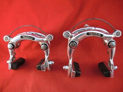

700C wheels have a bead-seat diameter of 622mm, for 27" it's 630mm. 8mm difference in diameter is 4mm radius, so if you put 700C wheels on a frame designed for 27" the brake needs to reach 4mm further -- less than 1/4 inch.

That's right, but sometimes...
Once upon a time, don't even remember what bike it was, I installed 700c wheels and found the brake pads were already at their lowest position but didn't reach. I had to swap out the calipers for ones with longer arms.
But yeah, it was more commonly like I had with my first "10-speed" bike, a Peugeot. It originally came with 27" steel clincher rims. I re-laced the hubs with 700c tubular rims and the MAFAC center-pull brakes just needed to be adjusted a little.

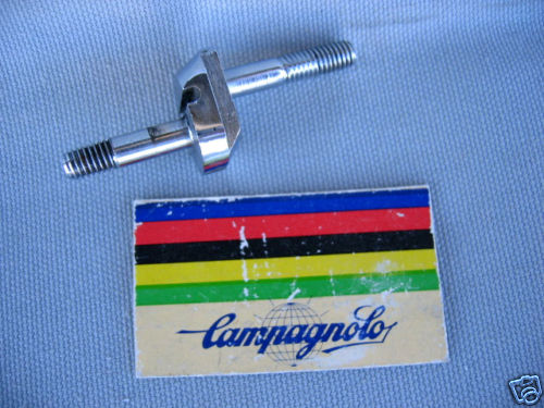

That 4mm difference can create brake pad centering problems when switching from 27" to 700c wheelsets. Options then include "drop" center bolts or long reach calipers.

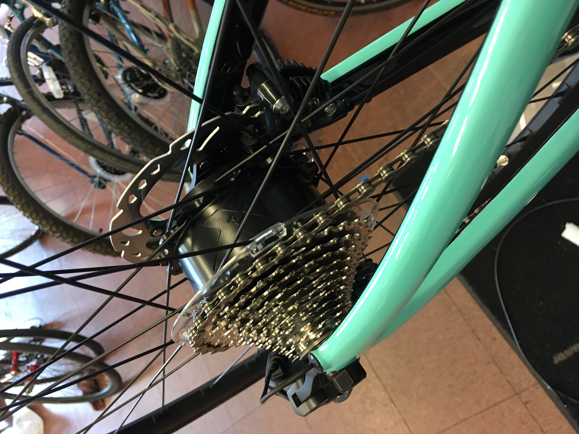

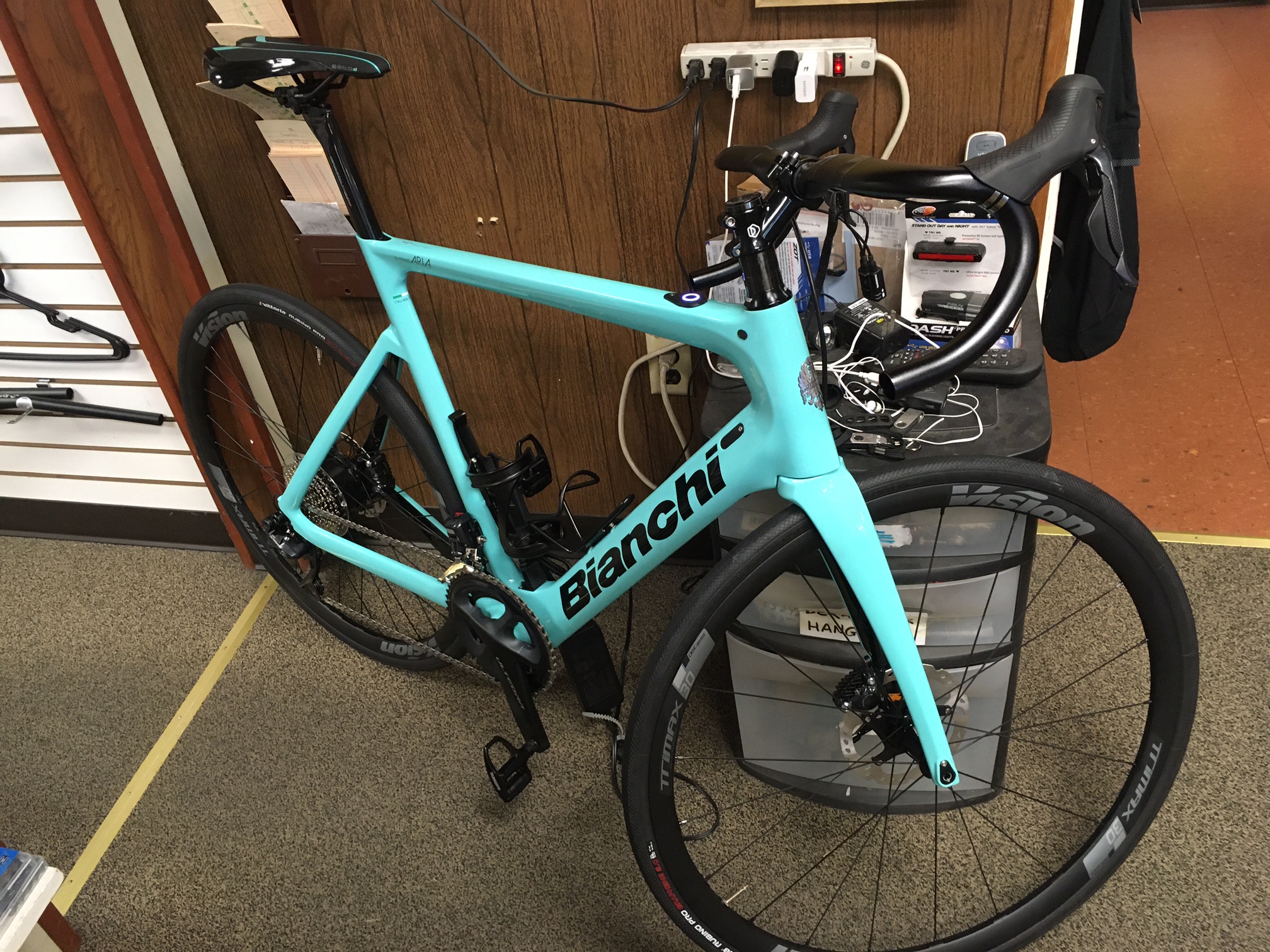

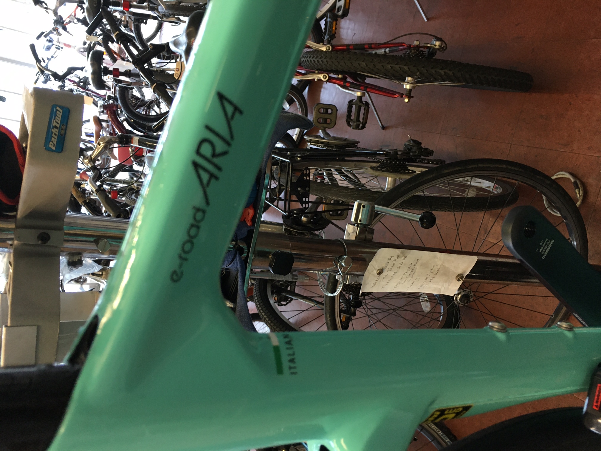

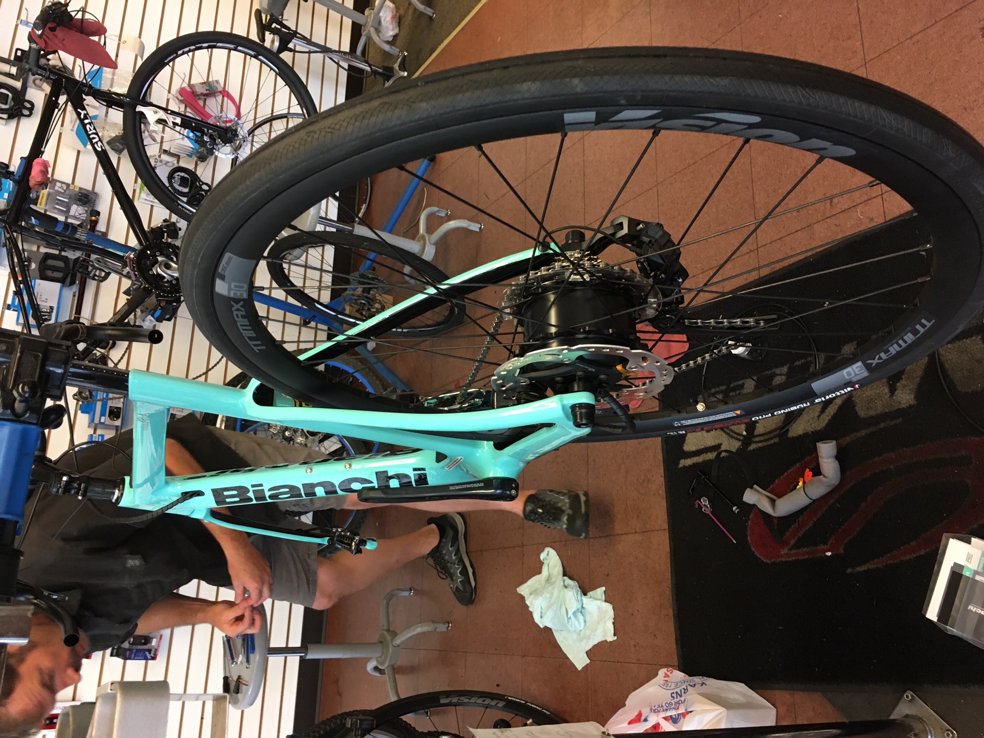

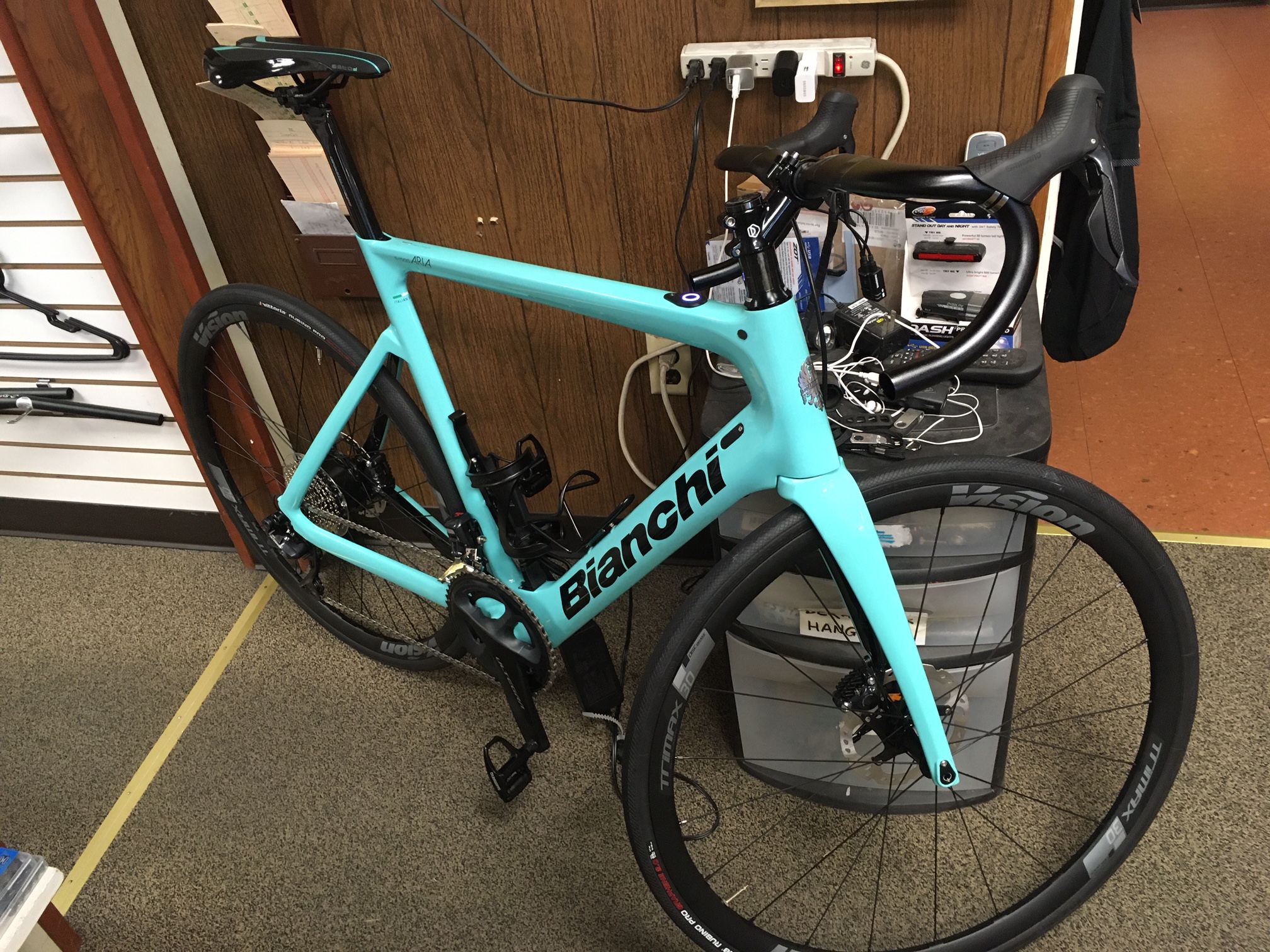

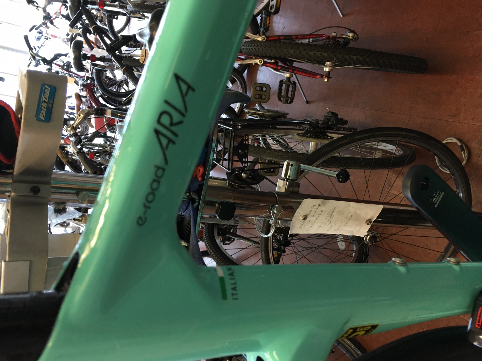

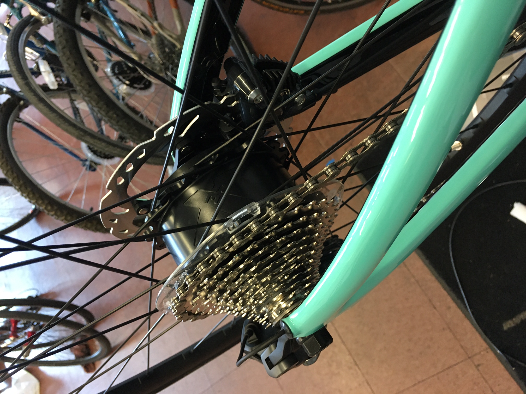

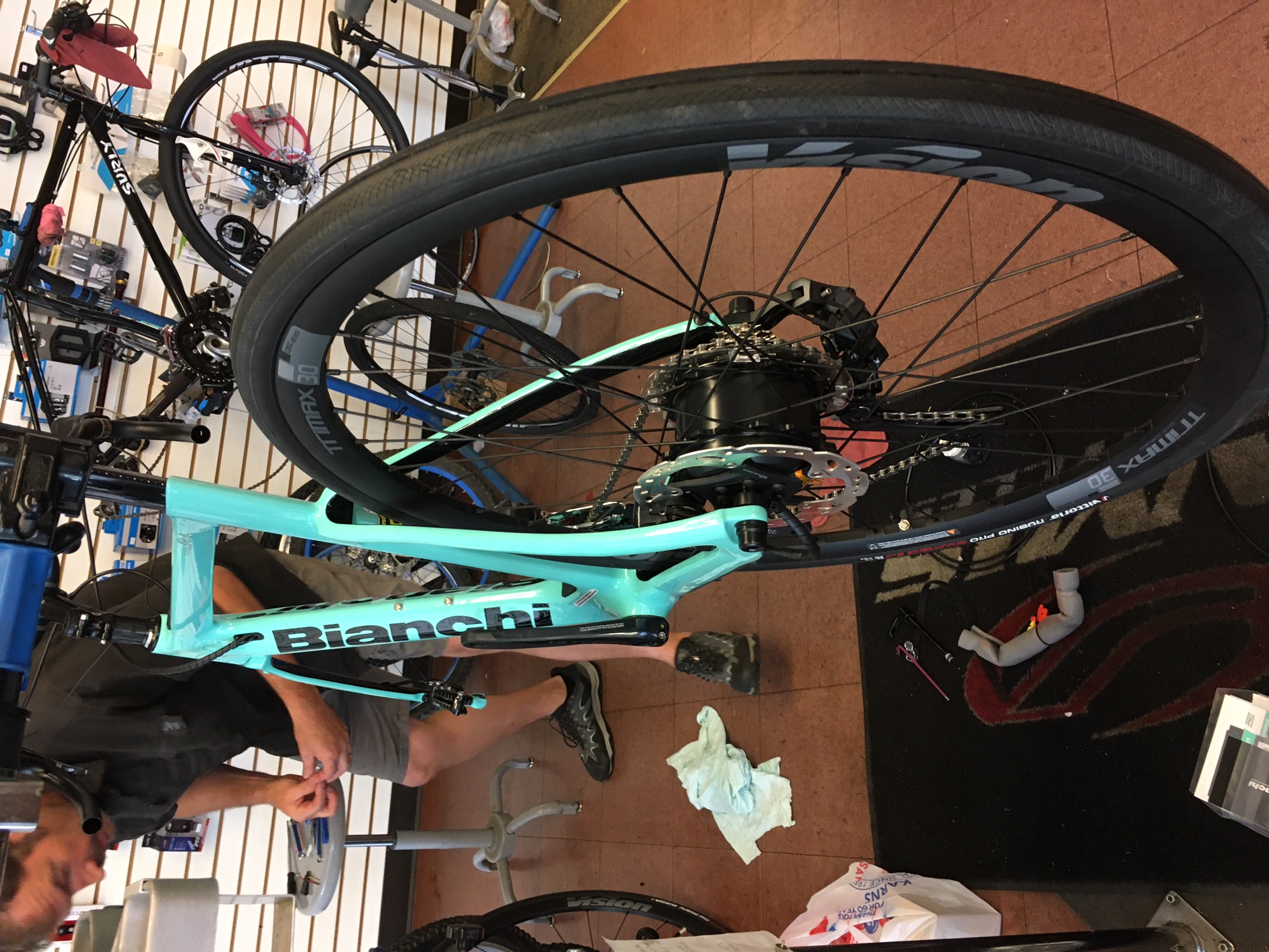

Here's the shop's latest project...not one, but a pair of Bianchi e-road Aria's. Electric powered rear hub, Ultegra Electronic Groupset. Cutting edge beauty...Customers are picking them up tomorrow.
Wow, those are sweet! I could do without the electric part, but the bikes look really nice. (Aside - my Granddaughter's name is Aria)

That bike looks sweet but I'm not ready for electric just yet. I had a look at my Bianchi yesterday for the first time since my accident... the front wheel is bent and the handlebar is out of alignment; haven't looked at the shifter yet.

I've never seen that many gears before.Those bike must be $200 - $300 each.
X10 and you’ll be closer but still on the low side.
70herald
Try x20... of the high end estimate...
Not quite sure I understand the idea of a carbon framed e-bike. Once you have battery assist the difference in weight between carbon and Al isn't going to make a difference.
