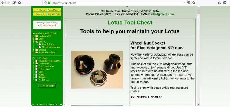

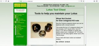

In addition to that I lose things. Here's one I'd be afraid to lose:
I will stick with Randall's suggestion.
