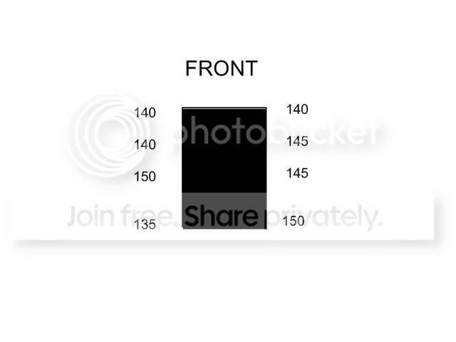

Well did my Compression test today.
Interesting note. On 2 occasions I heard a loud wack that was most definitely metal to metal
Looks OK to me. Now what
