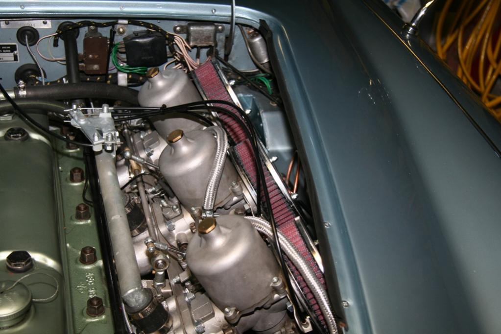

I've been looking for a long time for an aftermarket air filter for my BJ8 and the below link is the only one I've been able to find. Just so happens it appears to add performance and some good benefits when working on your carbs. I have contacted the company about a month ago and they are in stock and I will most likely buy one, about $160.00 USD. They do stock replacement filters too. Something about the BJ8's that companies don't want to come up with a system for them but do on the other big Healey's.

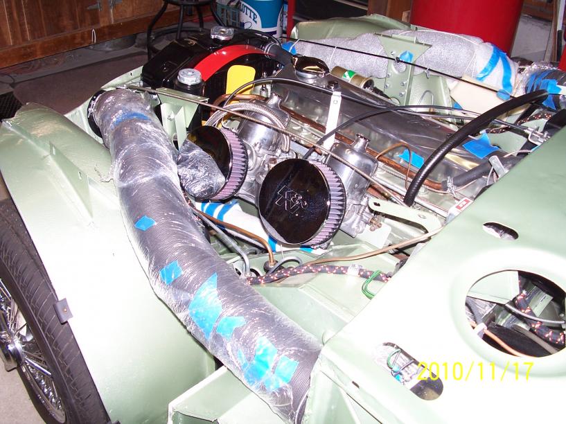

This is what I used. K&N

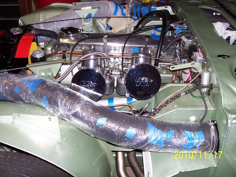

When I converted my BJ8 to 3xHD8 I bought three K&N 56-9242 blanks, was just enough room for these. For a standard BJ8 installation I would check if there are room for slightly higher filter.

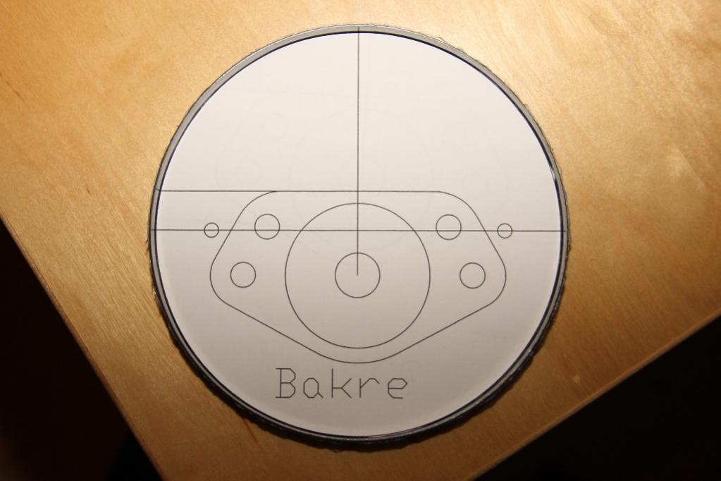

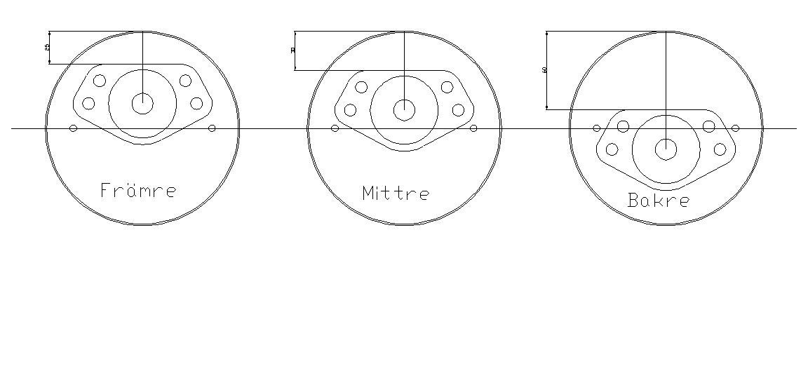

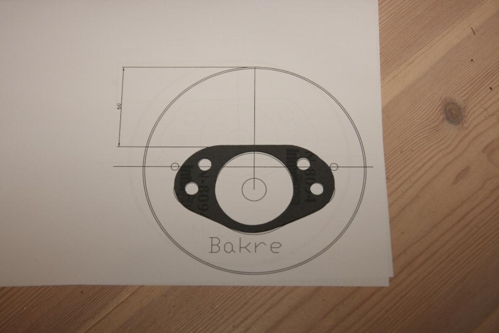

I made three drawings in scale 1:1 (three offsets used) which I glued inside the end plate using the 2 holes for the studs as reference. Holding it against a light source makes it quite easy to position the drawings. Easy to mark and drill the holes, then use a hole cutter for the intake hole. Used a Q.Max sheet metal punch hole punch diameter 52 mm.
Make sure there are no interference between the screws for the studs inside filter and the carburetor (I changed these screws to insex). Using a gasket for the filter as reference makes it quite simple to check clearance.
