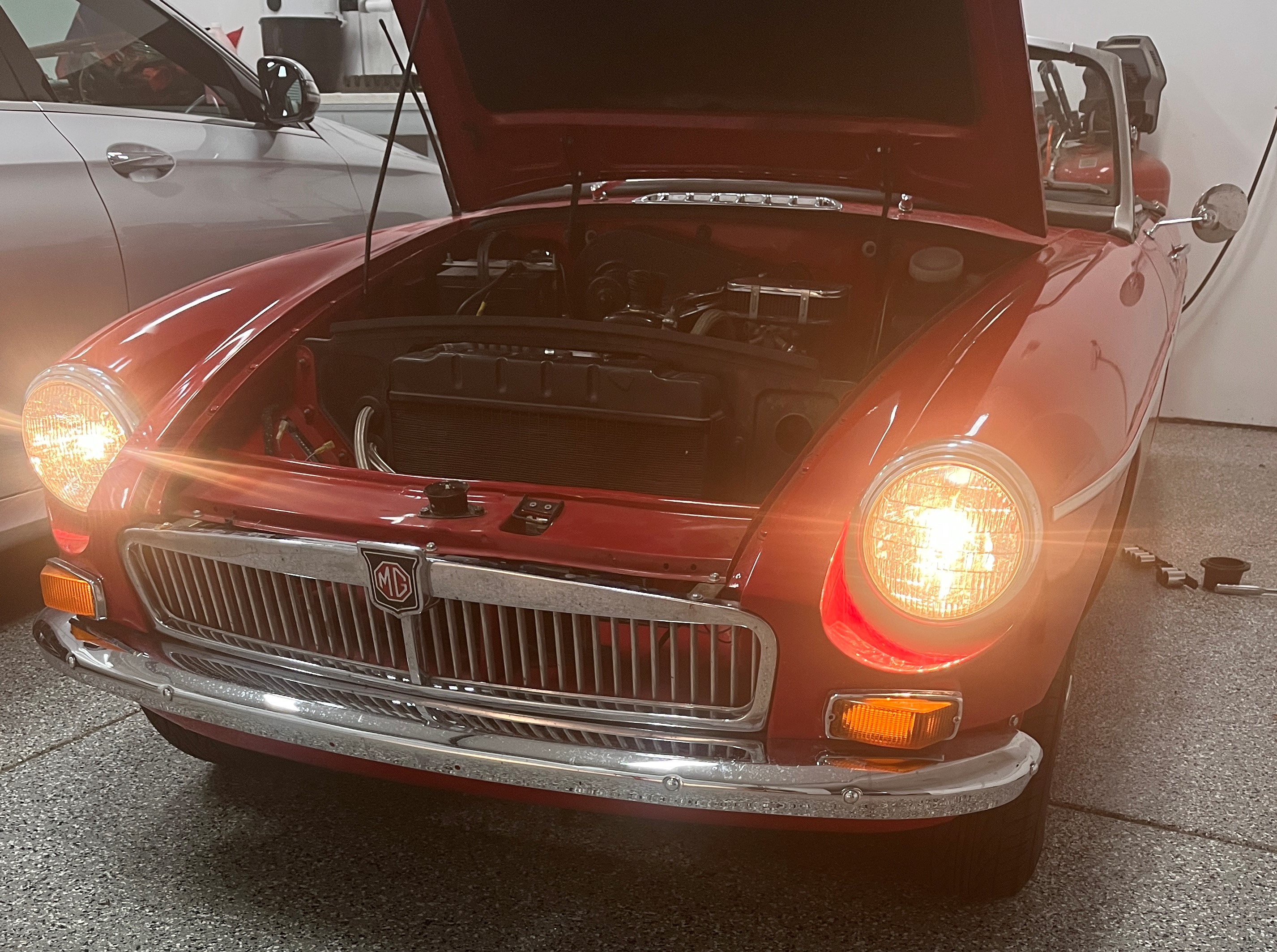

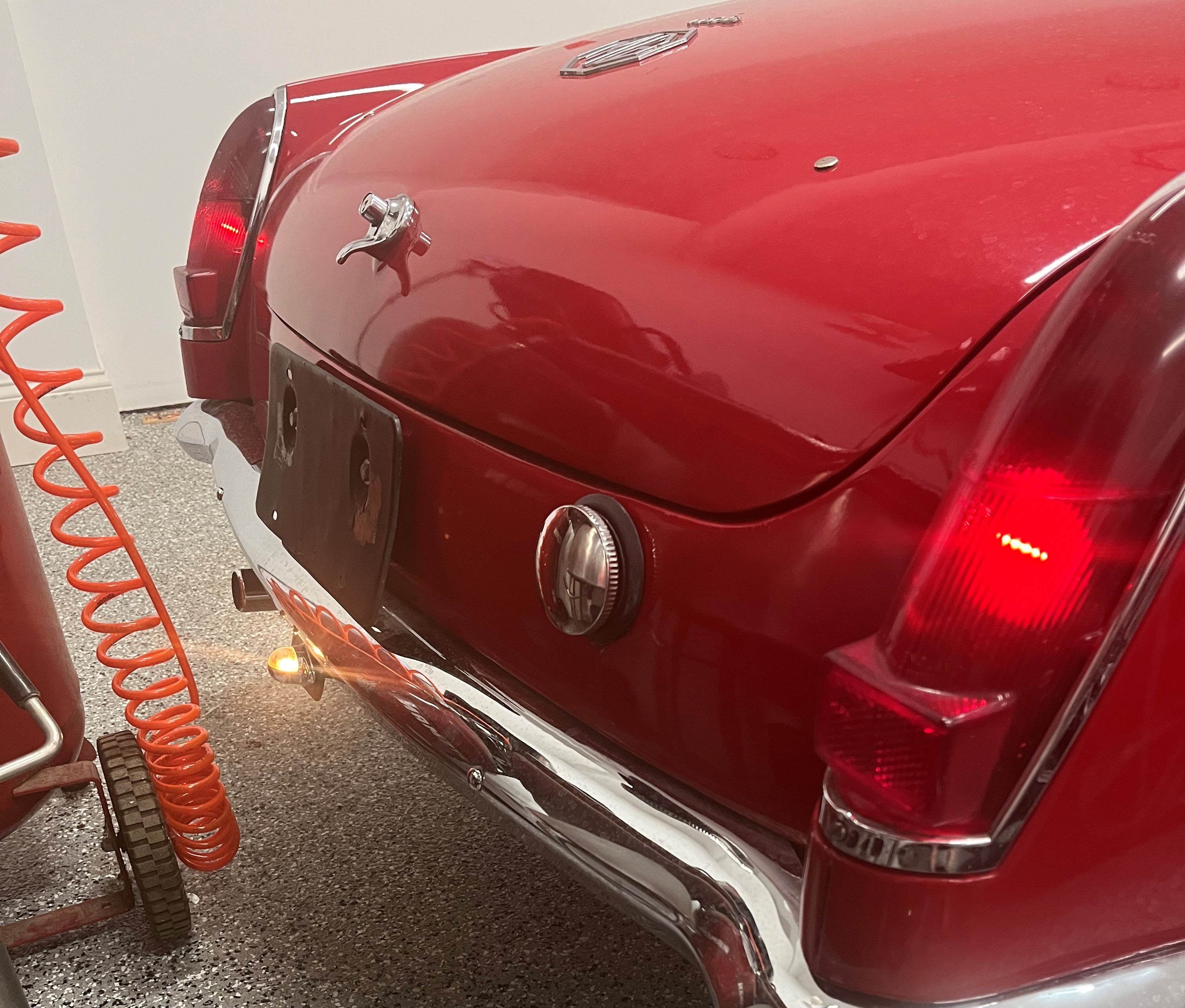

The 1966 MGB has been converted to a negative ground, with an alternator.
My first issue of concern:
The turning signals do not work. The head lights, tail lights and running lights in front illuminate, the switch on the steering column has been replaced, none of the interior lights work.
I removed the interior light bulbs, they tested OK. I would like to replace all of the lights with LED.
Please help me trouble shoot the turning signals.
Thanks,
John
Chicago

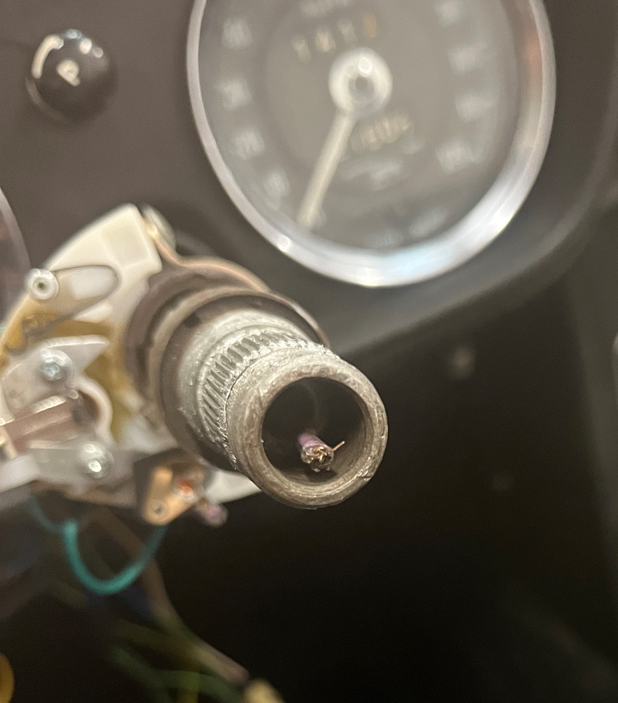

My second priority is:
The horns do not work, the wires are marked but disconnected. When I test the wires at the horns, there is always 12v power, this must be wrong.
I tested the horns with a 12v battery and they work.
I pulled the steering wheel and there was an bad wire connection. The purple wire is too short inside of the steering column to make a proper connection to the horn switch. I will probably have to pull the purple wire back under the dash and splice in a new piece to give me the proper length.
What are my best option to fix the horns?
Thanks,
John
Chicago

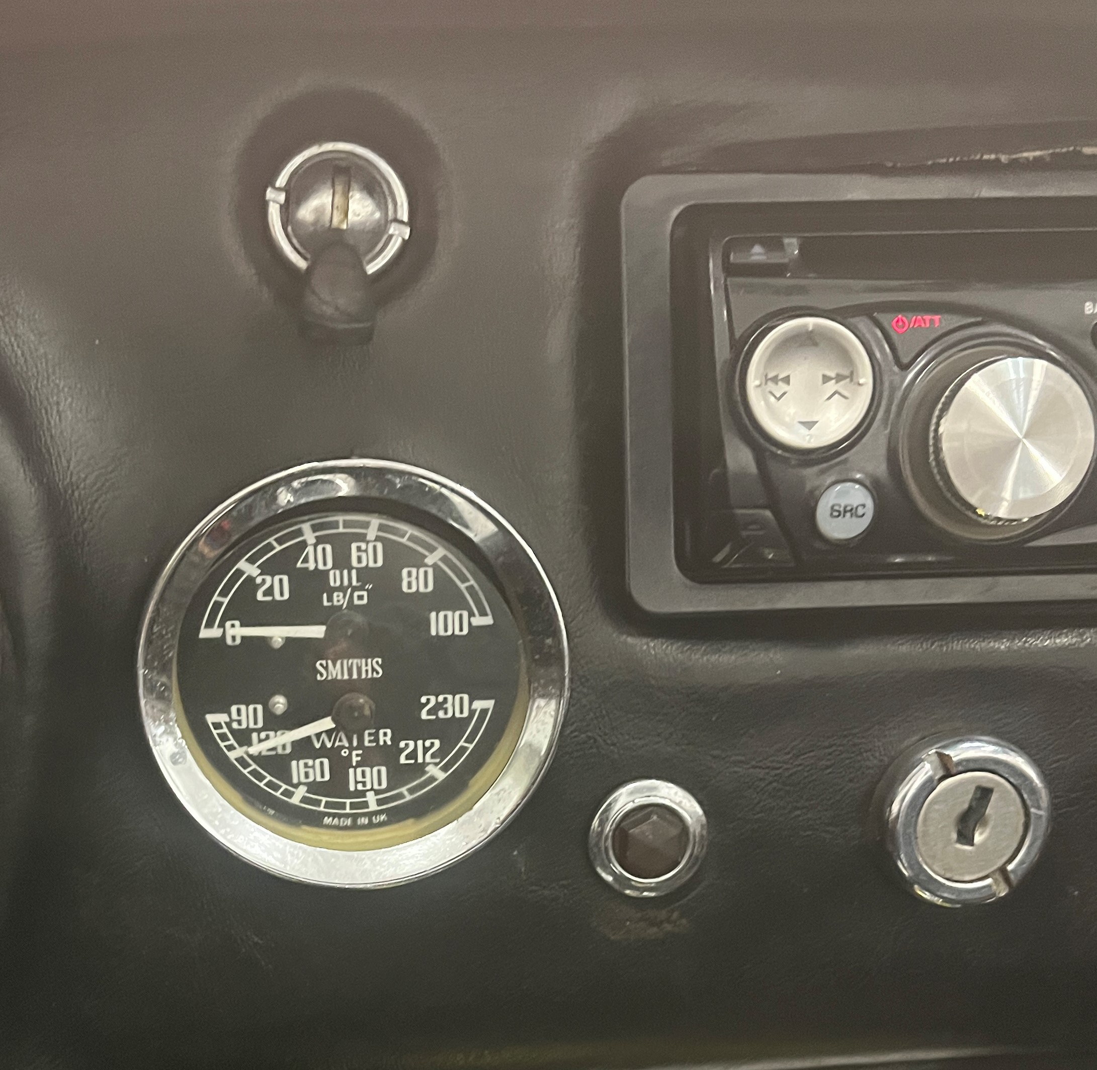

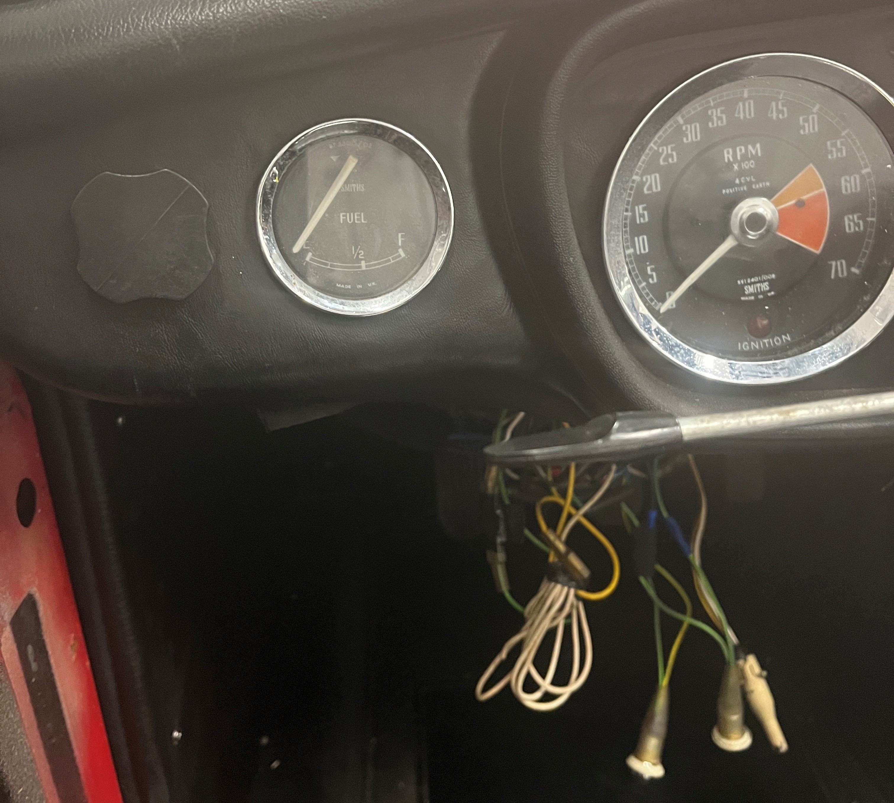

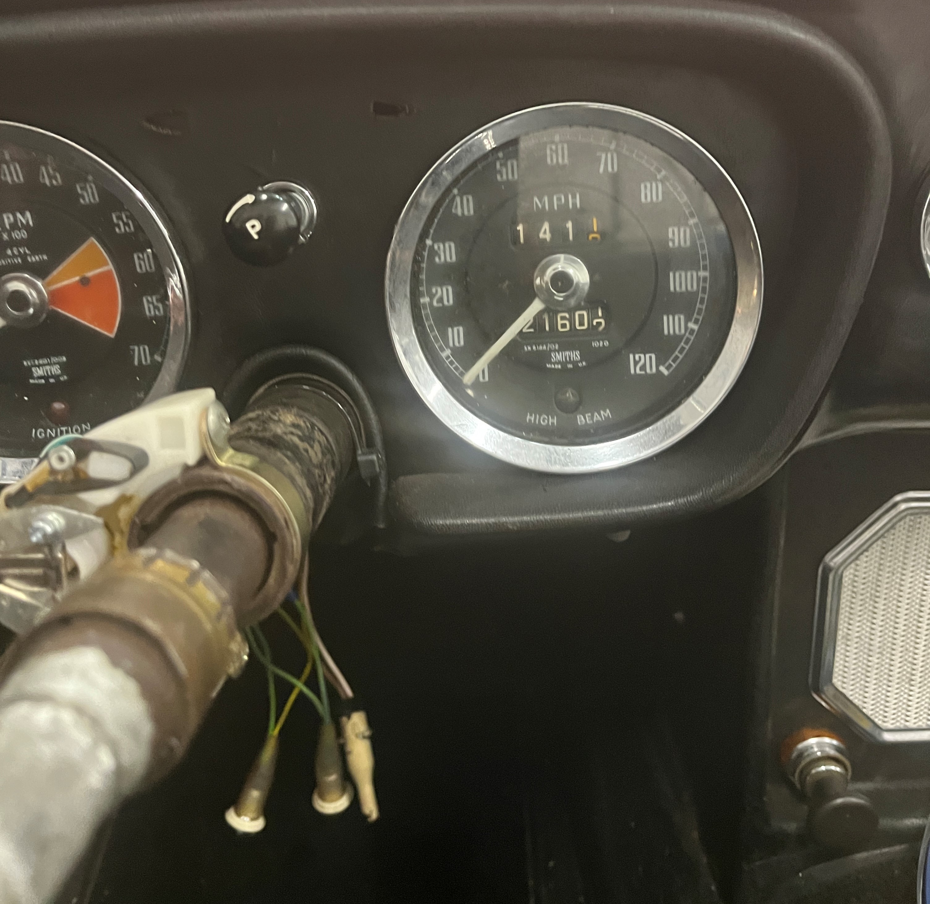

Another priority are the electronic gauges:
Fuel gauge and odometer work.
Speedometer jumps around, hopefully a clean and lube will help.
The tachometer, oil pressure and water temperature gauges do not move.
Where should I start with the gauges?
Thanks,
John
Chicago

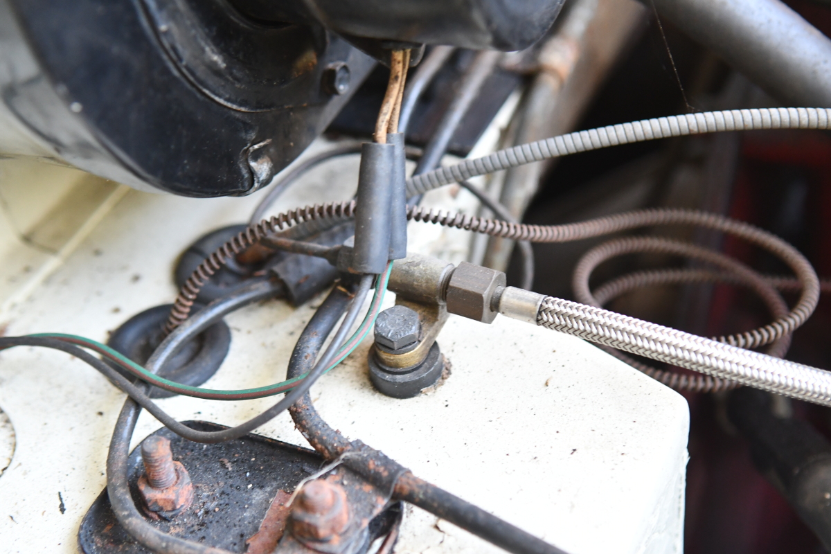

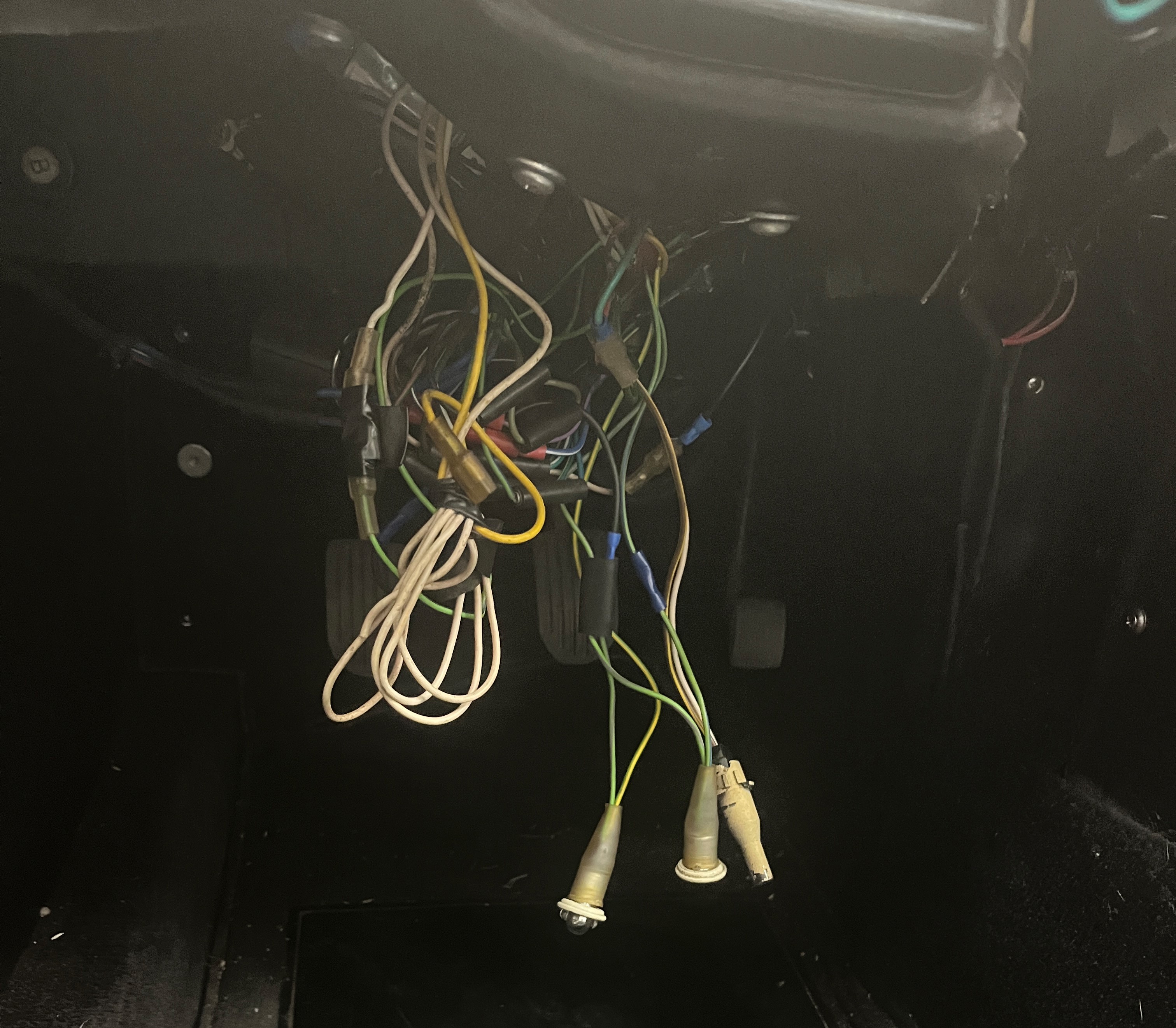

The dual OP/temp gauge is mechanical, an ether bulb (expanding gas) for temp and a copper pipette from engine to gauge for oil pressure. Only has an electrical connection for an illuminating bulb. All dash lights are (or should be) on red/white stripe wires. Solid red to rheostat for power, out from that to instruments.

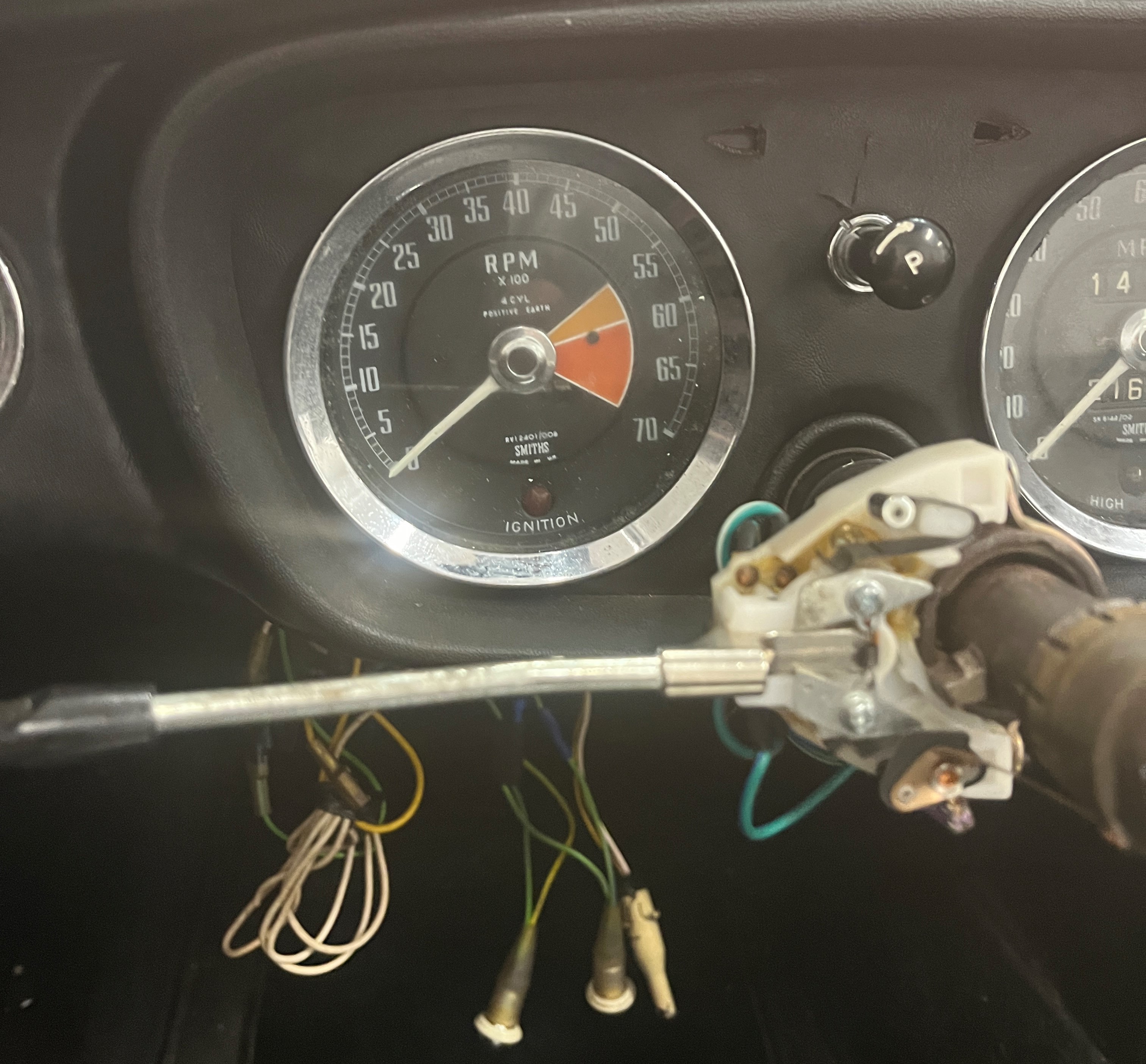

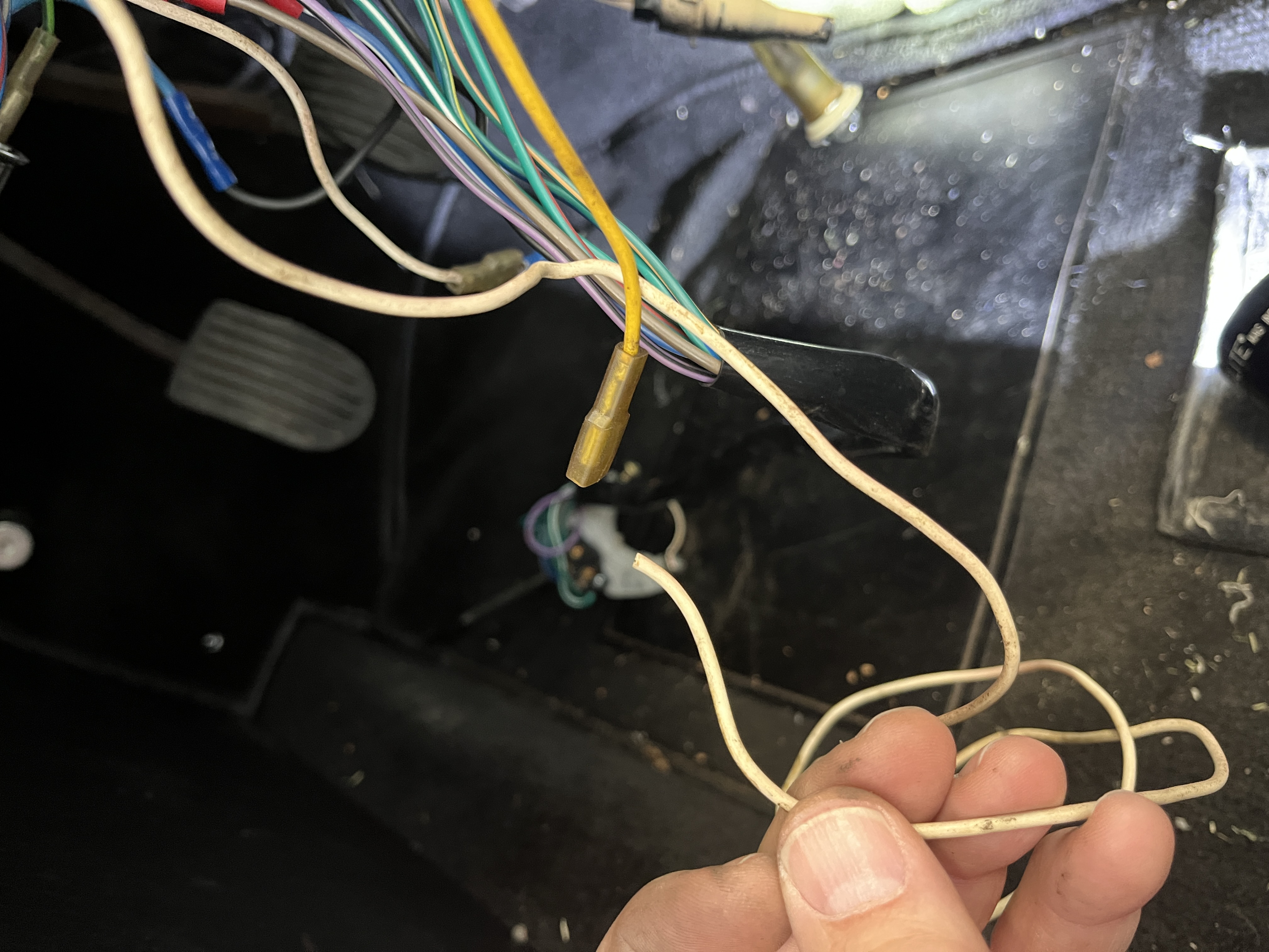

That cluster of dangling wires should be for the tach. It needs a couple slight mods to work accurately with a negative ground setup, not difficult. The white wire is the ignition from the switch to the coil, the tach works on induction pulse from that. The yellow wire is an "extra" circuit for an overdrive apparently not in your car, with the switch mounted in the opening to the left of the fuel gauge when fitted.
There are a lot of loose wires in this car.
I need a little more help to make sure that I understand. I do not have overdrive, is the "plug" normal or is there something else that should be there?
are you saying the tach wire should be connected to the white wire?
Thanks
Is the rheostat the "P" knob between the tach and speedo?
What is the mechanical connection for the temp and pressure?
Have a look at the wiring diagram. The white wire should have a small loop around a plastic holder which is held to the back of the tach with a small metal "horseshoe" clip. For an induction pulse, not direct connection. That plug is something someone used to cover the hole for a switch if overdrive was installed. Otherwise the hole had a metal plug fitted.

Yep. "P" is for panel... the instrument lights.

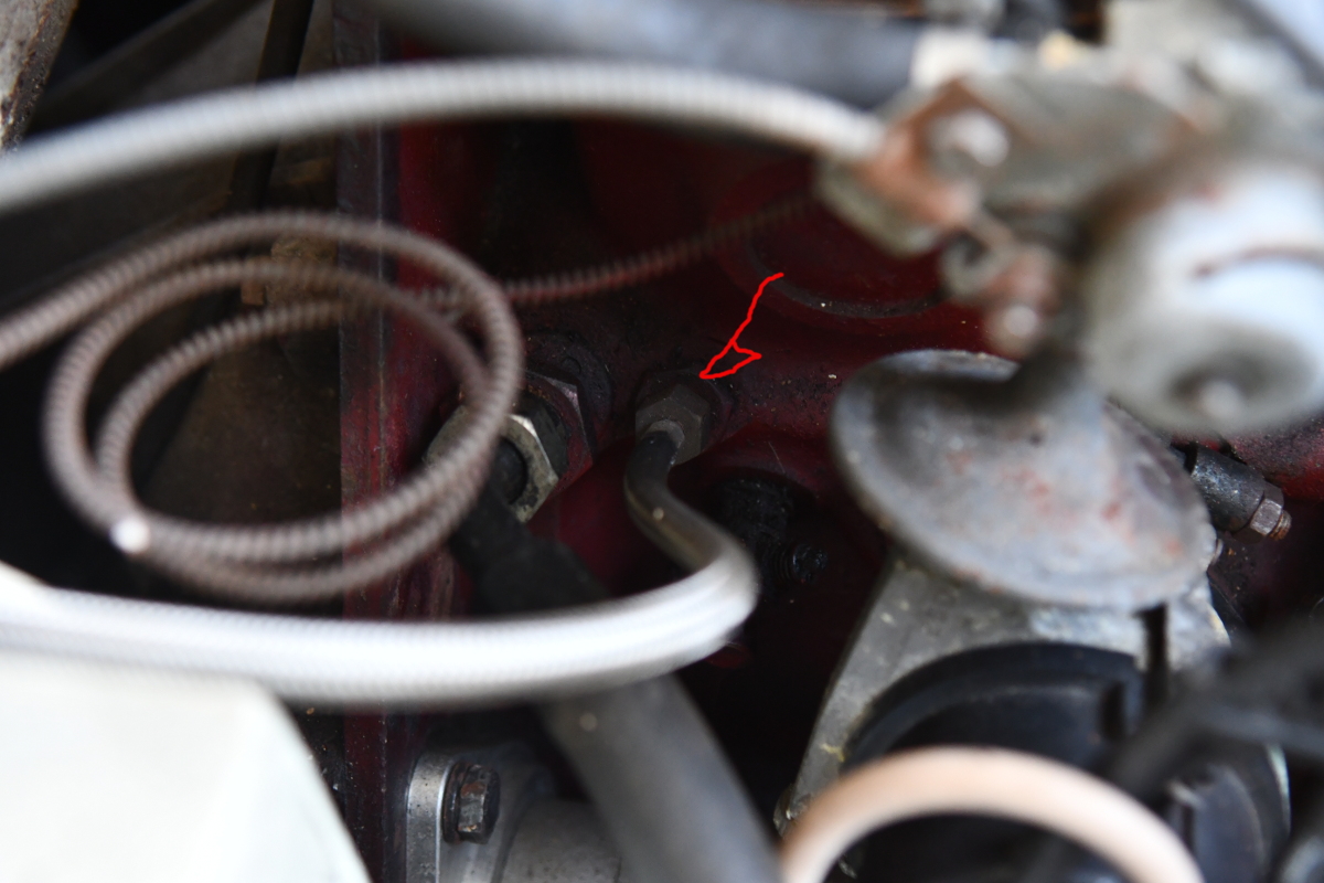

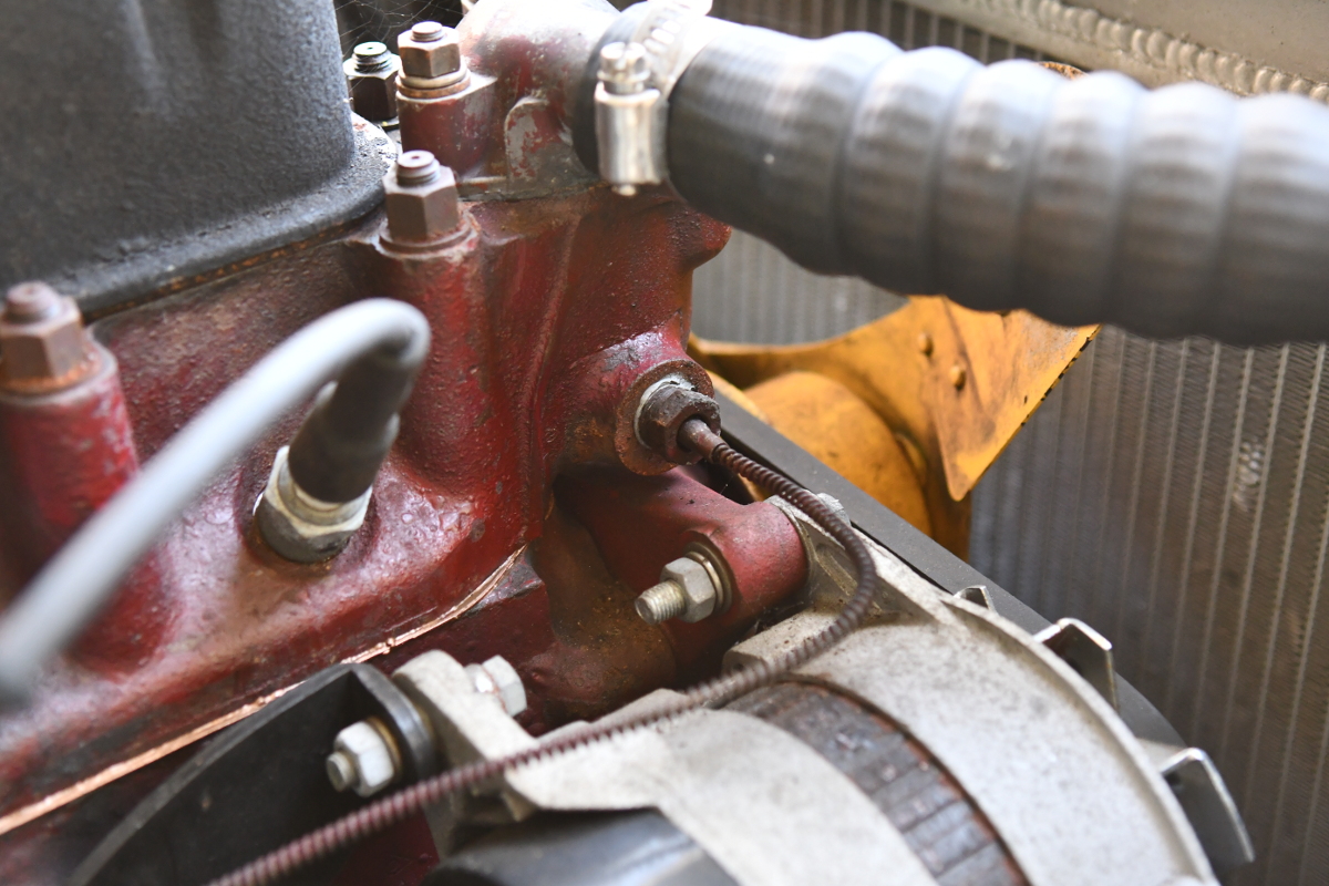

The temp and OP lines are routed thru the firewall to the engine compartment, yours are likely cut or not connected. Too many jackleg "mechanics" have no idea what they're doing, or consider it too much trouble to do it correctly. Some photos coming in a bit.

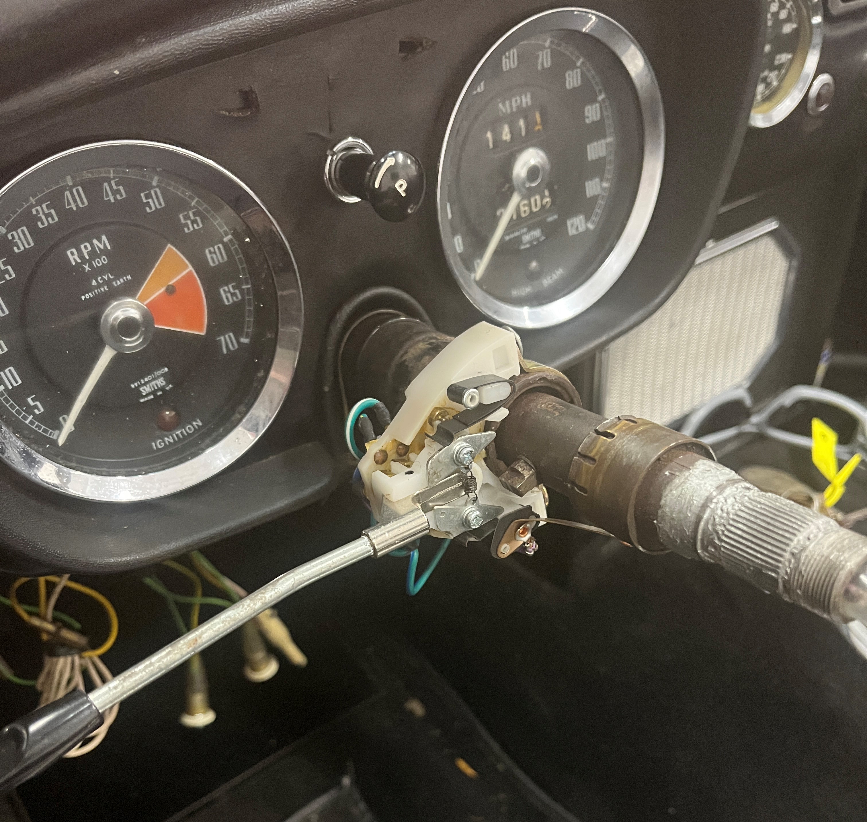

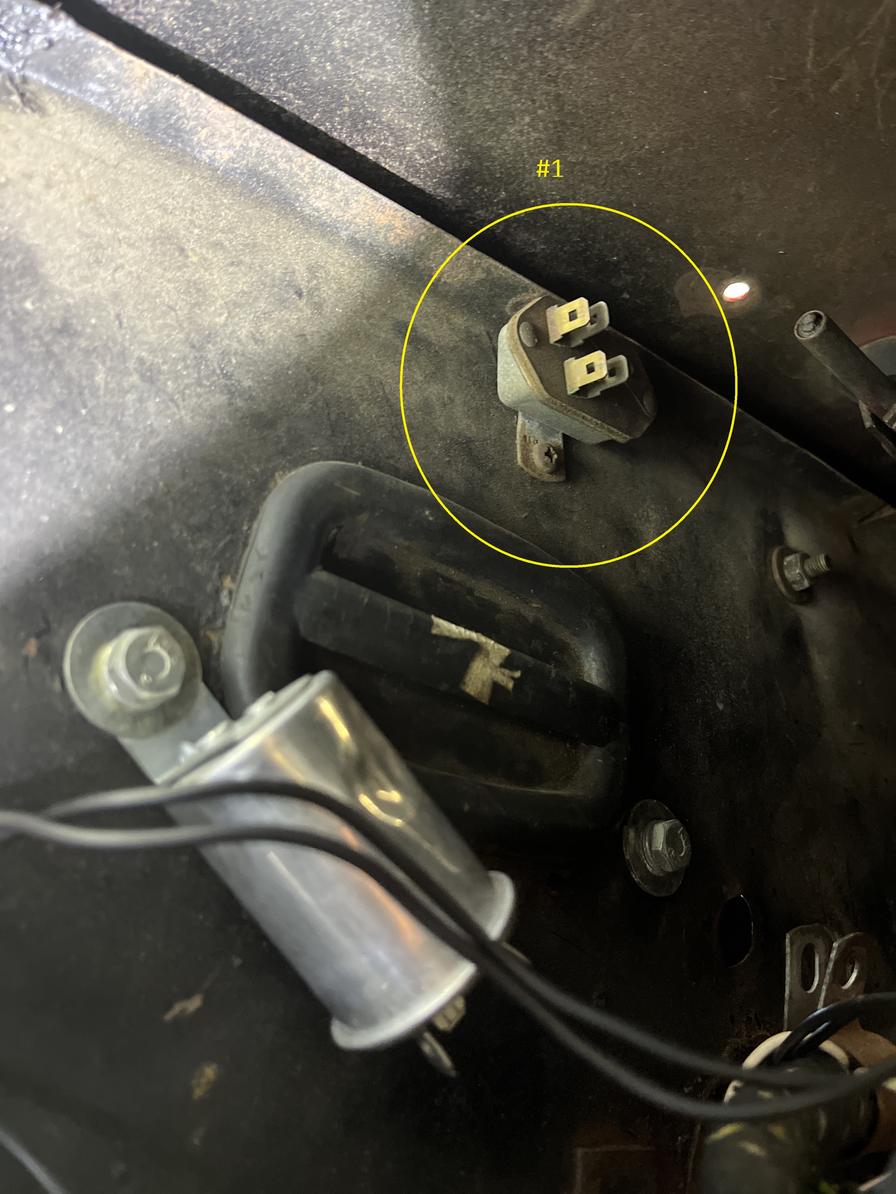

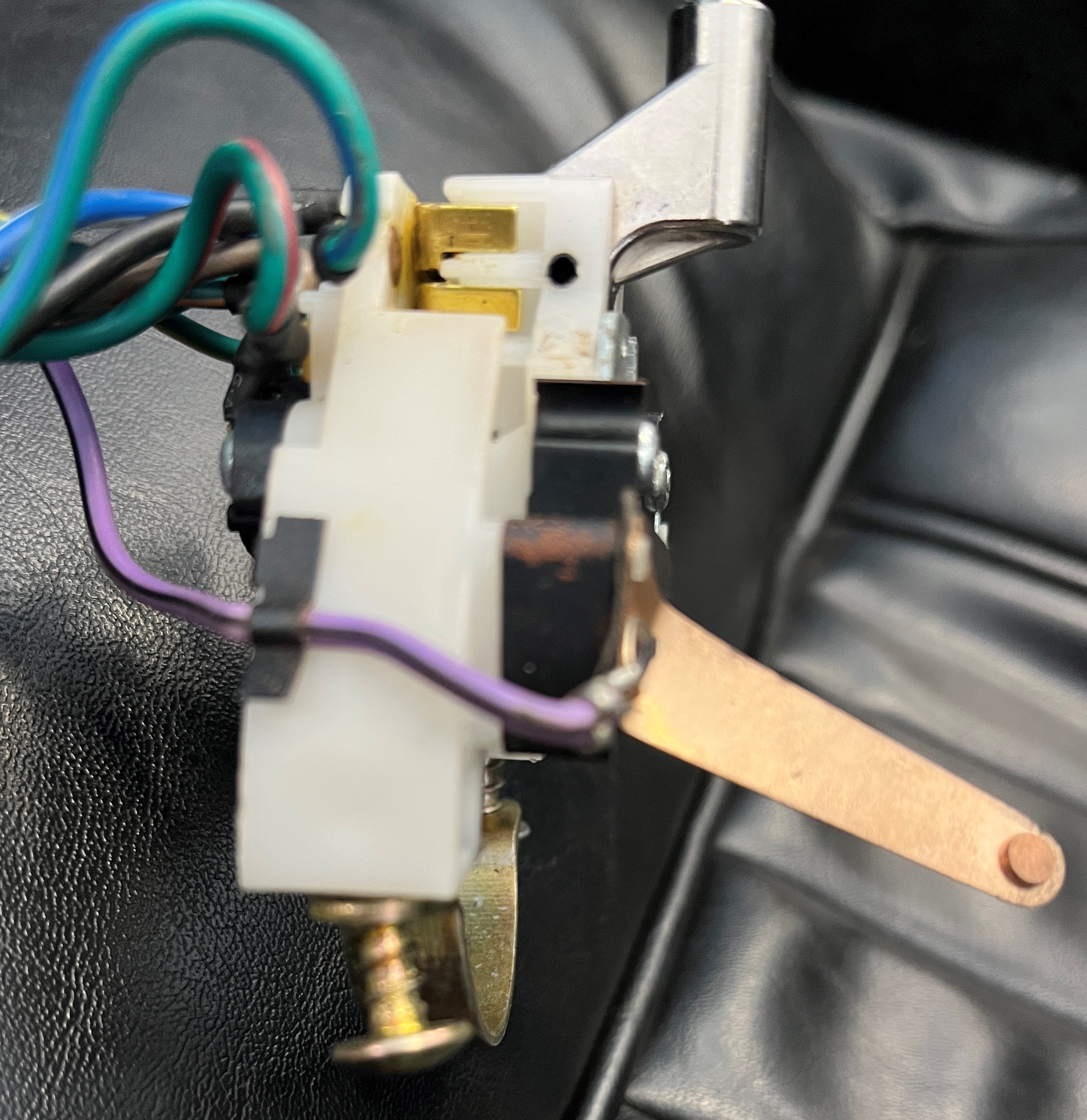

I found a purple/ black in the turning signal switch harness, but it runs into the "loom" and under the hood I would think. I cannot find the other end of the one in the steering column, or is it soldered into the column and the brush connects it to the car?
I found the white and yellow wires.
What is the block?

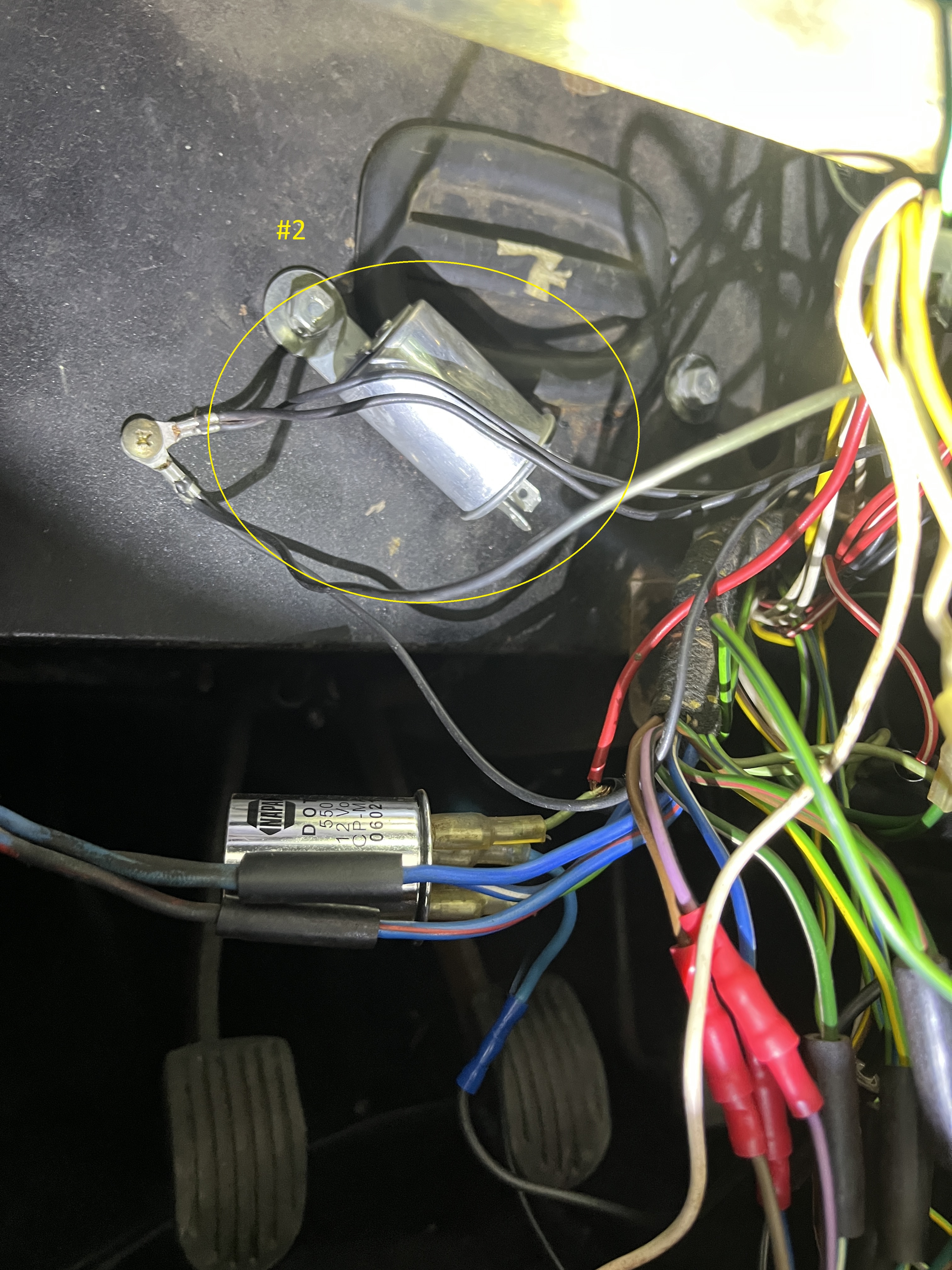

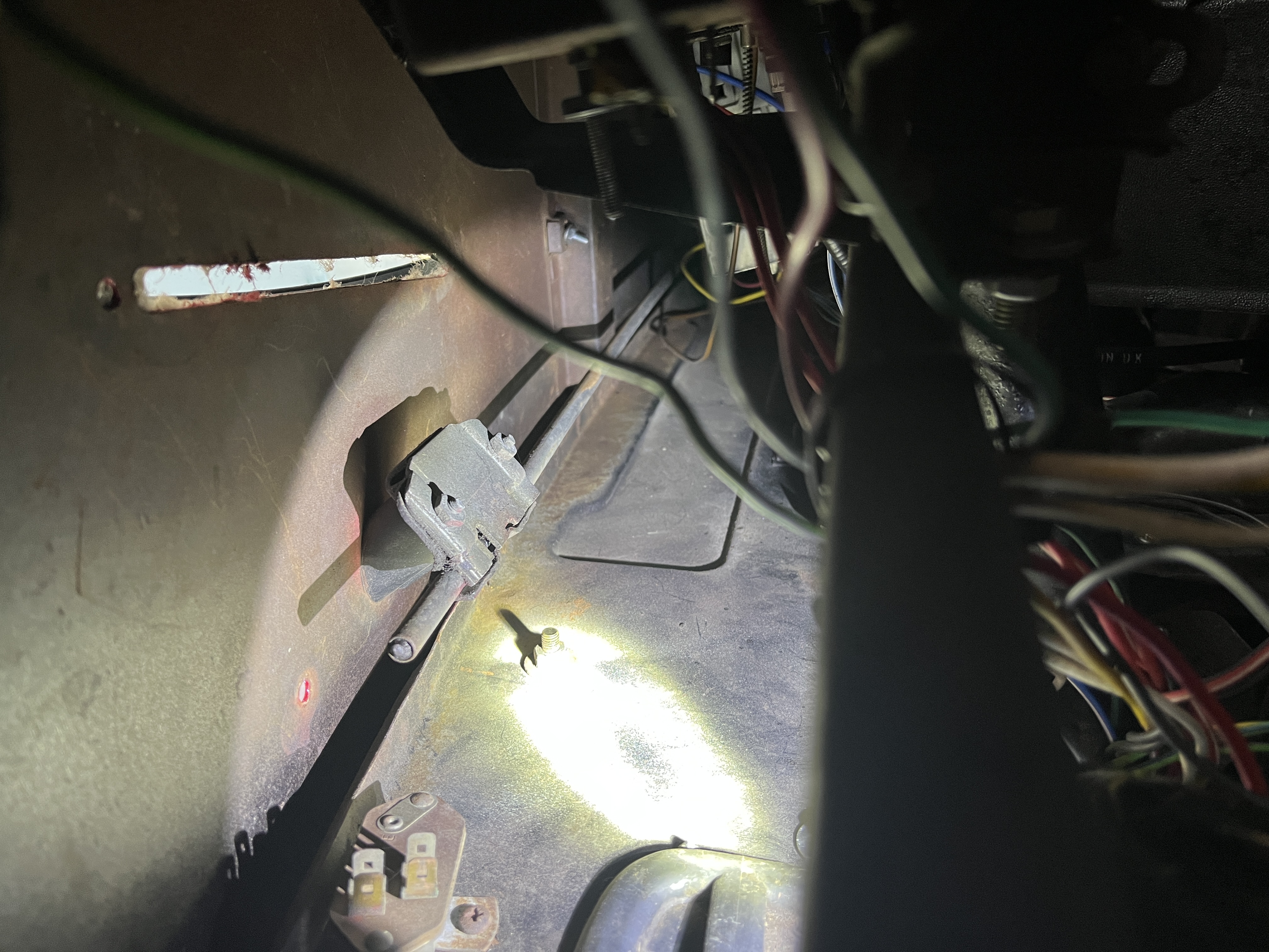

It looks like one of the flashers is disconnected.

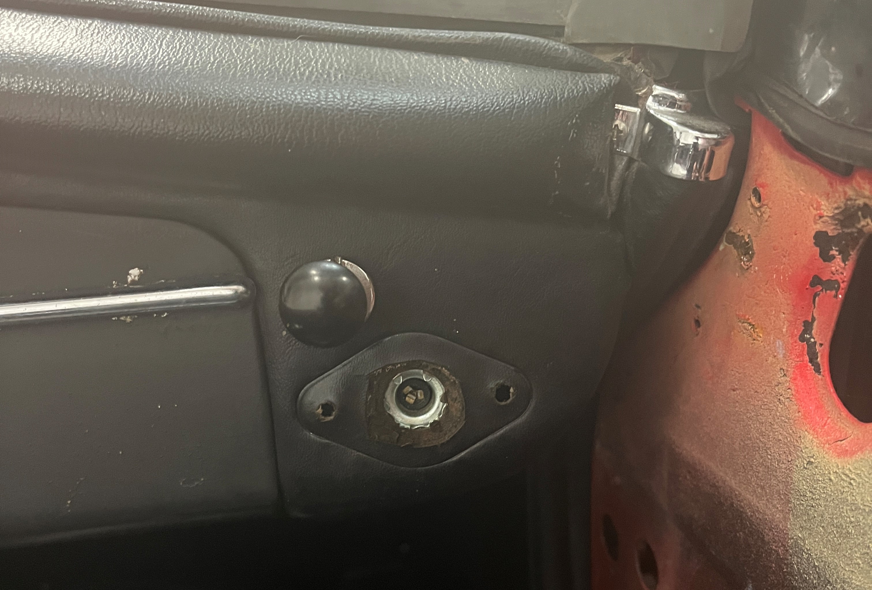

What is the :mount" thing behind the stereo?
Thanks,
John

The capillary tube (coiled with protective wire) and OP lines from under dash to engine:
The OP line is aftermarket braided, this is source point for OP gauge:
Water temp ether "bulb" directly into thermostat housing:
