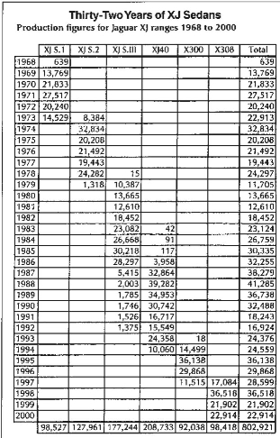

Exotexs
according to Jaguar World Magazine XJ Production Figures Chart, (c) JWM, 10,060 XJ-40 were made in 1994, and 14,499 X300 were also made in 1994.
See the attached file where it shows the XJ production from 1968 through 2000. Note that this chart does not say how many 12 cylinder XJ were made, only 'Saloons' or Sedans in both versions. Also, this Chart does not say how many LHD or RHD cars were made, the totals shown are the Total Production by the factory.
