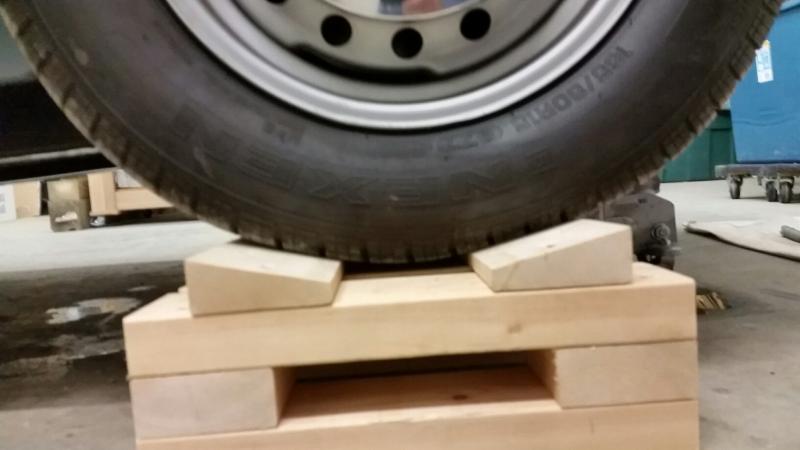

Tried your idea and it works great! I added a slight modification that might be of interest. I added a 15 degree bevel on the two cross members that support the tires and spaced them 4 inches apart. Here's a photo...
Rick,
Thanks for posting that mod. Looks like it will eliminate any chance of a roll off.
i'm going to cut mine 15 dg. also.
