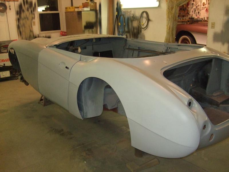

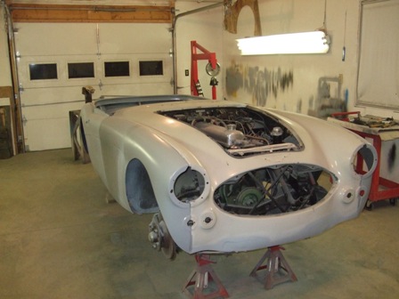

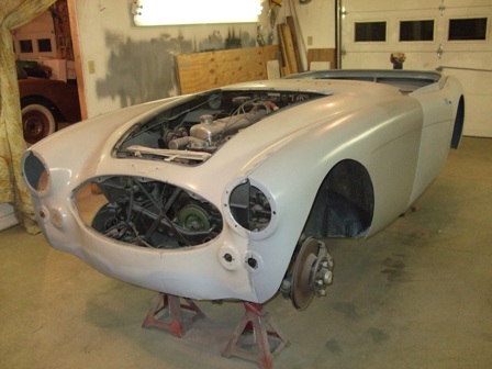

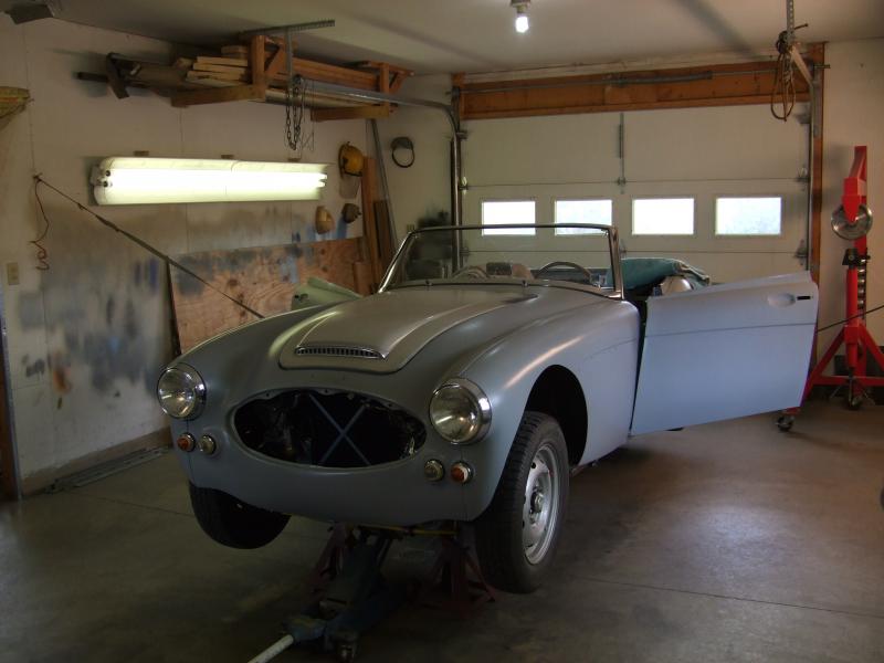

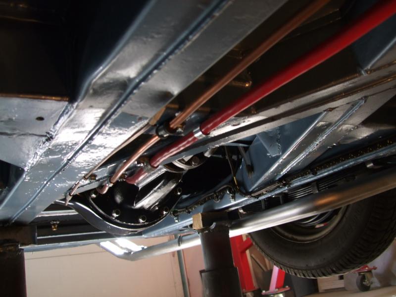

I'll just re-enforce what has already been said. Jack up the back first with a walker undercar jack under the pumpkin. Put a heavy rag on the jack pad to not scratch the pumpkin. Put jack stands under the frame rails about in line with the rear axle. Use a piece of plywood about 3" square between the jackstand and the frame rail. This will help from marking the frame and also help to keep things from slipping around. Put a 2x4 wood under your front crossmember all the way from under one frame rail to the other frame rail. Jack up front with the same jack on the wood. Put Jack stands under the frame rails just behind the wood piece that is across the crossmember. Use small pieces of plywood here as well. Here's some pic that might help to see it.

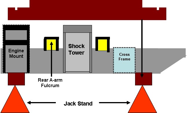

Take a look at the supports I created when working on the frame quite a while ago. These wooden supports allowed for the frame to be raised and held without causing any deformation during the raised by jack or maintained with jack stands. I also used a straight board under each end of the rear cross member in concert with these 2 front supports.
Hope it helps,
