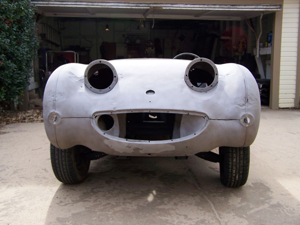

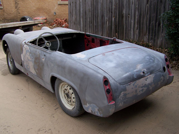

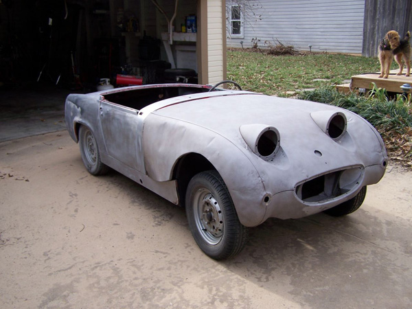

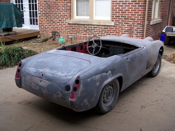

Got the bonnet media blasted and will finish up stripping the rest of the car tonight. Tomorrow morning its onto the trailer and off to the body shop. should get the car back in early february. In the meantime i have to find an rx-7 to borrow the drivetrain from.

For the man hours it will take to fix that bonnet, have you considered fiberglass?
yeah I have....I am going to have them give me an estimate for the bonnet by itself to be reworked....if it exceeds the cost of a fiberglas one + shipping then I will go that route.
