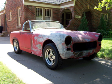

Just got my new Sumitomo HTR 200's in (175/70 R13's on a SWA car), mounted and balanced on the old Rader wheels that I have. Pics coming soon. Started looking around for a reputible body shop to do some body work, prime and shoot the car with a toyota/lexus pearlized white. This weekend the 1275 comes out and I am going to start test fitting a mazda 13b and 5spd tranny.
Progress has been slow....but steady. Need things to cool off a bit again so I can spend some serious time on the car..... too bad my job and studying for the ARE keep getting in the way.

5"
heres an old pic of the wheels with a set of Falken tires

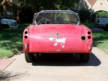

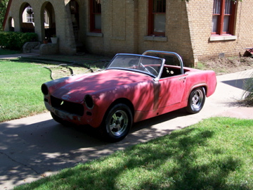

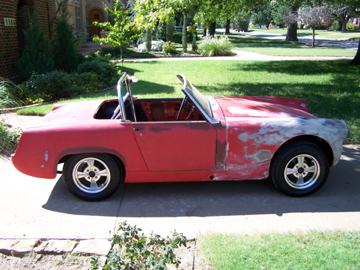

pics as promised

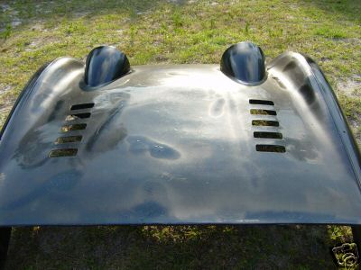

After driving a '60 Bugeye and seeing the reactions it got I had to go to the bugeye bonnet. Going to have some vents cut in it to help evacuate the heat from the rotary engine and will probably go with a forward tilt hinge set up as well.
Thanks!
leecreek
I always thought louver style vents on the bonnett sides behind the front wheels would look good and work good. Never tried it out tho..
I have seen a bugeye with side louver vents. At idle you could definitely feel a steady stream of warm air exiting through the vents.
Branson
Branson
guys,
any pics of the bonnets with the louvered vents on the side?
I was thinking about putting slots on the top of the bonnet inline behind the headlights with a like a fine wire mesh or perforated metal behind.
No pictures, but the guy grafted the louvers into the bonnet from an old welder case. /bcforum/images/%%GRAEMLIN_URL%%/smile.gif
