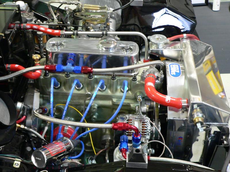

Nice New Radiator w Electric Pusher - Tried to install as Mechanical Fan delete but insufficient clearance, there is a new 6 Bladed fan back there along with a 180 degree thermostat. RevOTec Inline Fan controller located in lower hose automatically turns on Fan at 195 Degrees IIRC. Will install manual override as well. Connected to battery, electric fan will continue to run until temps drop down on shutoff
Engine Right Side - New Coil and 25 D Dizzy from Advanced Distributors

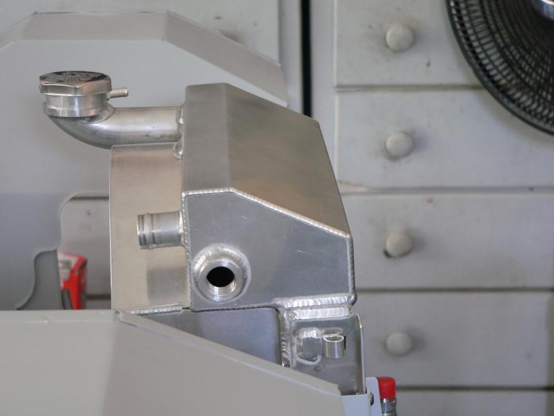

I think that your heater pipe will interfere with your filler neck. Had the same issue with the Griffin. They manufactured the tank 90* to core and that causes the filler neck to be tilted down instead of level. Ended up with a Sereck.

Even the stock radiator is close to the heater pipe there. So, you might have an issue.
Thanks guys, as Bugsy is moving to Tampa May not be an issue but want to make sure I have as an available option. Will take a look. May need to modify heater pipe for clearance with some piece of hard copper pipe with a bend in it to gain some clearance.
