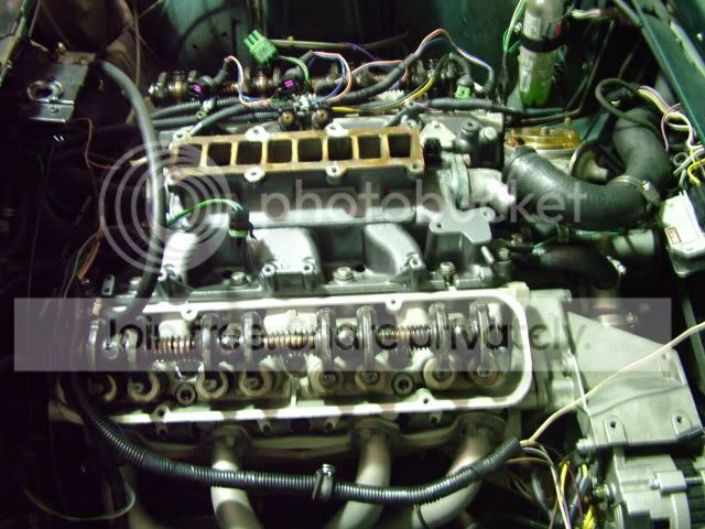

I could have sworn I took a picture just like this a year ago.
O..K.....
So why are you doing it again? The dreaded leak in the rear corners of the intake gasket? Don't ask me how I know about that one.
Don't think mine leaked there, though it was just about 1000 miles of use last season,maybe.
I spent all that time and money to correct what I thought was a bad lifter and found out ,I hope, it's the bottom end.
1 thing though. Can't seem to pull the dizzy out.Does the motor have to be at TDC for some reason ?
I don't think so. I don't know what difference that would make. The distributor housing is round with an o-ring just like a TR6, so nothing special there.

Should I loosen the rockers to relieve tension on the lifters before I pull the heads?
Yep. Then gently remove the pushrods being careful not to drop them down inside the engine. If the whole engine is coming out, remove the radiator assembly, everything on the front of the engine, then the exhaust, heads, remove the cam and lifters, unbolt the starter, clutch slave, and bell housing bolts. Support the tranny and unbolt the engine mounts and pull the short block out the top. What's going back in? 4.0? Keeping the FI?
