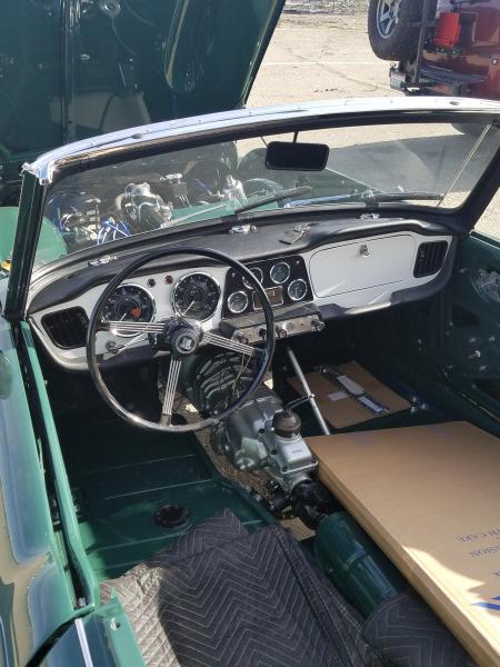

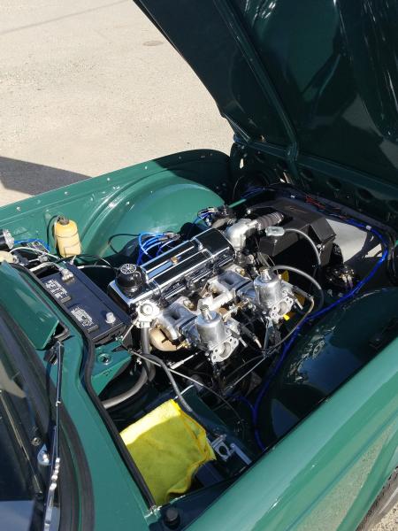

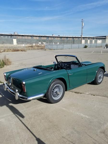

Sooooo....today I started the install of the interior on my TR4. A couple of questions:
1. The kick panel boards...how are those attached? The Moss carpet kit I got has two holes in weird locations.
2. Anyone else used the TRF interior panel hardware kit? I'm having a hard time finding out where all those bolts go and what they are for. I may have to email them and see if they can tell me.
3. Someone replaced the channels the door seals go into and decided to rivet them in. Well...that's great and all, but then you can't slide the seal in. On the passenger side it was only a VERY small piece so I JB Welded it. But the drivers side is a majority of the bottom area. Any reason I can't JB Weld a larger piece. Why I didn't catch that OR WHY the shop that did my body work didn't catch that.
4. Where are all the snaps supposed to go for the carpet. Moss gave me a TON, but I can only see 6. Two on each pass and dr floor and two on the tunnel. Guess they gave me like 15 extra?
5. And to confirm...and I know this...but the rear leaf that has the extra plate goes on the drivers side, correct? I know this and for some reason I STILL put it on the passenger side. It's there so when you sit in the car it's level. Luckily it seems the leafs are easy to swap.
Sorry for the long winded post. Here are some pics from yesterday and today. And yes, know the wipers are wrong. Working on getting them corrected.

1. Mine are secured by screws and of course the dipper switch base.
2. Not sure what bolts you refer to.
3. I suppose there is no harm in gluing in the cannel seal but JBWeld may not be the best choice as it sets up rather brittle. Maybe Gorilla Glue (what I used on the boot seal) would be better.
4. I will dig out some pictures of snap locations, though you may still have some left over (I do not recall 21 of them being needed).
5. Extra leaf is for the passenger side so you are okay. It is counter-intuitive but because the frame is under=slung adding that leaf raises the axle relative to the body so the net effect is to lower the body.
I used the TRF carpet kit and later had to replace it with the Moss kit - so I have two memories though I do not recall much comflict re attachment.
1. Mine are secured by screws and of course the dipper switch base. Yeah, there are two diagonal holes on the back side but they don't seem to go to anything on the sheetmetal, so I'm kind of confused
2. Not sure what bolts you refer to. Well, kind of all of them that came with the kit. There are some weird plastic washers that these tiny screws go into. Then about 16 cup washers and screws. Those look to go back to the rear board in front of the gas tank. But I saw in someones post two snaps go there too. Those weren't included in the kit which is weird.
3. I suppose there is no harm in gluing in the cannel seal but JBWeld may not be the best choice as it sets up rather brittle. Maybe Gorilla Glue (what I used on the boot seal) would be better. OK. I'll try a couple of different things. I was thinking since it's metal on metal it would be better for JB Weld.
4. I will dig out some pictures of snap locations, though you may still have some left over (I do not recall 21 of them being needed). Thank you!

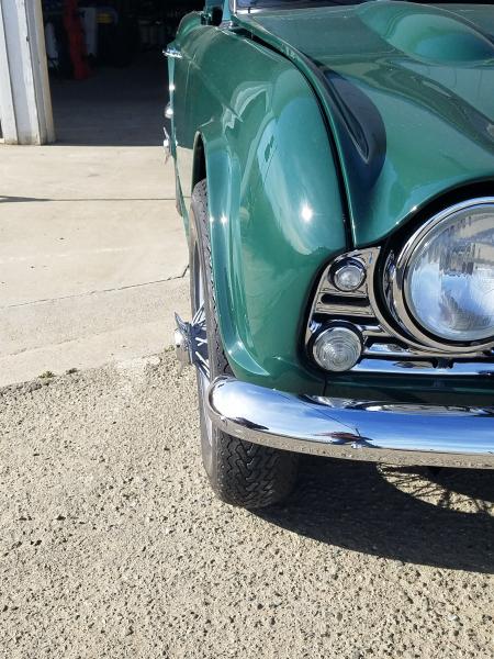

5. Extra leaf is for the passenger side so you are okay. It is counter-intuitive but because the frame is under=slung adding that leaf raises the axle relative to the body so the net effect is to lower the body. OK...so I do have it right then? So maybe someone or you can chime in as to why my front passenger wheel is 1/2-3/4 higher and the camber seems way off? I measured at the little groove in the tower to the bottom of the aluminum spacer and both were the same. So all I could think of is I put the rear leaf incorrectly causing it to be higher on that side which in turn caused the front to be higher. But then I would have the same issue on the drivers side if I swapped them out. Not sure what else could cause it. See pic.
See the two pictures attached. You can see the difference and the camber is out of whack.

Hard to judge camber in those photos but I wonder -- did someone fit spacers to the hubs to adapt steel-wheel studs to use with wires? Okay to do that (I do) it just looked like there might be an extra bit of track.
No spacers or anything was added. I rebuilt the whole suspension and the rubber spacers are seated as I had a heck of a time trying to get them to seat correctly. And the spacer makes sense. I'm so used to lifting trucks that a spacer "lift" lifts the truck. But I get what you're saying above. But just can't see why it's this way. Front springs different sizes? I swear I measured them and they were the same. Hmmmm, when I put it back up on jack stands I'll have to measure some things and compare.
