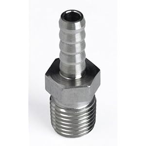

Oh, I think I see where you're headed. You want to just put a plug in the
5/8 UNF hole for the Servo instead of the banjo outfit, and put an NPT threaded hose barb in the NPT hole for the Servo Vacuum.
Yeah, that would work; the vacuum is the same; it's the same everywhere in the manifold.
I believe you could find the threaded hose barb at Lowes, etc, in the plumbing section and just any 5/8 UNF bolt (as long as it's not too long) to plug that other hole and Bob's...well, you know who Bob is..

Trying to locate fitting
1/2"NPT to 3/8ths or better yet 5/16 hose
You'll probably have to stack two of them to get that combination, Don. Try looking for a 1/2" to 1/4" NPT bushing, plus a 1/4" NPT to 5/16" hose barb adapter. Should be able to find those at your local hardware store (my Home Depot has them).
If not, you can order them from MMC
https://www.mcmaster.com/#barbed-hose-fittings/=ch50c3
I see one at MMC for 3/8 hose. Actually they have 6 depending on what they're made of, but a SS one is part #5361K38.

My Lowes and HD didn't have 1/2 NPT to hose at all.
My local Screw store had 1/2 hose but that's way to big.
My napa is out at the moment and he didn't know what size the hose barb was
Randall, that's in the back of my mind but would rather find a single first. If I do have to go 5/16 hose then I will need to do that,cause I don't think the 1/2 NPT to 5/16 hose is a doer.
I did look at Mc M first, must have missed them
If this is for the manifold vacuum as I suspect it is, even though you say you want to keep this particular project some kind of a secret and if the ID of the hose is 5/16 but the OD of the barb is 3/8, you'll be fine with a hose clamp. If for some reason you end up with a vacuum leak, just wrap the barb with tape or coat it with silicone sealer before you slip the hose on the barb nipple. There's not going to be an awful lot of Vacuum. It might be different if it were a constant pressure trying to leak out of the fitting, but a vaccum if anything will be trying to make the union tighter..as opposed to pressure which would be trying to expand the hose around the nipple.
