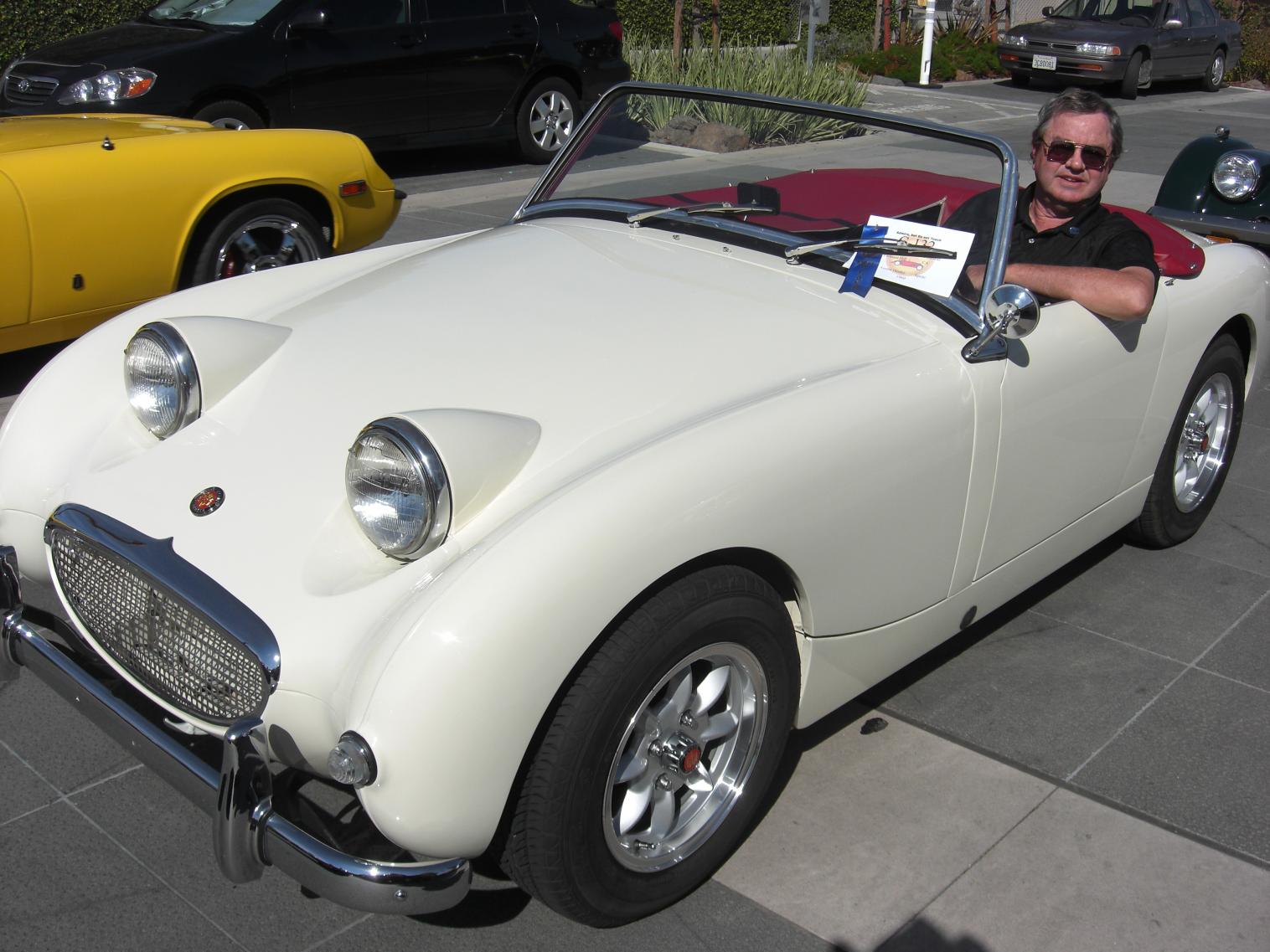

I think I tried 3 vendors for the bonnet seal on my BE, all too thick. I ended up making a jig, and cutting one down. It takes real patience to fit a bonnet on a BE, but it can be done, right Bill? CIMG0451.jpg

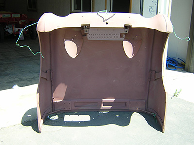

If you use the locking rod as a pivot, the splash pan will hit the frame legs when the is only about 3/4 open. Even if you prop it open that way, you will have very limited access to the engine bay and working in there will be very cumbersome. It really defeats the entire purpose of reversing the hinge. The alternative is to notch the splash pan to clear the frame legs. Not a worthwhile pursuit in my opinion considering the easy and inexpensive (and reversible) alternatives. (yes, I mean my hinge kit) I did this on my first Bugeye back in the 60's and was never happy with the results.

you ou just solved a mystery of why the bonnet for Bugsy I that I got from a friend was bitched that way. So us it possible to use your hinge kit and still use the locking rods. I don't think there is room and back of bonnet would but be very well secured.
Gerard,
You mean to relocate the locking mechanism to the other end? You probably could, but unless you could figure out a way to rig true handle from under the dash, you'd have it sticking out of the top of the bonnet.

You could use a later bonnet latch at the back actuated by a cable. That's been done before.

Other than Spitfire latches, the best method I have seen for locking a front hinge bonnet was using spring bolts from inside the footwells on each side. The bolts are mounted inside threw the footwell panel on each side and connect to a receiver welded onto the lower portion of the rear bonnet. A little bit of a pain to unlatch as both sides must be unlatched. Nothing shows from outside.
