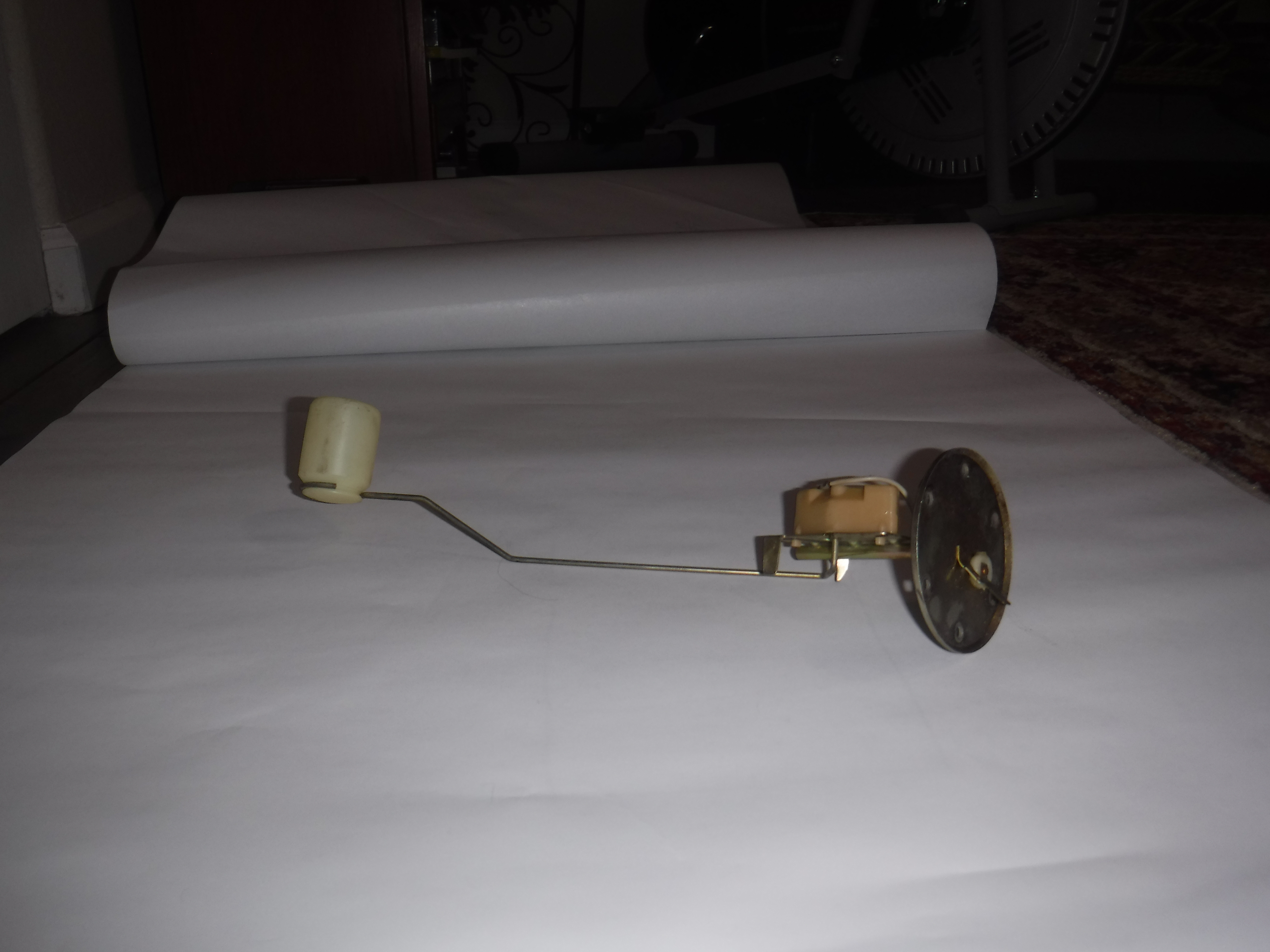

They all look something like this

Was it working and then stopped abruptly? Did it ever work for you?. Check the wiring at the back of the gage and at the sender on top of the tank first. It's easy and you don't get fuel on you. Pulling the sender out is easy enough but be prepared to have a new gasket as you may destroy the old one. As pointed out above, if your float has become full of fuel or is somehow compromised the fix is a new float or sender unit. Before you remove it you might consider adding an extra ground wire, even if it is temporary it would eliminate a bad ground ( earth) at the fuel sender. Just pick a screw on the sender and run a wire to a good clean ground on the frame nearby.
John Turney
Does your heater blower motor work? If so, you are getting power to the fuel gauge. If not, you may not be getting power to the gauge. A green wire goes from the 35-amp fuse to the gauge, and from the gauge to the blower motor switch.
As mentioned by Roscoe, a bad ground at the sender is also common, especially if the fuel line from the tank to the fuel pump has been modified - run a ground wire as suggested.
And very easy to replace. There is one YouTube out there that illustrates install. Search “fuel sender replacement on Austin Healey”. Also…very important to install a simple extra ground wire from one of the 6 screws on the fuel sender. I ran mine to the screw on the spare tire fastener. If I can fix this, anyone can
