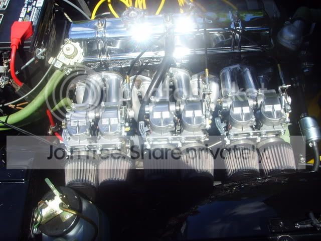

Anyone out there running Mikunis or Keihins? Or anyone have any pictures from shows of cars with the Mikunis or Keihins? I considered these carbs and selected the triple ZS 175s because of installation history. Now I am reconsidering. They are marketed to be a far simpler and more HP power producing carb. I would like more info.
You mean these??
DNK:
Is this the PRI Keihin Six Pack Kit? When did you do this install? How does it perform? What is your motor composition? Have you any performance data comparing this install vs. anything else? Please tell me as much about it as you can.

Trick6 said:
DNK:
Al sorry it took so long to answer. I have been kind of pecking at the post and only looking at the ones that really peeked my interest.
That is not my car. It is what you said. It was at the Bellevue WA show in 07.
I think it is beautiful. Almost Italian looking.
