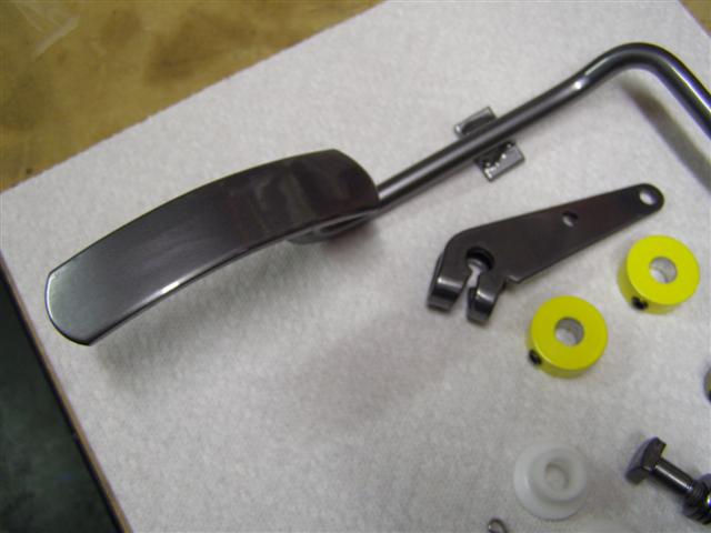

I've been having a little fun lately in my engine compartment. It started a while ago with a freshly rebuilt and re curved distributor from Jeff. Then I started accumulating other parts, the Ratco throttle cable, a Macy's Garage bonnet release, one of the first ARE (Joe Alexander) heat shields for triple ZS175's and finally fully rebuilding my 3 ZS's. I didn't go the micro-polishing route, call me a rebel if you must, but I was inspired by an Aston Martin DB2/4 I was working on a few months ago. Also, opposite of the growing trend with BCFers, I like to slightly "de-bling" the upgrades under my bonnet. Not that there is anything inherently wrong with bright colors under the bonnet, its just not for me. I also used some tips and tricks that are being used more and more in some of the hot-rod/muscle car circles. So here is the finished result.
Paul's tips with the Ratco cable used with triple ZS's was very handy. :thumbsup: :thankyousign: The Macy's Garage emergency release works extremely well. The underside of the heat-shield is painted with a high heat ceramic white paint and the carburettors are painted with a high heat ceramic black paint. The last two items are part of a growing trend in high performance V8 circles. The white has tested very well at reflecting heat while the black has tested very well at expelling heat.
The Aston Martin DB2/4 I was referring to also had a black painted manifold and black carburettors. This particular DB2/4 was outfitted by the factory, as a special order car, for rallying on the continent. It has history with the Monte Carlo, Tulip, Alpine and several other rallye's. It also has factory documentation of the changes made for competition, including the black manifold and carburettors. I liked the idea of black carburettors but couldn't go completely black with the manifold and the air box.
What I can say so far is; the rebuilt/re-curved distributor, coupled with the fully rebuilt carburettors have made a wonderful driving difference. I didn't think my carbs were in that bad of shape until after trying the newly rebuilt ones. The Ratco cable made throttle modulation very smooth. The heat shield works well too as the carbs are much happier about heat issues.
While I had everything off I intended to wrap the headers in sleeves. These are not the tight fitting header wrap though they are made of a similar material. The sleeves wouldn't cover enough of the header pipes to make it worthwhile because there is not enough clearance. So I 86'ed the header sleeves and figured I'd make do for now with a heat shield for the starter and the heat shield for the carbs. So far, its working out just fine.

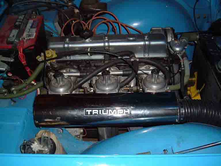

For those that might remember, a few weeks ago I mentioned something that might cause a stir with some BCFers. This is it.

Anti-bling.
Are you going to powdercoat the airbox and intake manifolds black too? That would look cool.
Close, but black chrome is even better!
alana said:
Anti-bling.
I thought about blacking it all out. Still might but for now I like the alternating black then polished look.
No bling means all business. :smile: And easier upkeep. :wink:

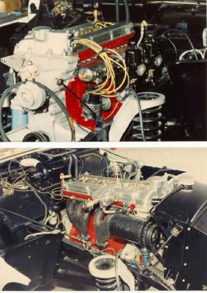

A few years back I had the "pleasure" of redoing a 2/4 drophead. It came to us in buckets and tubs of parts. Apologies for the poor pix, they were from a point-and-shoot. Progress pix.
