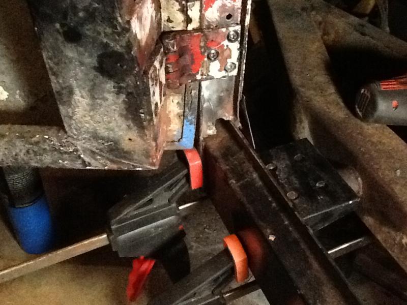

image.jpg"A" to the sill

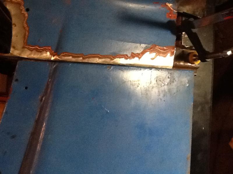

image.jpg "B" to the sill height from sill to "B" post is approx 3/4" and from sill to the outer edge is 1.25", but to me it looks like it need to move in farther so the "B" sits on the top of the sill.

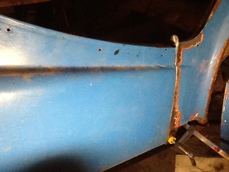

image.jpgThe door line looks ok, but I do need new hinges as they are worn out.
image.jpg Door gap is tight at the bottom but seems to look ok for the top, which believes me that I need to lift the back of the car to correct this.
The bottom part of the "B" post flanges are tight on the sill currently but I am more worried about the gap/hole at the corner of the "B" post to the sill. Is this correct? I don't have outer sills yet so I can't trial fit the, to see if that goes away/covers up.

Ok so with pulling the bottom of the "B" post aft with some clamps, I got the door gaps looking good. The door opens reasonable ok, need some adjustments. I'm thinking that the post are now in the correct locations, just the hole/gap at the bottom of the post is the last thing I worried about.

It sounds like you are getting closer. I am unable to understand what the "gap" is that you are referring to. The B post should lie alongside the sill and the flanges on each side would be welded to the sill. The bottom of the B post is open. Picture 2 of the sill and B post looks about correct.

I did not realize that the bottom of the "B" post was open like that, when I was removing the old sill it looked like it was sitting on the sill completely. Thanks for the answers
