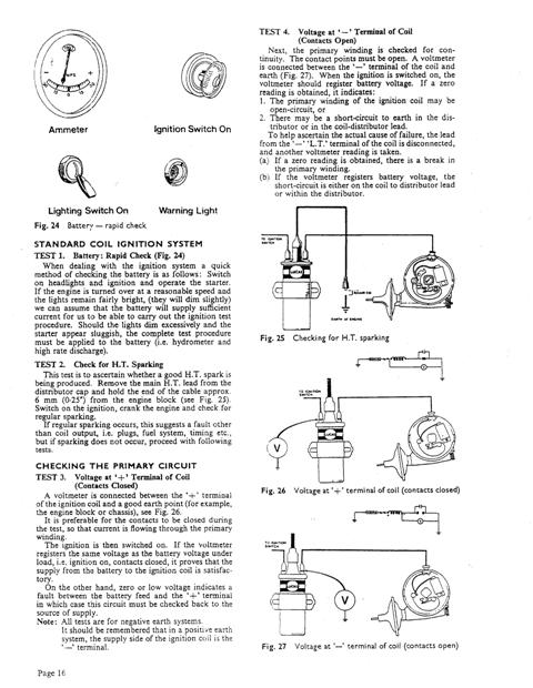

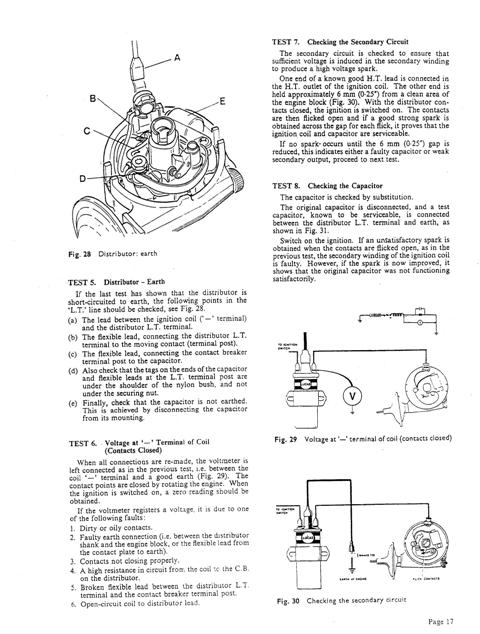

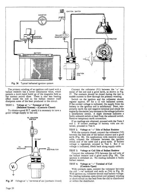

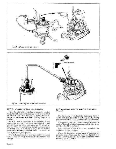

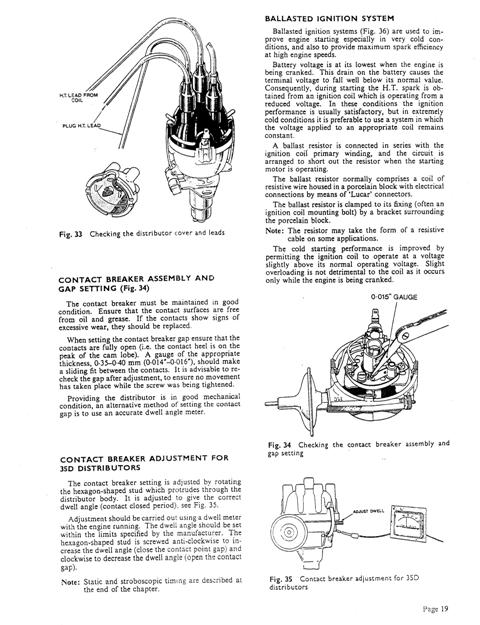

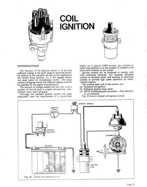

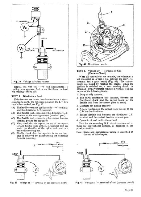

Eric: If this is the original ignition set up, underneath the distributor cap are a set of points, a condenser (capacitor) and a rotor. Do you have a simple electrical multimeter or a test light? If you do you can test for voltage at the points when you switch on the ignition. In fact you can simulate the operation of the points by opening and closing them manually. If you have voltage and you open and close the points you should produce high voltage and hopefully a spark. If not you may have a bad condenser. Change out the condenser and try it. if you still get no spark, you may have a bad coil. There are really no other reasons for no spark.
If you have an electronic ignition, follow the manufacturer's directions for troubleshooting.
Here are some guidelines from Lucas.
Good luck.

OK here's the scoop .As I suspected from the start it was a timing issue. I guess since I had never dealt with it before I was apprehensive to change it. No spark, not because of an dizzy issue but not timed = no spark. I looked at a few different timing approaches, none of them seemed to do the trick. So with the help of a buddy did the old you crank it and I'll turn it (the dizzy) and she fires right up. Turn it back and forth a little till it sounds good and tighten it down. She's running great! Thanks for all the help, any knowledge is worth having.
