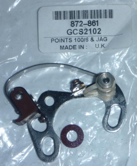

Has anyone else experienced the problem of replacement points for a DM6 distributor not being able to close enough to achieve the required point gap?

The issue is, and could only be, with the base plate. That is why I posted, to see if anyone else has experienced this problem.
The part number on the packaging was correct based on the Victoria British catalog.

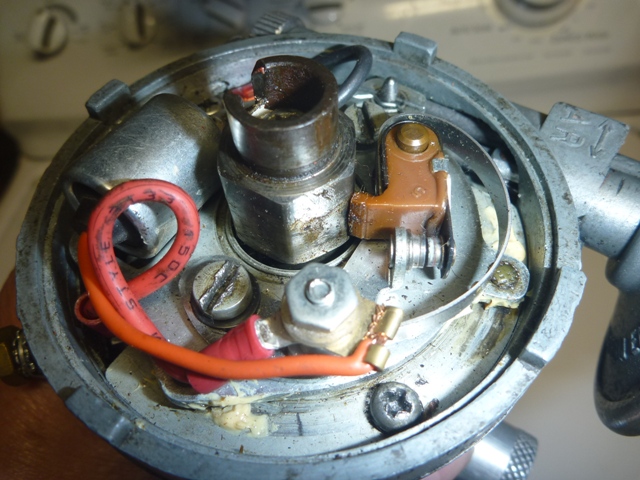

What it should look like:

It’s the bottom plate that comes with a new set of points.
The elongated hole for one of the mounting screws is too short to allow the points to close enough. If this hole was longer, the inner part of the plate would rub on the distributor shaft. Also, the hole for the adjustment screw is not large enough to adjust the points to the required gap.
Drill or enlarge it by filing TOO.--:highly_amused:
