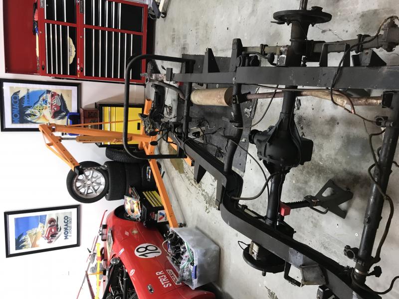

Hey guys, I’m looking for some ideas to help keep hardware organized for plating. I currently have my TD just about completely disassembled (the project started with the intention of fixing a sticking right front brake...don’t ask), and should hopefully have the frame repainted by the end of this weekend. Soon I will need to get an entire car’s worth of nuts, bolts, and various fittings zinc plated. Right now they are all carefully organized and labeled in sandwich bags, but I know at the platers they will all get thrown into one large batch.
What tricks and ideas have others used to help organize the parts during or after plating? I’ve thought about taking photos of the contents of each separate bag next to its label, but any other ideas from those who have been down this road?
