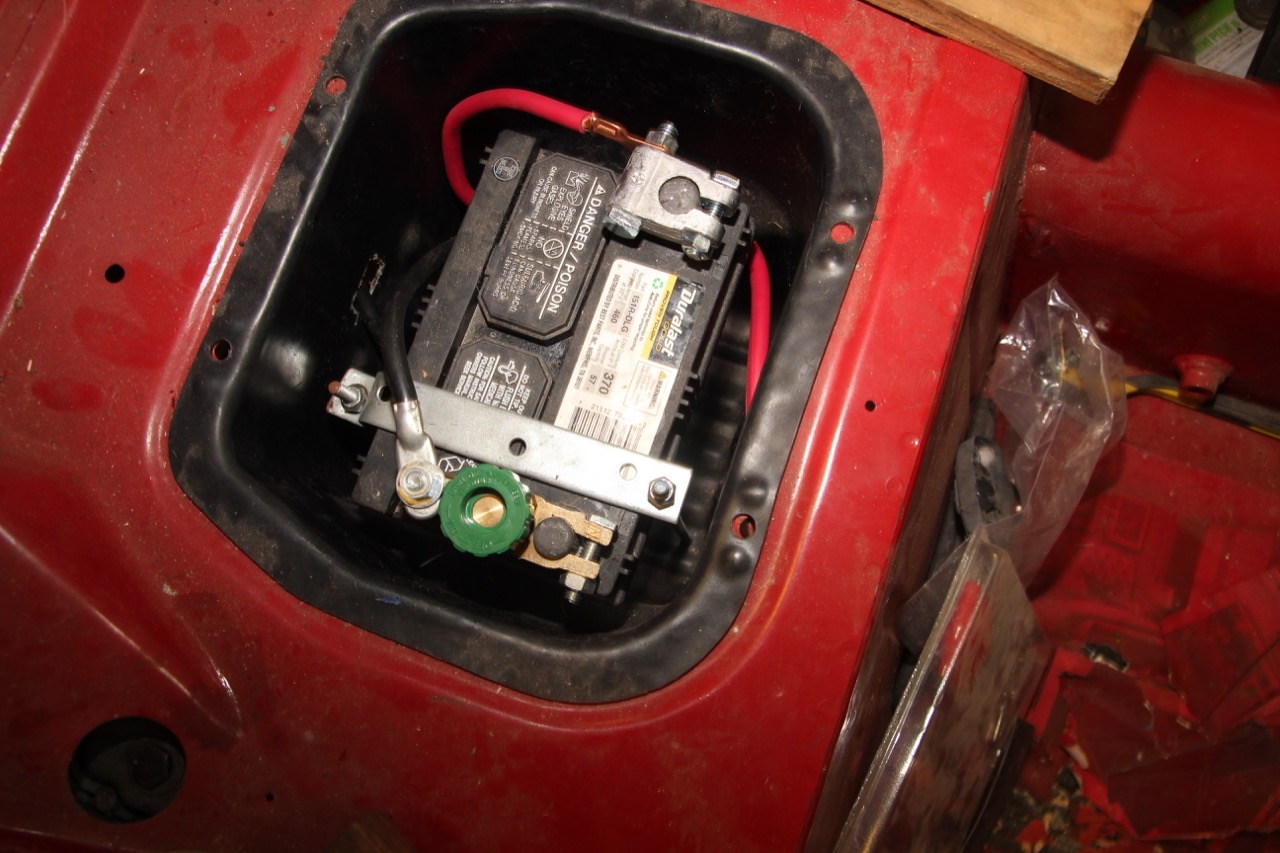

Apologies for the fact that it took me a while to get back to you on this, but this is the battery setup I am using:
It is hard to read on the reduced size image I can put here, but the part # is 151R-DLG, 370 crank amps at 0F, 460 crank amps at 32F, reserve capacity 57. It has plenty of power to spin the engine over just fine.

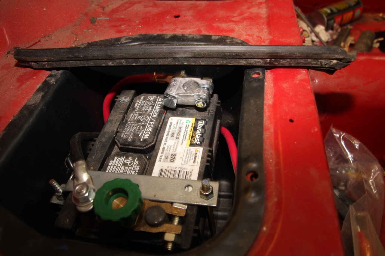

This shows a sort-of-straight piece of plastic across the well opening to give a reference to how much clearance there is above the + terminal. I used a + terminal with a side-attach bolt for the cable ring, a top-stud marine style terminal would work but gets really close to the cover. I did have to custom make the battery cable since in this configuration it needed to be longer than a stock one. Not worried about the - side since it just connects to ground anyway.

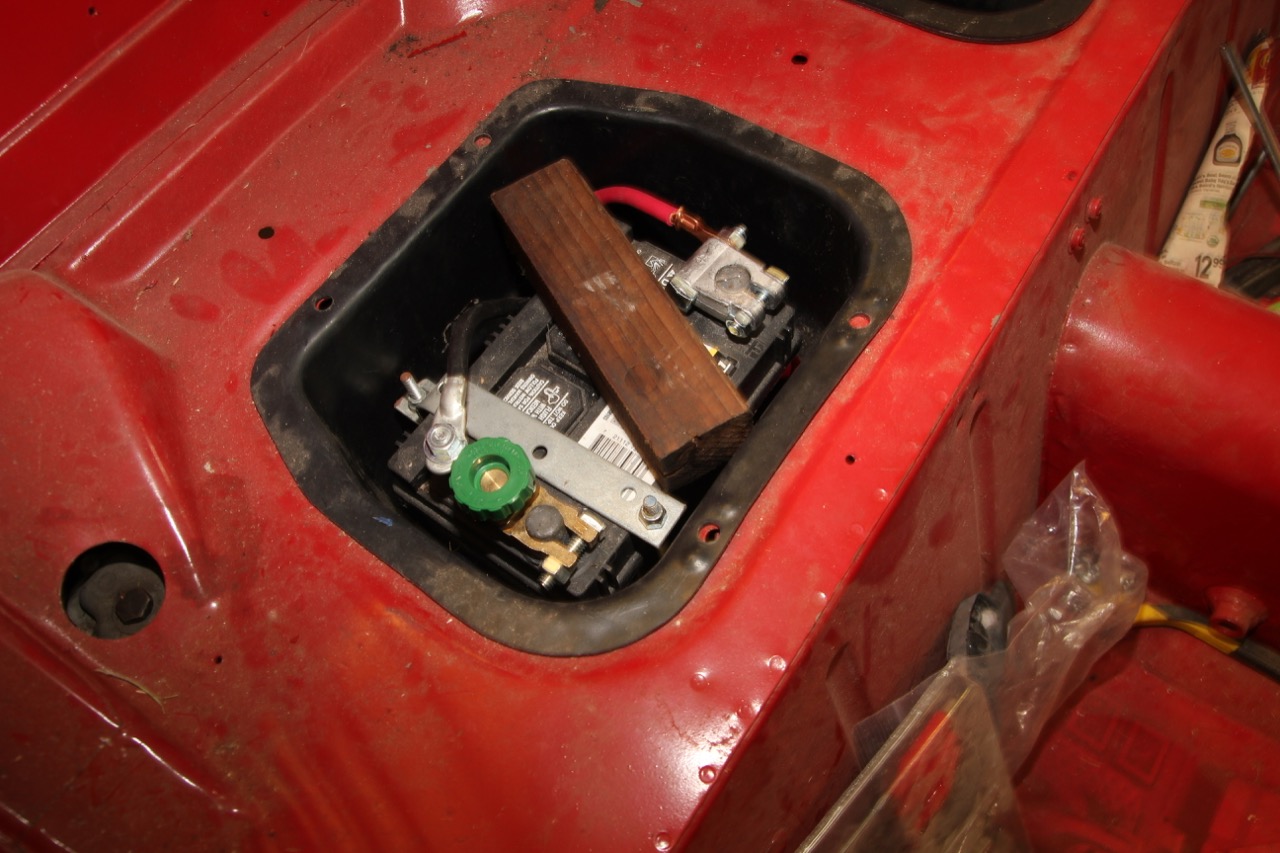

The 2x2 block sits almost perfectly flush with the top of the well - I'll probably leave it in there just to keep anything from deforming the metal cover down enough to contact the + terminal (when I was trying a marine type terminal it was essential). It is probably not needed with the side-attach terminals (which you can get at WalMart - less than $8.00). If your car is still set up as positive ground you'll need to reorient the terminal accordingly.
