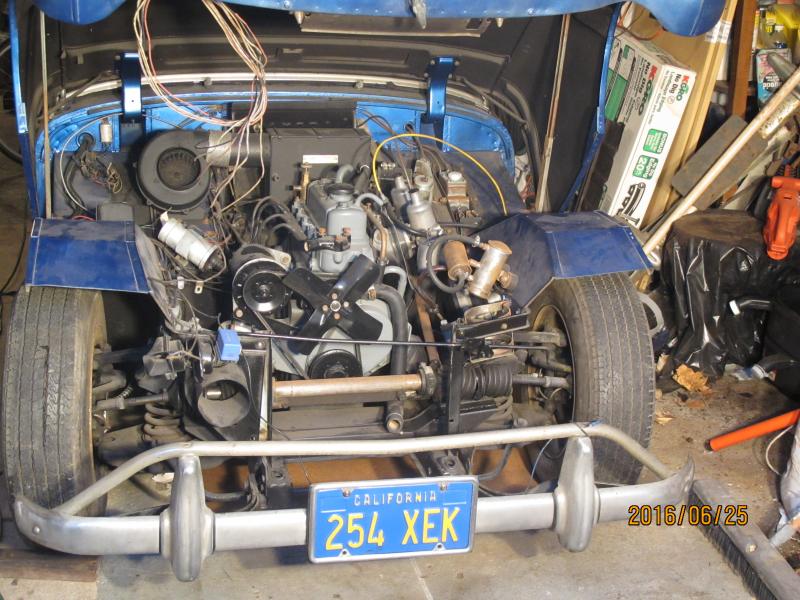

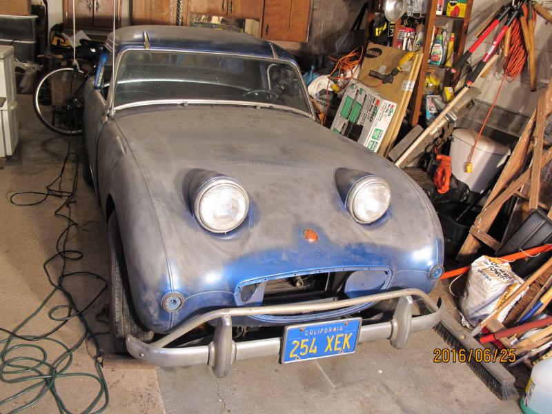

Bugsy IV – What I know 6 25 16
1. A ½ Ton Crew Cab Chevy truck towing a 25’ Trailer consumed 55 gallons of fuel today during a 450 Mile Road Trip to Cleveland and Back, Thanks Tim Bossee for the loan of the truck and the trailer and for Driving.
2. Bugsy II is as advertised a Rust Free BE a true Unicorn
3. Someone started a restoration on this car. Dash has been out, all of the wiring is not connected behind the dash and lots under the hood. This is going to take a while to resolve. Wiring is cracked and fabric
harness is very faded, I think this will need a full replacement. It will take as long to figure out the existing harness as to go all new.
4. Engine is supposedly “rebuilt” well as least it has a new coat of grey paint on it No clue why grey why not Green. Need to look at Horler. There is oil in the engine but dirty and dark.
5. Dash need all new gauge knobs and recovered in Red Vinyl. Unknown what the real mileage in on this car. Speedo shows 62k.
6. Engine Combo Gauge was cut at Temp Sensor Bulb, that will need replacement
7. Oil Pressure side may be ok, Unknown yet.

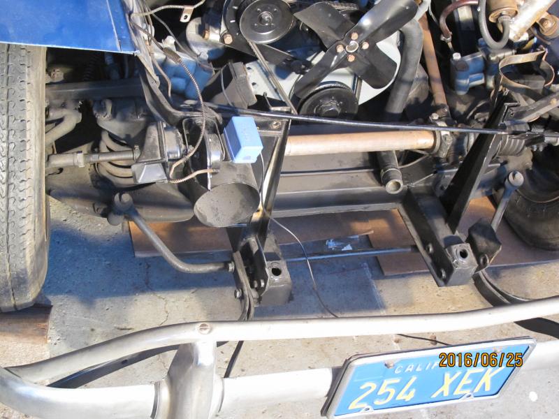

8. Mechanical Fuel Pump Blocked off and some weird Electric Fuel Pump is at front of Engine. That will need to go to RR Panels Mount
9. Generator and Tach Drive is there.
10. Lot’s of work will be needed under hood worting out wiring
11. E-Brank Handle trashed I have a good spare. DO not believe E-Brake Cable was connected.
12. Supposed to be a Rib Case with a new Clutch Installed
13. I now own 3 Downflow radiators, Unknown if any are good. Will need to pressure Test, Plan is to add Electric 10” fan as a pusher
14. Master Cylinder is supposed to be new, same for Brake Master, no fluid in either one. Not sure why.
15. Will need to examine Brake lines in detail. I have a kit of lines but if I can avoid replacing = time vs. safety

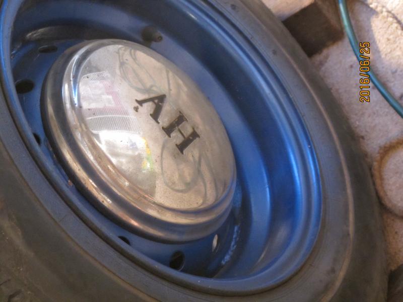

16. Wheels are interesting. Stock BE Rims have been widened to accommodate a 175 x 70 tire. Deep Dish look really trick. Someone may be interested in these.
17. BMC Factory Radio Installed. Told these are valuable, Wil not be using, May need to get a new uncut dash from AH Spares. Lots of extra holes cut included a an extra switch and Map Reading Lamp
18. Bonnet very straight and so is boot. Seams incredibly good. No cracking really nice.
19. Sway bar is installed but appears to be unstalled upside down. I have a sway bar to replace.
20. Oh and I forgot to mention the big score , cost me $150. Set of Rear Levers Shocks with Mounting baseplate to replace the Tube shocks. A major score that I could not pass up.
21. I picked up all of the jewelry including new front and rear Turn Lenses, Complete Stop Lamps including gaskets and bulbs, wiper bezels, and new chrome top Clips that go on boot deck. Brand new.
Not cheap he wasn’t giving anything away.
22. Hardtop is in good shape will need seals along with extra wing nut and bolt. A PITAS to store in my 1 car garage. Need to find a place for it. With only a 7’ Ceiling in there suspending above is not an option.
Needs painted inside and out. Going to be Red as contrast to OEW Car.
23. No Top or Tonneau came with car. I have a new Black To[ and Tonneau never installed that will work for now. Eventually Red Tonneau and Red Stayfast Top. Top Bar he had two that I passed on
$150 was too much and the one I have is as good as he was offering.
24. Hole for top mounting screw for rear over rider has been filled in. Not sure why but will need to drill out before painting.
25. Need new boots on steering rack. They will be replaced when I add Disc Brakes and Backing Plates and check out the rest of the Front End. I mentioned the Sway bar being wrong but it may be
period correct for 1960.
26. Discovery is underway, Need to lay out a plan of action

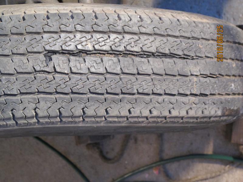

27. The only way this car will get to British Car Days in Dayton on August 6 will be on a trailer and entered in the Diamond in the Rough Category.
28. Tired and time for Bed, Been a Long Day. More Pics when I have better light.

Hey what about those wheels, a real So. Cal look.
